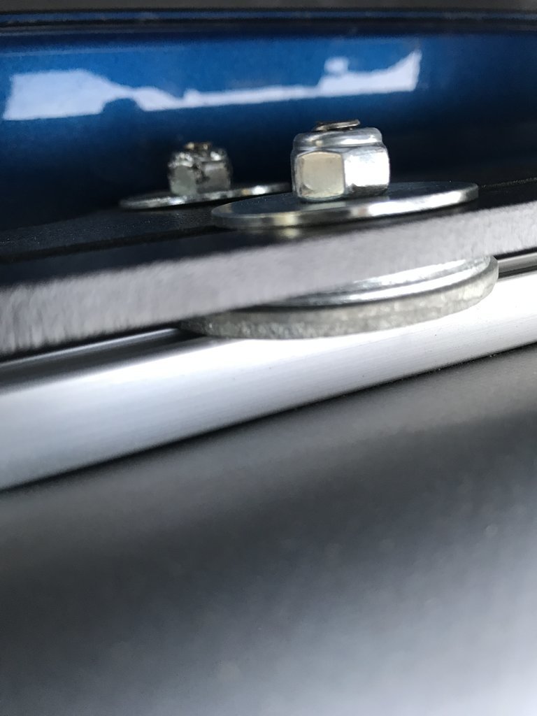

    does yours hit the door? my arb awning seems to sit a little low and just barely rubs on the door when you open and close.
    I made these spacers to clear the bolt heads.

    It sits just above the door, if it was 1/4" lower or more it would deffinetly rub. The other way to install the awning is with the L brackets upwards, in the t slots, will cause the awning to be about 5" higher and may look weird. You can also use spacers and hang the brackets over the edge of the side rails facing down and bolted into the t slots. This will raise it approx 1".

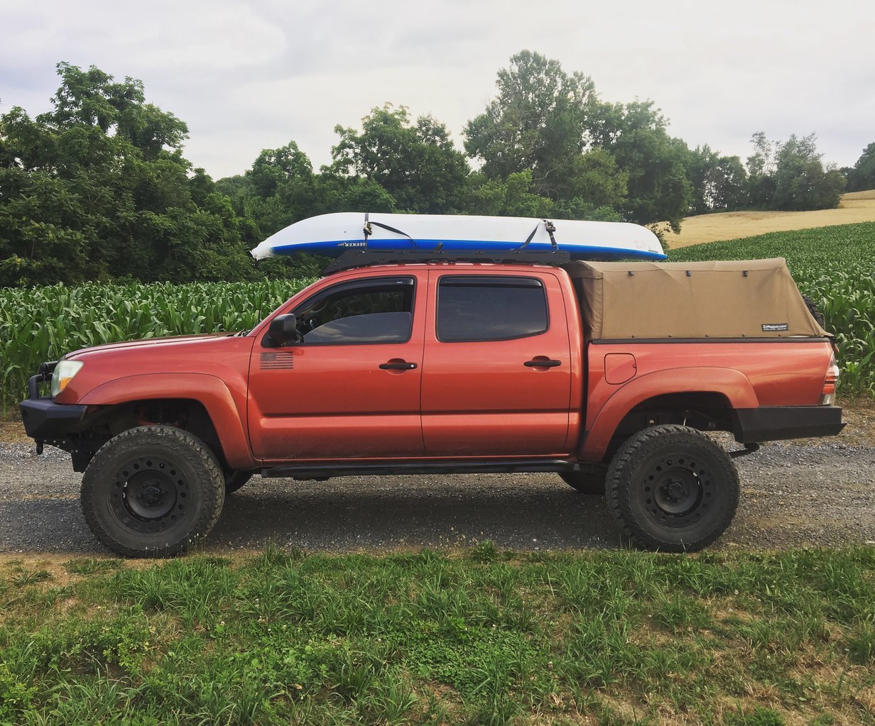

    Prinsu already in use before my kayak holders come in lol

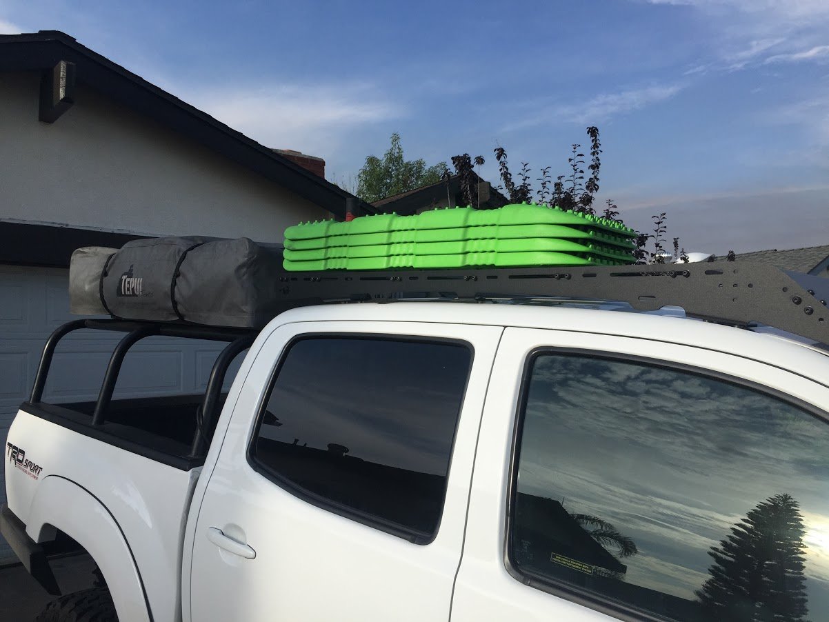

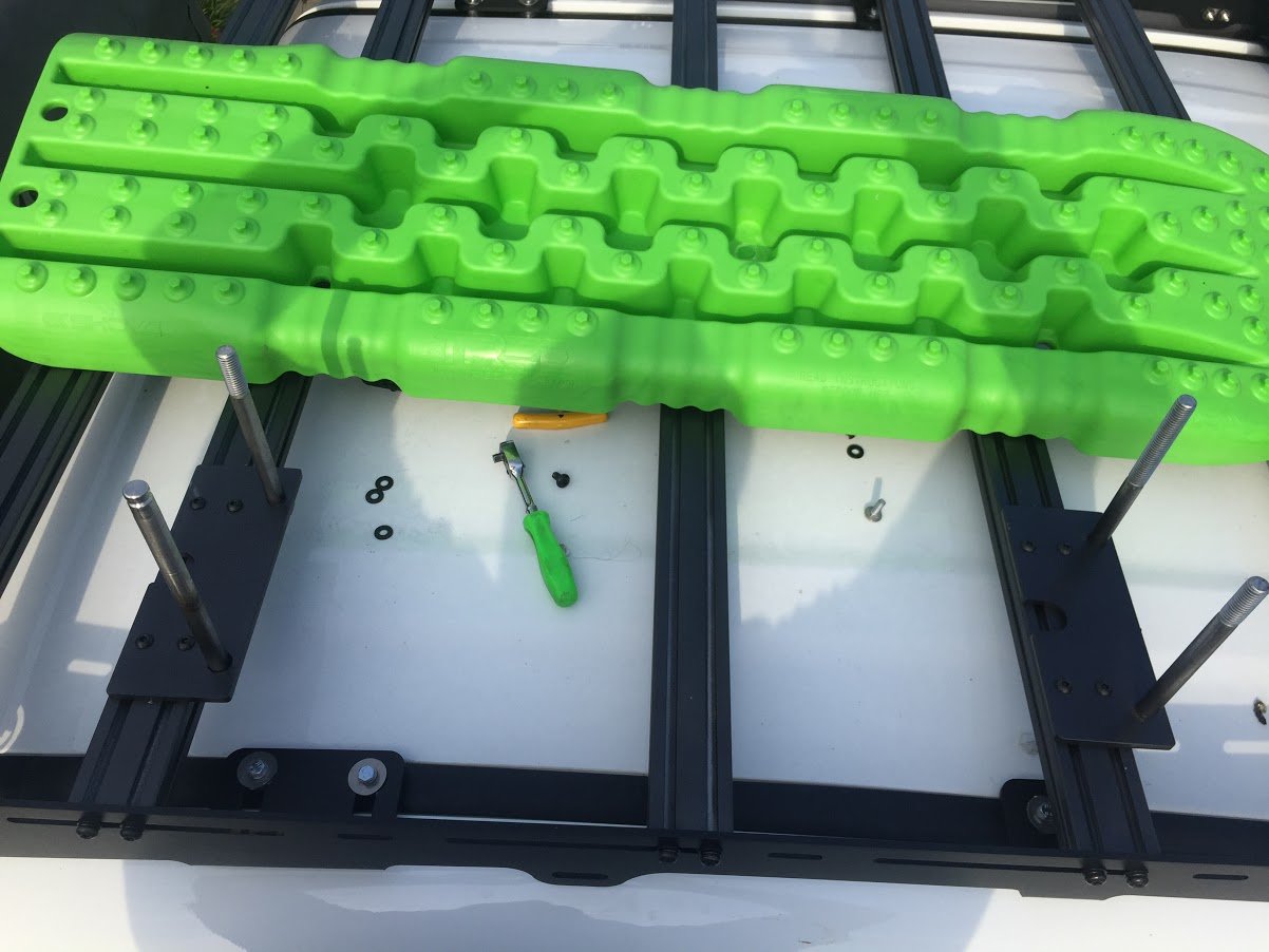

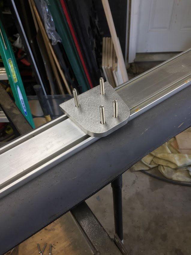

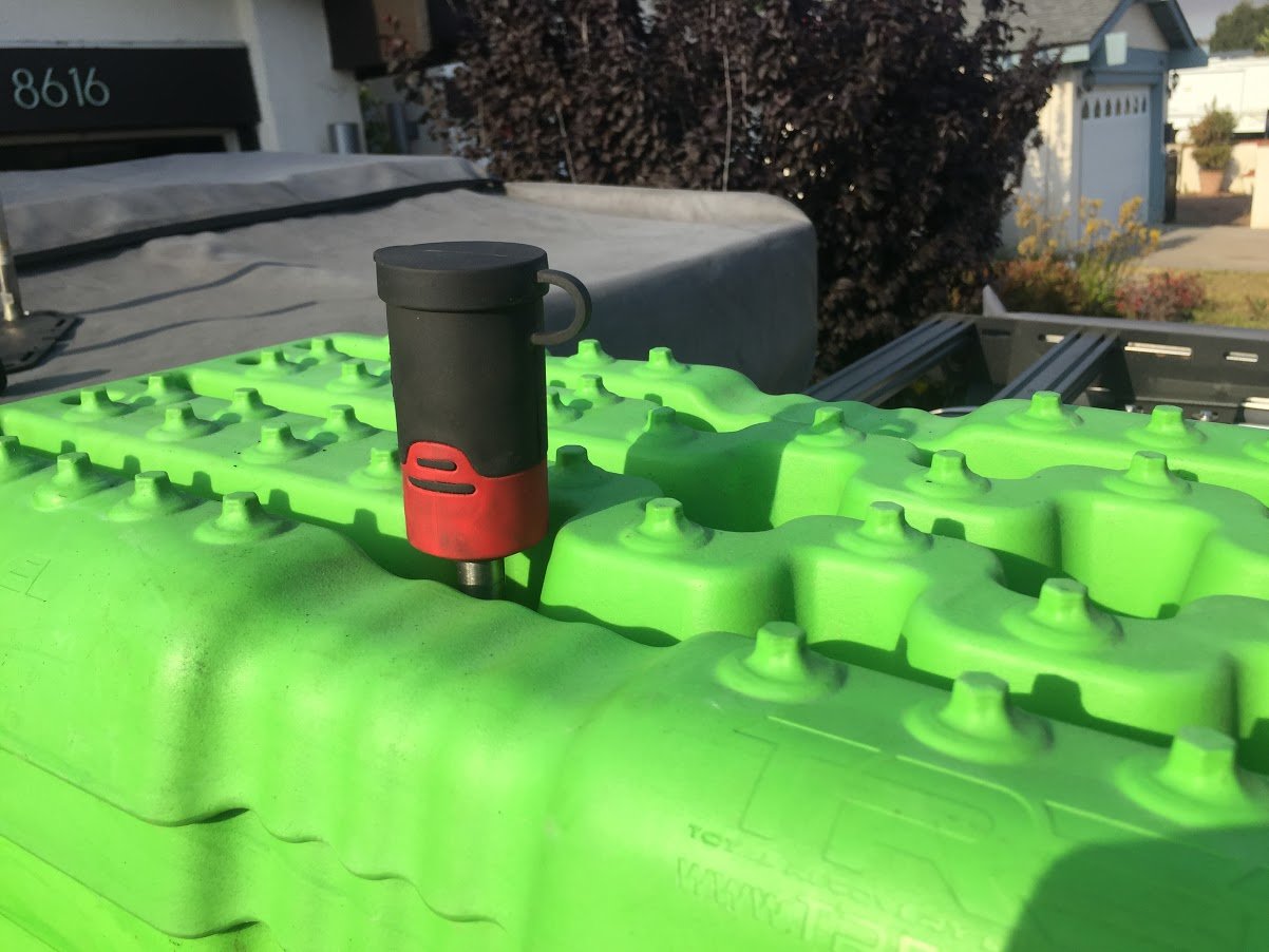

    made up some custom TRED holders. I didnt like how the factory ones wouldnt hold 4 so made these, also added in a BOLT locks (uses factory key)

    Great idea. Love the Bolt locks.
