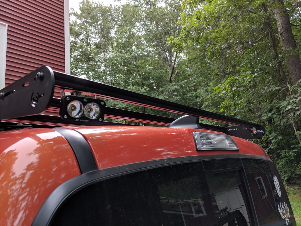

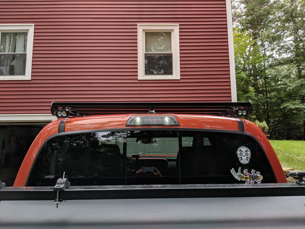

    Installed some baja designs s2 sports under the rear most crossbar. Very happy with how much it lights everything up.

    San Diego, CA
    2007 Silver Double Cab Tacoma TRD Sport
    How did you wire that up? I have the same kinda setup but with my toprac on my shell and I wired everything up and its not working. I feel like its something to do with cutting the wiring harness to add the extra length of wire.
