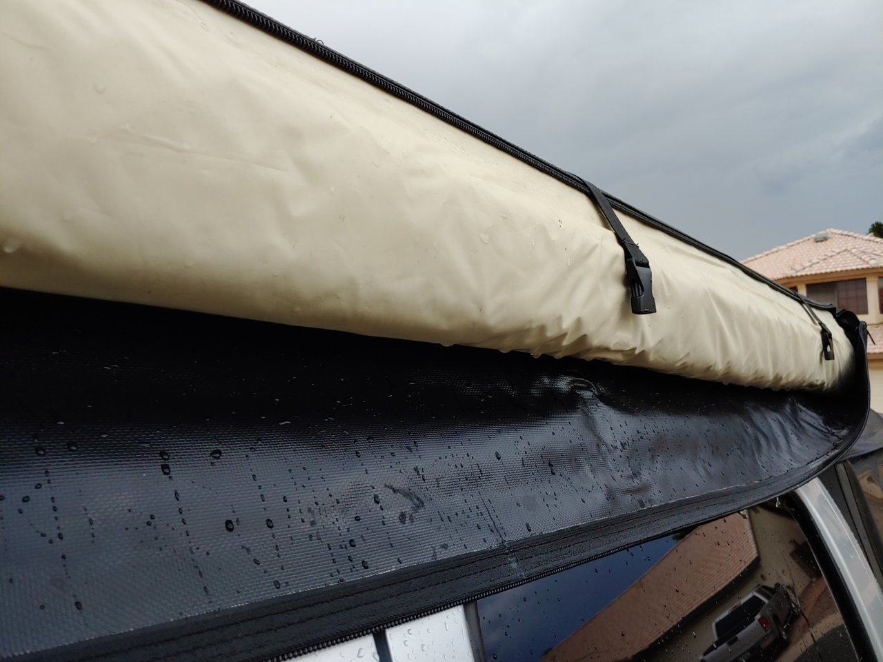

    Just a brief update to this thread...
    I got the Yescom awning a while back and for yhe money, it's performed really nicely.
    However, we got hit by our first real severe monsoon earlier this week. I knew about the fix to flip the awning so the zipper would be on the bottom, but...
    ...I procrastinated and never did. :anonymous: Oops.
    Shit totally filled with water and I had to take it off and open it up in my garage balanced on a couple ladders with a fan to dry it out so I wouldn't get any mold/mildew.
    So to anyone who gets the Yescom awning, so yourself a favore and do @eyehate 's fix BEFORE you get too excited about your new awning and mount it up on your rack.

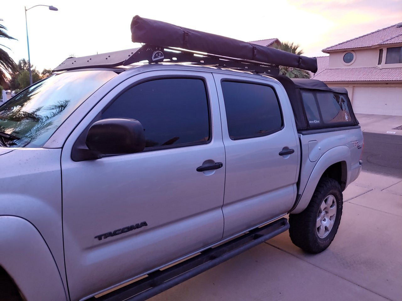

    FWIW, I took off one endcap and it was super easy to flip. Embarassed I didn't do that initially.
    Aftermath of storm
    Fixed last night after drying out/flipping so zipper is on bottom
