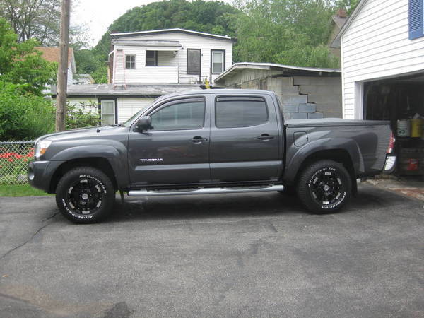

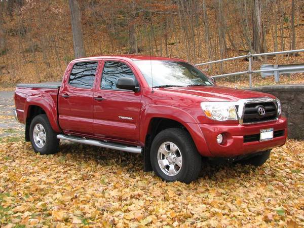

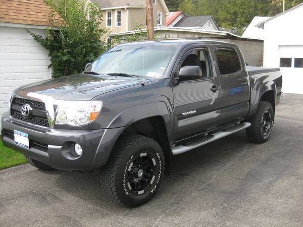

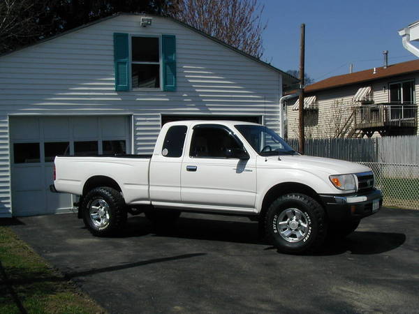

    Three of my Toyota Trucks
    2000 Tacoma
    2006 Tacoma
    2011 Tacoma
    After Lift Kit Installed

    I used the ProComp 2.25" Leveling Kit in the front and ProComp 1" Blocks in the rear. ProComp recommended the 1" blocks to level out the truck. I felt the the truck still sat low in the rear so I have changed out the 1" blocks for the ProComp 2" blocks (much better look now). Also, as I write this, my truck is at Toyota having the suspension replaced under the Rear Spring Harsh Ride TSB. They are replacing the stock 3 leaf springs with 4 leaf and replacing the struts and shocks all the way around. Best of all the truck is still under warranty so all the work and parts are free.....Thank You Toyota. Waiting to see the results.
