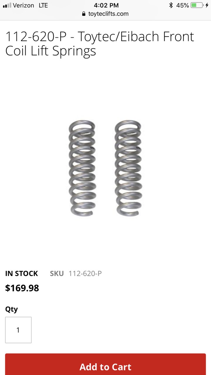

    What about these

    Thos
    They will work, but the spring rate is significantly higher. Unless you are running weight on your front bumper (winch or steel bumper) I would stay away and run the 521600. They will both sit at exactly the same height with stock bumper weight so there will be no difference in leveling. Keep in mind that the bilstein shock doesn't have as aggressive valving as fox/king so there is no way to mitigate the stiff ride if you do go with a higher spring rate with no bumper weight.

    Either way you go, 600 or 620 you will still get the same amount of lift
