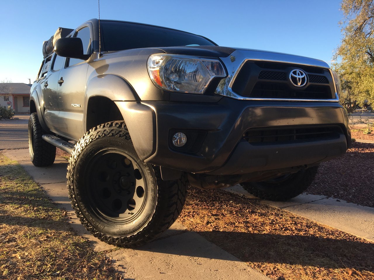

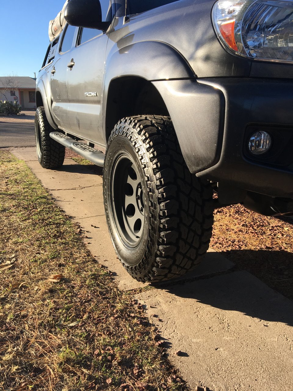

    Just installed this afternoon. Wheels look tough! Way better clearance to the calipers, and the offset pushes the tires out the perfect distance from the fender well. Had to do some trimming at the tire shop to clear the new 285/70/r17's.

    Nice! Love the look of the STT Pro's, but figured they'd be crazy loud on the highway. Since I put these wheels on my truck I get compliments all the time. Toughest looking wheel out there IMHO. Are you going to put on black lug nuts?

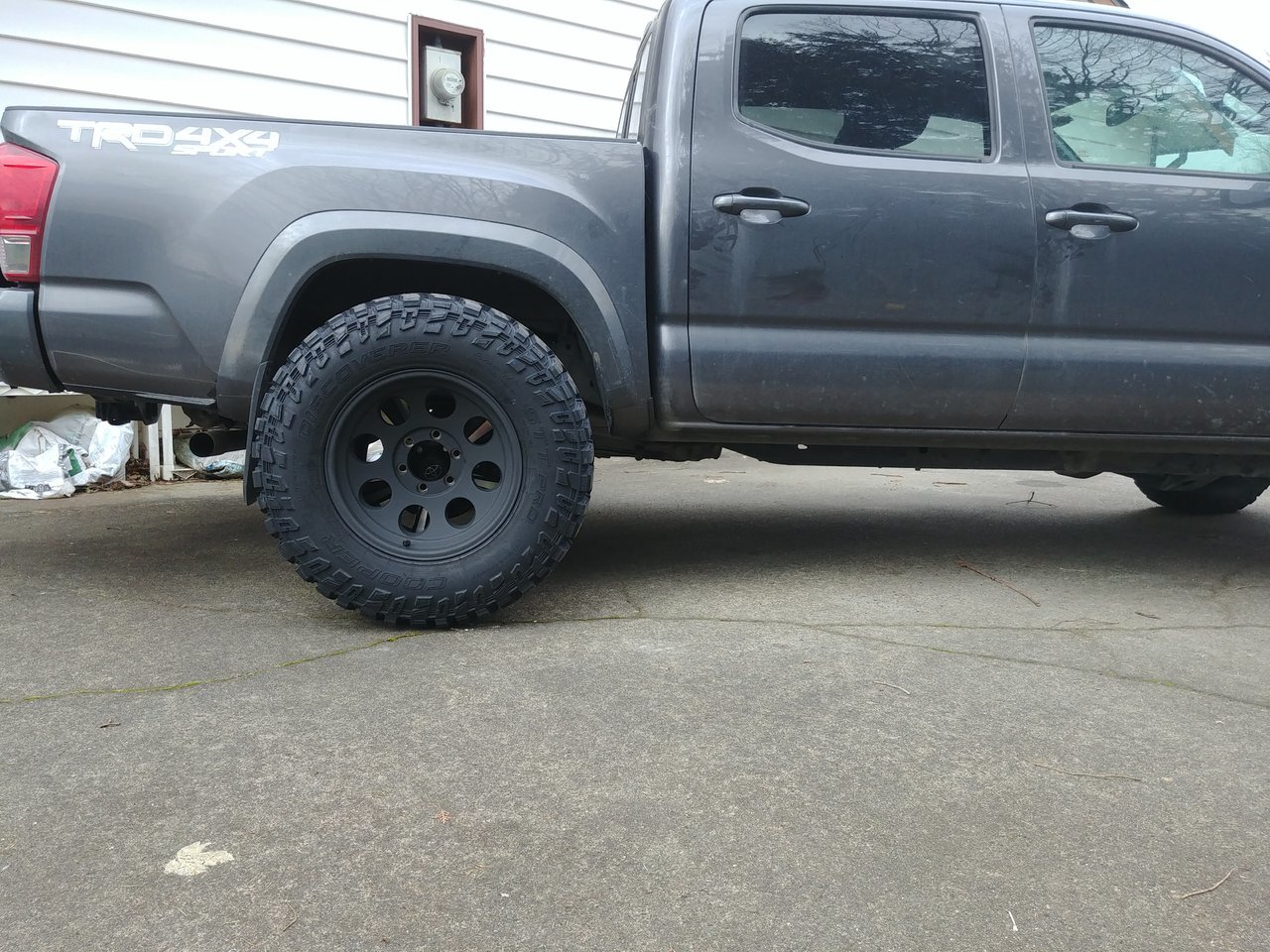

    I said I'd be back with pictures :anonymous:

    Very nice. Wish they were more black though..Fitment seems perfect.

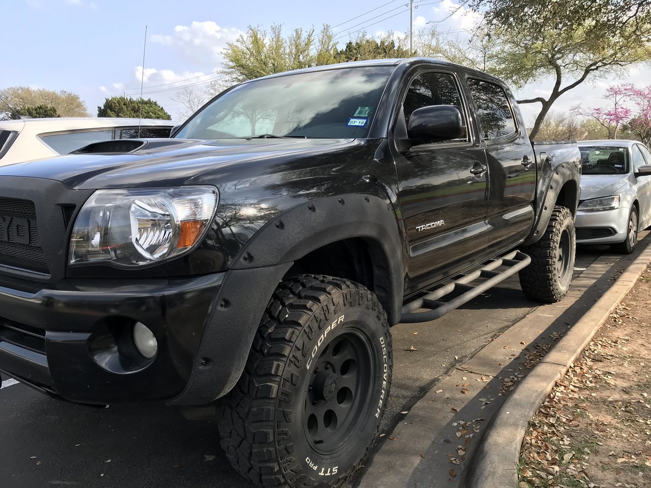

    Looks gooooooood, did you have any issues with the centre caps? They were really tight on mine

    Yeah, tight fit but was able to get them on with a rubber mallet

    Is your truck lifted and what size tire? Any rubbing?

    What lugs did you guys get? @SnRTaco those look good!

    Black ProComp lugs, I'll get you the specs when I'm off work!

    Appreciate it! From my research, it looks like M12 x 1.5, conical, 60 degree lugs are what's needed. With a spline interface... I think. If you could get me the part number or internet link to help identify that would be great!

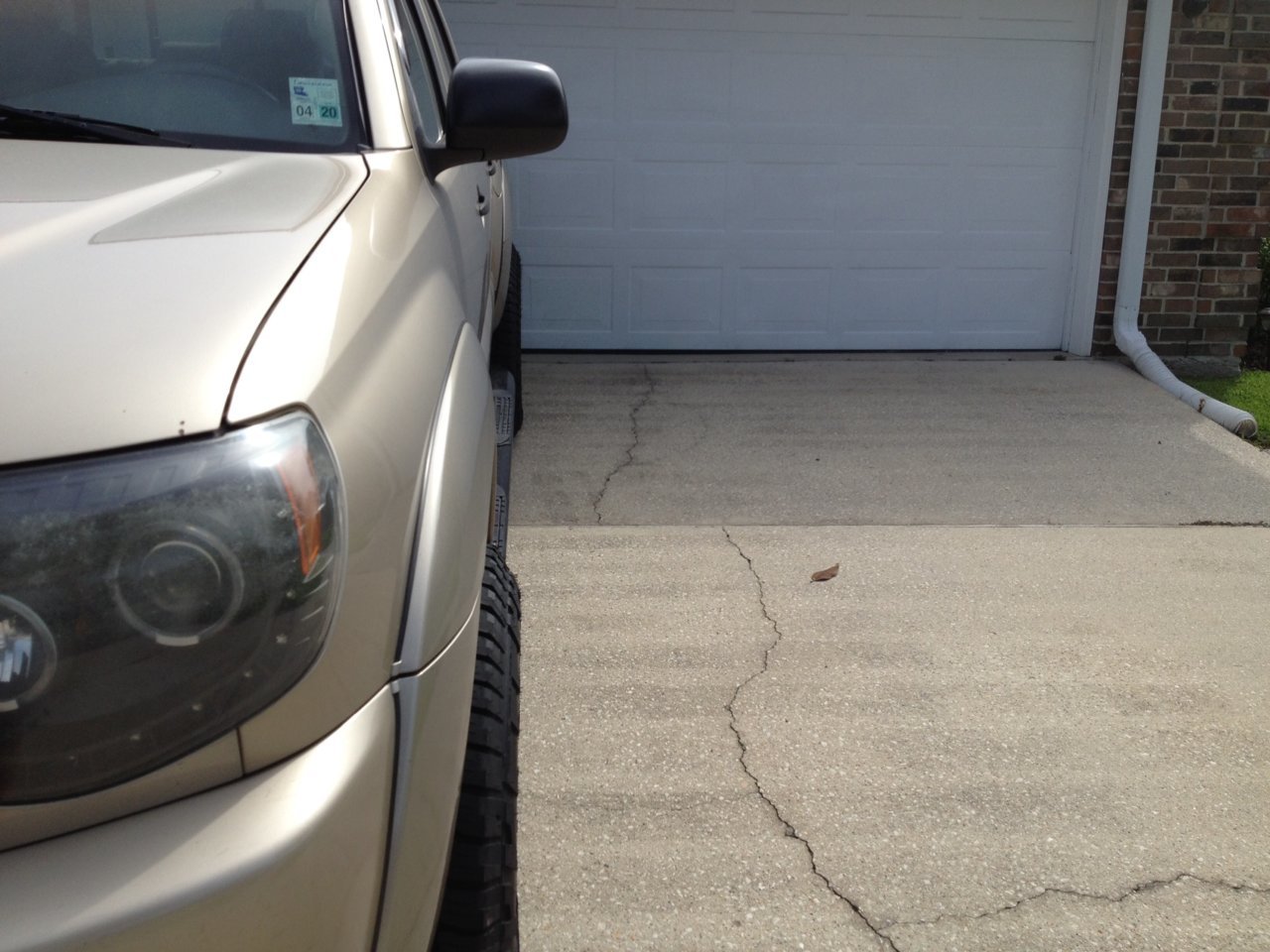

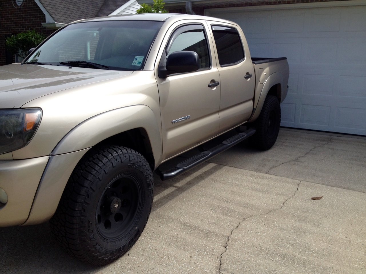

    2287650A-CB14-4B53-B5D7-DD4A01668FDE.jpg E19D7E11-82AB-4FD3-AD62-645E9EFF1C46.jpg
    16” -12 offset 265 75 16 Falken WP SL
    poked out too far for my taste replaced with 16” PC 7032.
