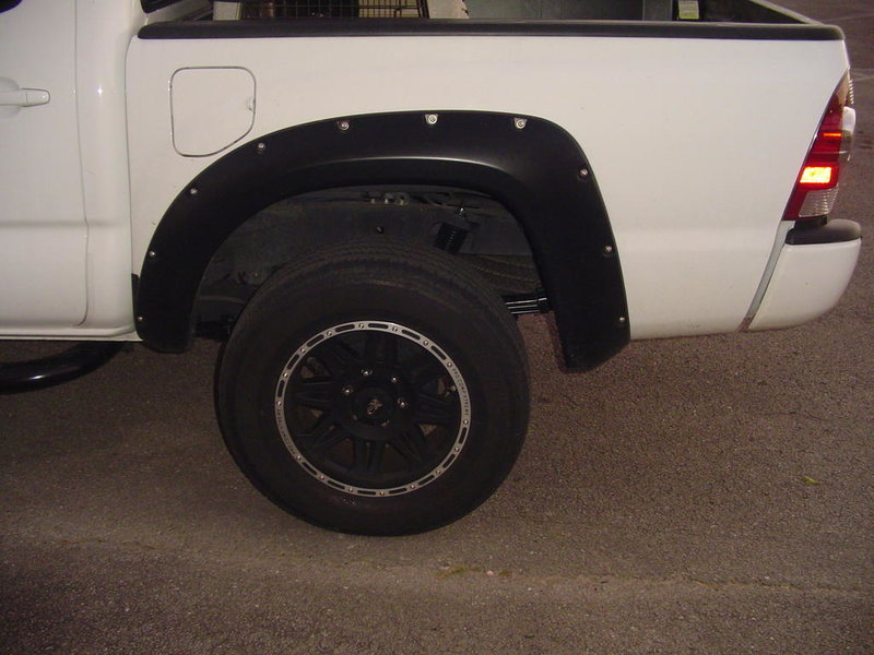

    been running 7105's for 2 yrs.+...balanced perfectly with no issues,tpms sensors fit..no leaks,a bit hard to clean...just takes a little time on the fronts with the brake dust.i'm still on the factory 265-65-17...debating going to same size,but with 70 aspect ratio(265-70-17)...i had no caliper issues,just be sure to get the proper (splined) lug nuts and maybe a good torque wrench(85lbs)..i check torque from time to time as i check tire pressures.my set up is bilstein 5100 @.85 and tsb rear.

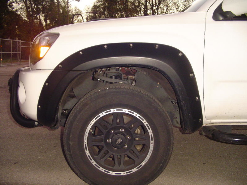

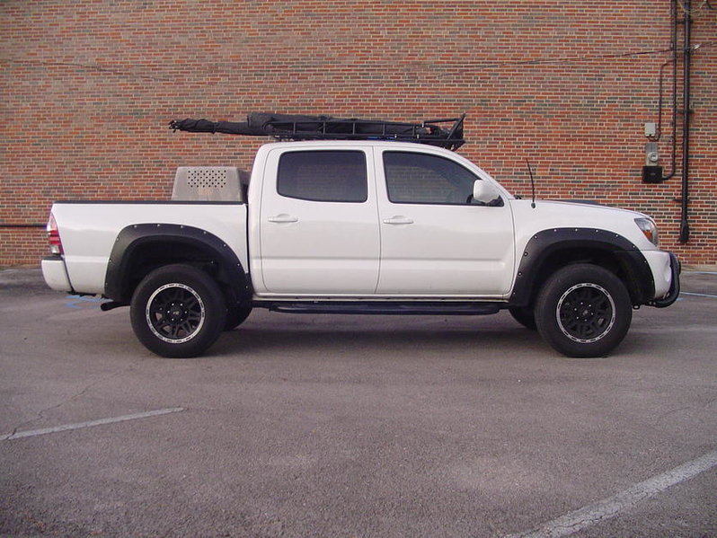

    op...my wheels are the exact same you listed in your post...bilstein 5100(4)@.85 front and "tsb" rear.

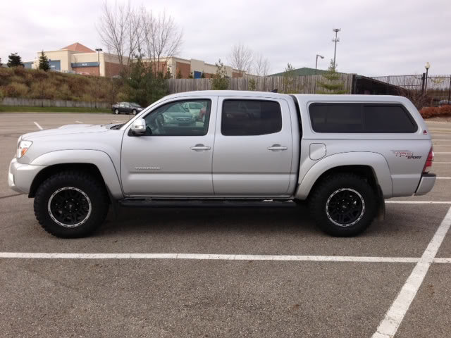

    Also Runnung that wheel with no issues. I'm running 265/70 R17 GY Duratracs on my 2012 Sport (upgrade package).
