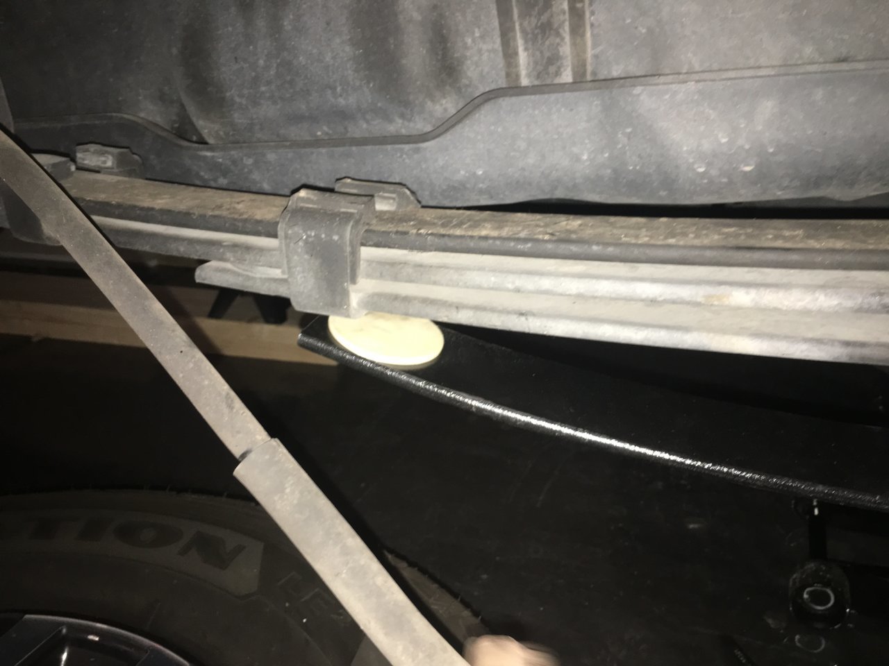

    Pro Comp add a leaf 57096B-5
    I’m just running into the same problem...the generic add a leaf 57096B ends right ontop of the spring retainer for the factory leafs! I didn’t buy something to spend hours modifying it to work, and why doesn’t 4wp put a note in their computer about this!? No videos on YouTube about this either.. I don’t know anything about the TSB.. time to do homework... either way if you run into this problem don’t remove the factory spring retainers, (the factory ones are welded in place, and the part rubbing the springs is coated in rubber). the metal ones provided in the kit will squeak aren’t as strong, may slide down the leaf. AF4FA21A-8D5D-4F54-BBC9-A3924205E353.jpg
    Use get the shorter add a leafs 13120 and save yourself the head ache!
