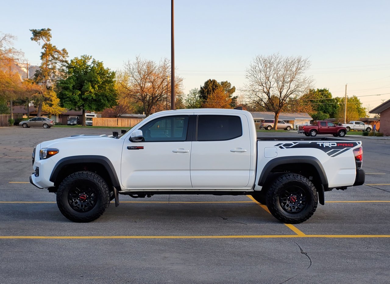

    Love the rear decal. Link?
    Foozer[QUOTED][OP] likes this.
  13. May 5, 2019 at 12:08 PM
    Foozer
    Foozer [OP] Well-Known Member
    Jul 2, 2012
    #81789
    1,086
    Utah
    2021 TRD Pro - MGM
    265/75/16 BFG KO2
  14. May 5, 2019 at 12:23 PM
