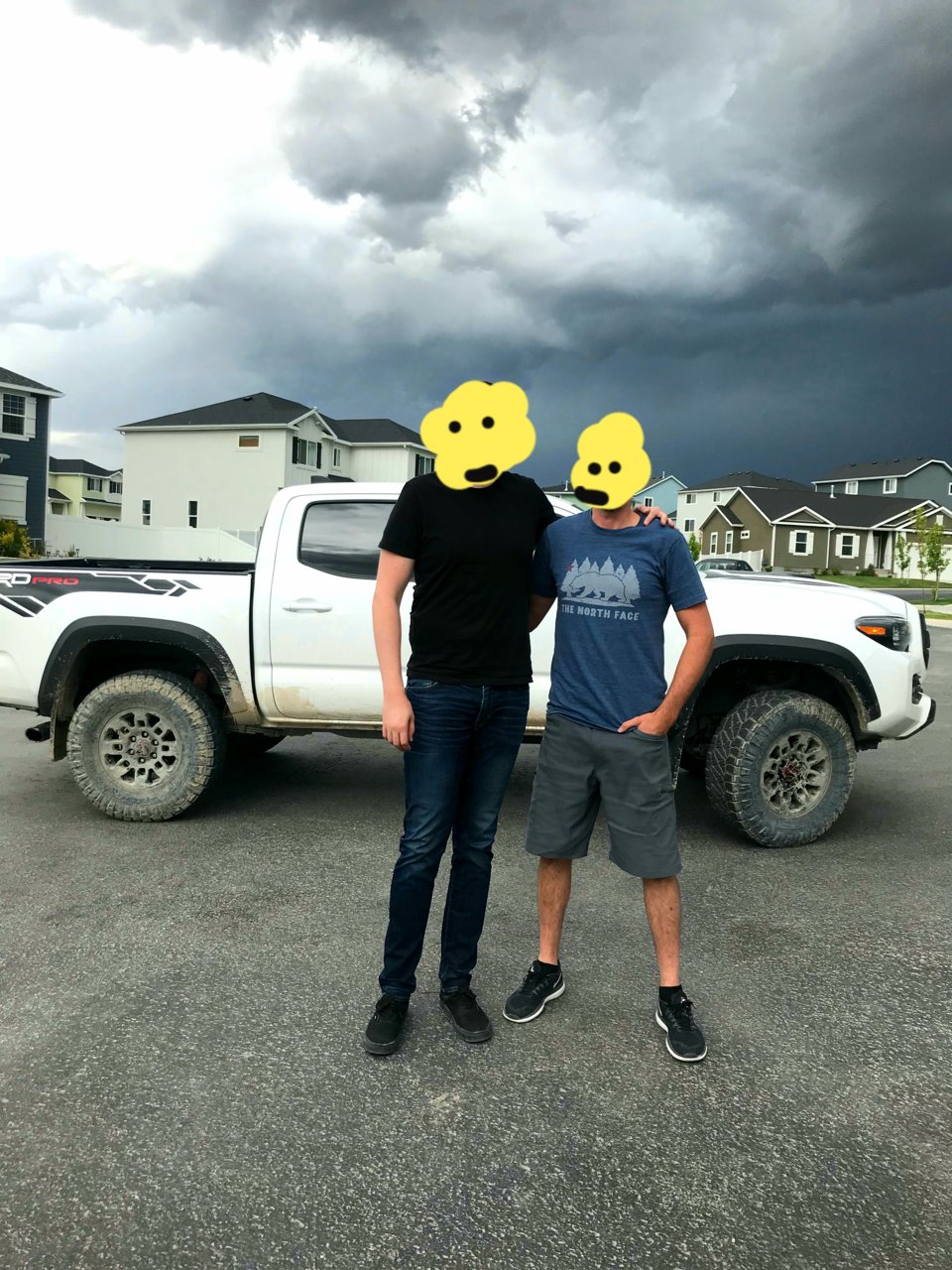

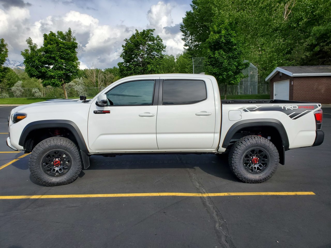

    Here are pics with the 1/2 shim in back

    That’s awesome, perfect stance imo. Thanks for posting. Might hit you up later when I get closer

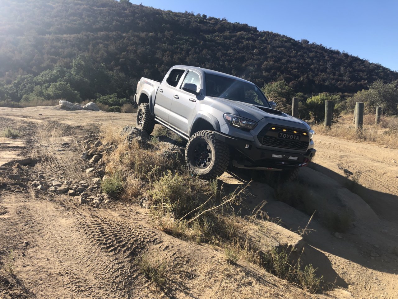

    9B030032-832A-424C-B0E8-173D4DA58835.jpg Revtek 427AP spacer kit plus add a leaf in rear 1 1/2” lift total 285/75/16 KM3’s (no CMC) Victory 4x4 bumper Warn VR8S winch no sag factory bumps on my Pro. My 2 cents Happy Trails

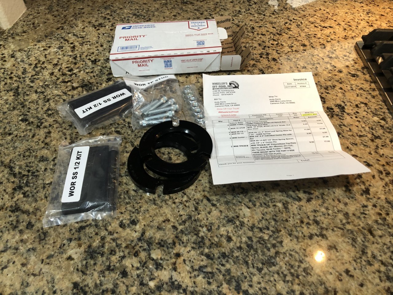

    I ended up going super conservative. Did 3/8” top plate and the same 1/2” shim you got. Plus the extended top plate studs w/ nylock bolts. I can always stack the front and put in a full 1” block later if I want

    Just now realized that was your truck stock
