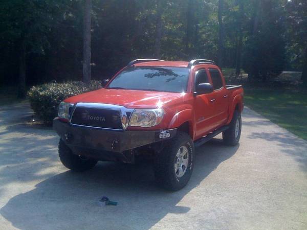

    thanks for all the props, what is the all-pro bumper made out of? i saw one today (first one up close) and it is very good looking but seemed to be a little thin. and i though it was just 4 parts that bolted together, seem like it was about 10? im not knocking the all-pro bumper or all-pro in any way.

    Winch mount is 3/16, everything else is 1/8" or thinner. The old AP was 4 main pieces and some upright braces, the new style AP is like 10 pieces(too many IMO:cool:)!

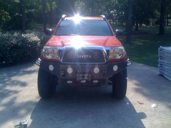

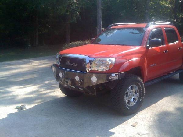

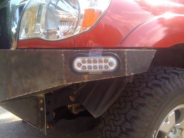

    I want everyones opinion on these lights. im on the fence they are taped on and would be recessed if installed, they would stick out about 1/4th of an inch, maybe a little less. they are clear and have red leds in it so when lit up they should be red. i wanted yellow for the blinker but couldnt find it.
  9. Sep 16, 2010 at 2:08 PM
    #109
    06redtacoma
    06redtacoma [OP] Well-Known Member
    May 13, 2010
    #37084
    593
    Alabama
    06 Trd Offroad
    Lifted, Slider, stock rack, rear mounted winch in stock bumper, brush guard, Sound system, ipod to car, tint, wheel spacers, 285 bfg AT,

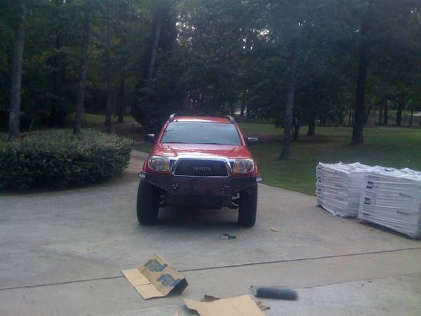

    couple more pics
    and here is one where i was trying to get a better idea so i taped on some paper circles where i am currently thinking the cutouts will go.
    i didnt have the bolts for the fairlead so all the tape.
    What do yall think about the side lights? they are tilted in the front pictures bc of the light hookup.

    all.on.black Well-Known Member
    Jan 2, 2008
    #4066
    1,516
    Auburn, WA
    06 Double Cab Sport with a few mods
    To me the side light are ugly. Why not stick with the turn signals you already have?

    The side lights are cool, but they stick out a little bit to much, once you have them recessed they might be better.... Otherwise, looks pretty good.

    and not to sure if u can have red lights up front anyways. think its illegal. even if they are just turn signals
  15. Sep 16, 2010 at 3:13 PM
    #115
    06redtacoma
    May 13, 2010
    #37084
    593
    Alabama
    06 Trd Offroad
    I didn't think about the red lights up front. Good call. Looks like I won't be using them honestly I think they would get broken. Seems like a shopping cart hit could even take those out. How long does it take per hole with the hole saw? I'm nervous about this I bought one today from lowes 30 bucks. Most expensive they had. Hope it will hold up to this. Thanks everyone
