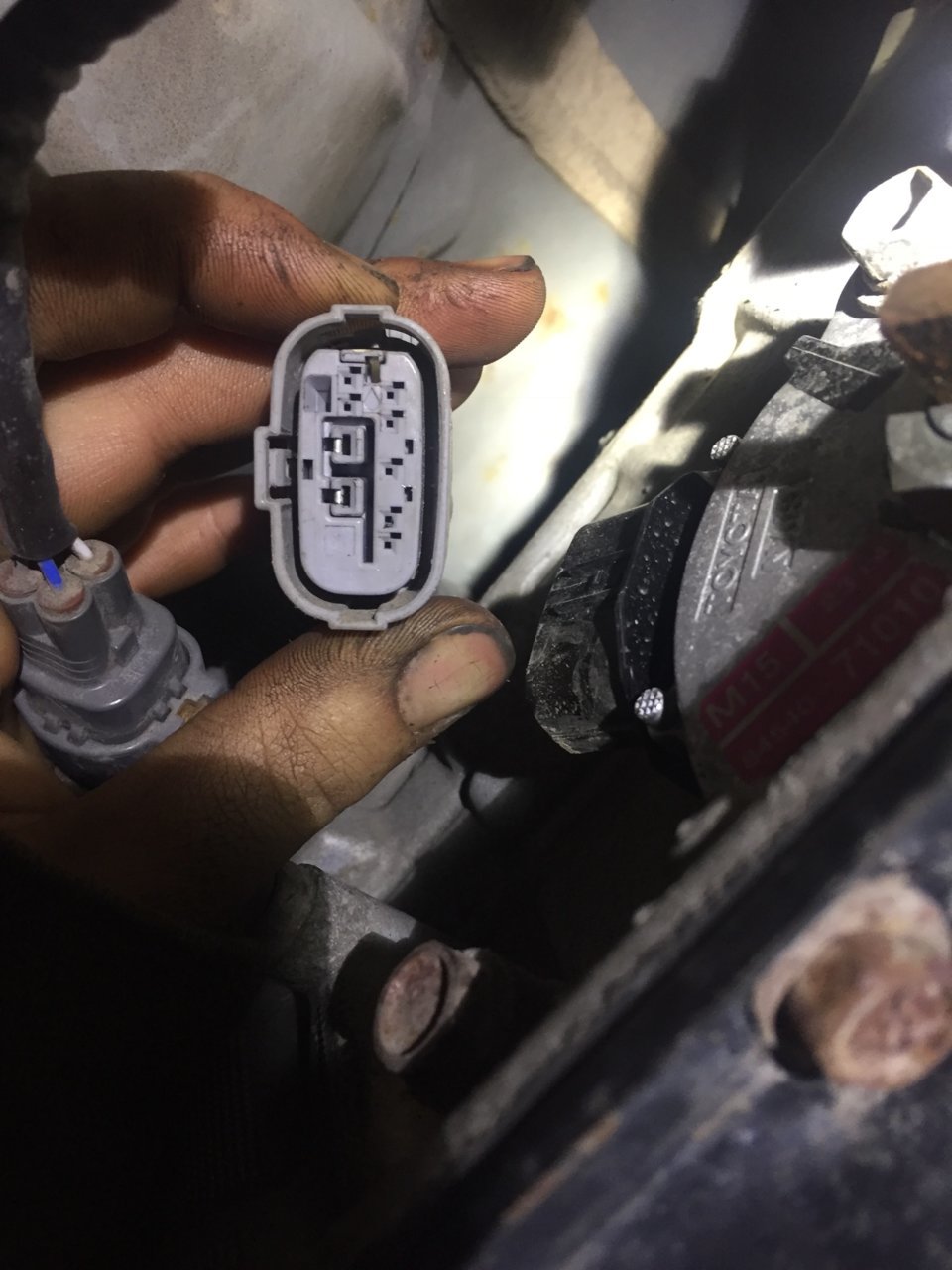

    Yes we will be checking that too . Also I just remembered a few weeks ago that the key can be removed from the ignition while the truck is running ! Isn’t there a connection between that and gear shifter ?
  10. Apr 27, 2018 at 2:44 PM
    #70
    lynyrd3
    lynyrd3 [OP] STRENGTH DETERMINATION MERCILESS FOREVER
    Apr 9, 2008
    #5848
    35,534
    Bill
    East Central Upstate NY
    4E70A621-A224-480D-9285-43488BCF2D1A.jpgThis Guy here ?

    What about the shift lock ECU . I’m able to remove the key from the ignition while it’s running ??? Could that be my problem ?

    Suspecting it may be the plug from the sensor . Not sure where that plug goes ?
