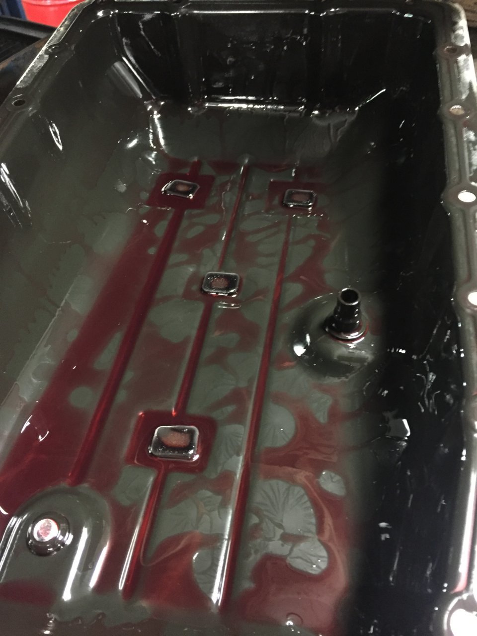

    Did the pan drop today with strainer filter replacement90D12170-D3A0-4D31-9C73-EB3588A2EF21.jpgpan looked good . No noticable metal filings . Just the normal tiny bit of goop around the magnets .
