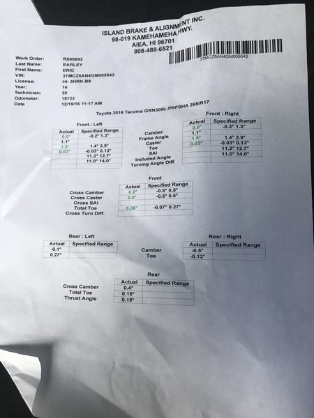

    -Alignment-
    Toe- 0 Degrees
    Camber - 0 Degrees
    Castor - Cannot remember but I know its within Factor spec, I believe 2.5 Degrees.
    The upper control arms were set to max castor and then fined tuned with the stock castor adjustment to get the tire centered in the wheel well
    Now the problem, the Tacoma has always had very loose steering, especially when going over bumps and the suspension droops. Completely normal. But now with this setup, every little bump or rut in the road, the steering is everywhere. Very loose and wont track on its own as a stock vehicle would.
    next problem is it will pull right or left depending on the road and road surface.
    My question is, is this caused by the heavy wheels and tires being to big for the stock steering rack to maintain control?? I am aware the Toyos are very heavy. if this is the case, is there a steering assist or upgraded rack to compensate for this??

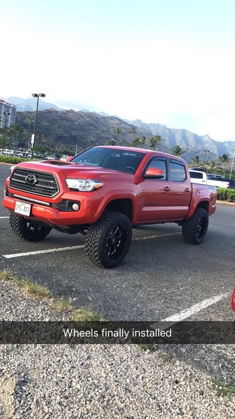

    added picture for curiosity

    Post your actual alignment numbers.
    You're under caster for that lift height - my guess.
    Stock specs are for stock geometry and you're far exceeding those limits.

    Also mind you the Upper control arms are set to -2.0 Degrees castor

    Your caster shows at 1.5 degrees.
    I'm at like 2.5 - 2.7 so my 33's clear on my 3" lift.
    More forward caster makes it "harder" to steer left to right, but it creates stability and clears the tires from the wheel well better.

    That's what I thought, thanks Kyitty, if you look at the install guide for my control arms here
    http://www.spcalignment.com/instructions/25480-INS_WEB.pdf
    -2 degrees castor on top is actually pushing top of knuckle forward 2 degrees while the stock adjustment on bottom is only pushing it out 1.5 degrees, so in essence I have -.5 degrees castor. Can you confirm im calculating that right.
    Unfortunatly we used this setting to clear the tires from the cab mount, but in the end I think made it worse. May have to trim cab mount and realign
