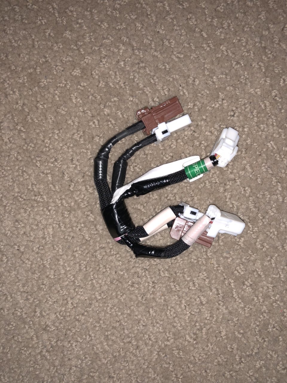

    I put back in my stock head unit after a couple years with an after market unit and it says the mic is disconnected and the backup camera doesn't work. I'm pretty sure I got those connected properly, although I did need to splice the backup camera wires back together since I had to cut them when I went to the aftermarket hu to retain the factory camera. Maybe I spliced poorly but I doubt it. At the risk of looking dumb, what is this set of plugs? Do I need them? They've just been in my glove box for as long as I can remember. I don't remember them ever being plugged in. 2015 etune with nav and no jbl. 4A0B5A0B-2E6D-4D2C-8352-60C2E855CE27.jpg

    What does the back of the stock radio look like?
    That looks like the harness that jumps between the factory radio and the xm/sirius/ Or Nav Brain.....

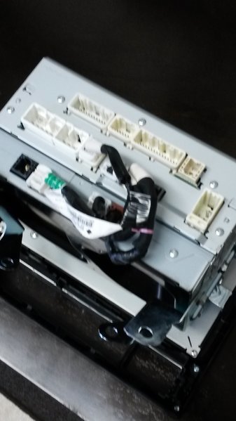

    B1DDFB45-9D66-434F-BA1A-0B581E75A159.jpg You may be right. Found this pic on Google and I'm pretty sure that's my radio. I don't think the harness was ever hooked up before. If it doesn't have anything to do with the backup camera or mic, that harness doesn't solve my problem I guess.

    I’m no expert but that shit looks pretty important :crazy:

    Well one of the wires for the head unit had been pushed back behind the dash and I couldn't see it. Plugged that in and it all wOrks.
