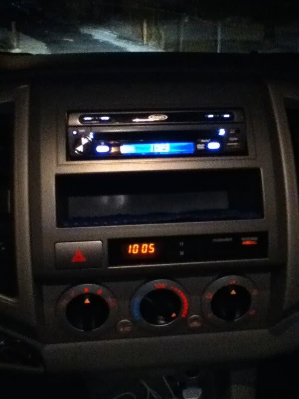

    I just installed a single din HU last night with the metra kit and I have two problems. First let me say I didn't have time to take it all back out and see if I could fix them. Firstly the hazard button seems to be binded up or sticking when I push it in and secondly I was just wondering if you guys use the faceplate trim piece that comes with the kit or the one that comes with the HU. Mine has a gap around it that I don't care for. From using the search box I found that everyone seems to like the scosche better but for now I'd like to make this one work.

    I have had my metra kit/single din in for a year no issues.
    I modified it to use with my oem metal brackets & the metra faceplate.
    no problems with haz button.
    I do remember there being a 1/4 space b/w deck & little cubby.
    Honestly do not even see it anymore. Just get in & drive turn on deck good to go. Here is a bump for more responses.

    I have a Pioneer P4100DVD head and used the trim with the metra, seemed to fit pretty nice.
    Yes the hazzard button will bind some, loosen the screws and push the hazzard/clock assembly over some to make it clear better, then tighten the screws back down, but dont tighten them alot, just enough to hold it in place well.
    Otherwise, no issues here, I was impressed how well my "black" one matched the dark grey of the stock parts on the dash.

    My hazzard still binds, Im too lazy to take it back out and shift it over. I just tap it to come back out. PS... I dont think I used the faceplate. I will snap a pic if u like.

    Huh? I guess I was lucky because I didn’t have a problem with the Hazard button. But it sounds like from above posts that’ll be an easy fix.
    I used my HU’s faceplate trim… but I went at the installation a little bit different. I slipped the HU into the sleeve, attached the faceplate trim to the HU and then slipped this assembly into the Metra single din fixture. At that point I eyeballed the fitment & made some mental notes as to where the sleeve needed to be mounted. I disassembled everything then permanently attached the sleeve to the Metra kit*. Once that was done I attached the faceplate trim to the HU then slipped the HU into the sleeve. Fit perfect. Then I attached the Metra single din w/HU onto the Metra dash assembly. I hope this makes sense…?
    *Note: I had a piece of material that’s best described has a rubbery plastic that was just thick enough to fit between the HU sleeve and the storage pocket to help support the weight of the HU once installed. I held the material in place with a dab of silicone adhesive. Just adds a little extra support.
    BTW, my HU is an Alpine CDA-117. I have a couple of pic’s in my gallery but with everything being black and then the shadowing it’s hard to tell how it all fits together. Good luck!

    I used the trim piece that can with my head unit and it fits perfectly. I had the same problem with my hazard button. All you have to do is take the plastic cover off and shave a tiny bit of plastic off of the punch out for the button. They cant get it perfect everytime when they punch out those holes before they form the plastic. Should take you all of 5 minutes to fix it.

    I don't think it needs to be trimmed. I failed to mention that when the cover piece is not locked in the button pushes fine. it's after I press it in that it binds up. I may have to reposition the HU bracket so it isn't binding.
