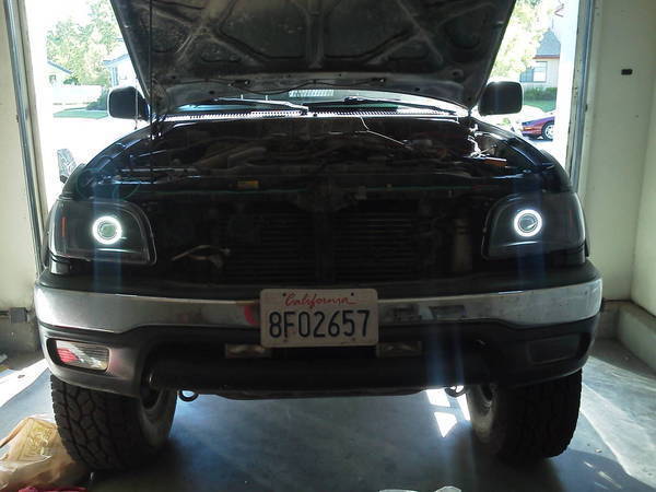

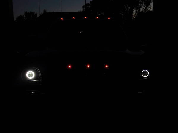

    Just completed my retro from TRS last night. Before I installed ANYTHING I function checked all components. Everything worked great. After I installed everything last night, about 6 hours of labor... I turned on my running lights, with the halos wired into them to view the beauty. Both halos illuminated perfect and very bright! So I turned everything off, put my front end back together and checked everything: low beams, high beams, running lights, turn signals... everything still worked great. When my girlfriend got home I was excited to show them off to her. So i turned on the running lights (halos illuminated) and a few seconds later, the drivers side halo flickered and then went out.... VERY DISAPPOINTING!!! So I check all my connections and even connected the halos directly to the battery to rule out any power supply issues, or faulty connections. After a bit of wiggling, the halo turned back on but is now SIGNIFICANTLY dimmer than the other one. Has anybody run into this issue before? I'm really hoping its just that little cylindrical unit the wires from the halo go into before coming out as connecting wires. I do not want to have to order new halo, New shroud, and do the entire headlight housing process all over again. Please help!!!

    I didn't check anything with a meter. But before I installed them, I tested both by touching the hot wire directly to the battery. It wasn't until after the install and a couple min of run time that it flickered, went out, and now is about half as bright as the other

    I dunno, maybe a phone call to the retrofit source? looks like half the leds went down, either a resister or bad wire...either way, probably going to have to take apart..
