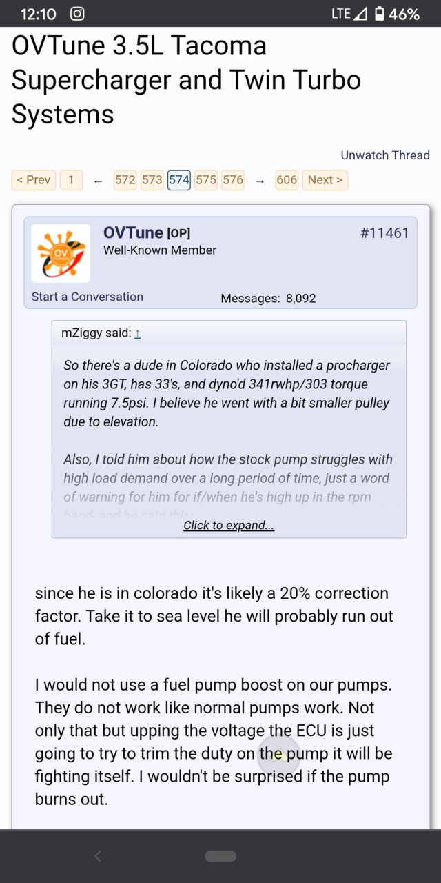

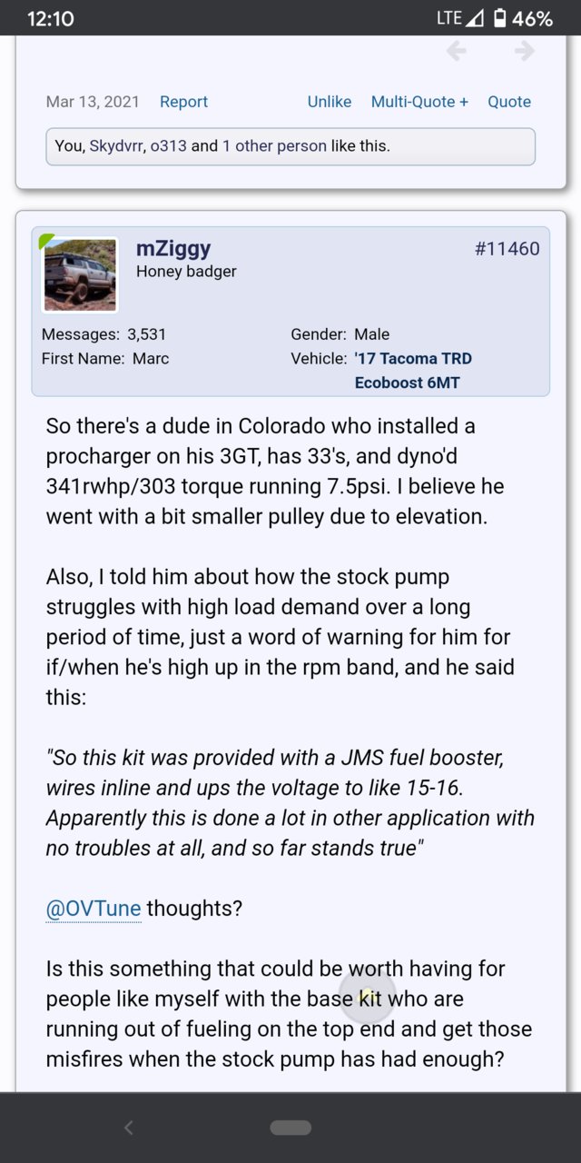

    I wonder why a boost a pump style system wouldn't work with our pumps? Returnless Mustangs have been running them 2+ decades without issue. Is it truly an issue with the pump or tuning?

    You'd have to ask OVTune about that, I don't know the answer. I doubt he has a particularly strong desire to get pulled into this thread, but here's a link to the post I screenshotted, could ask him there:
    https://www.tacomaworld.com/threads...n-turbo-systems.566390/page-574#post-25331873

    Some atkin’s cycle issues I’m sure.
