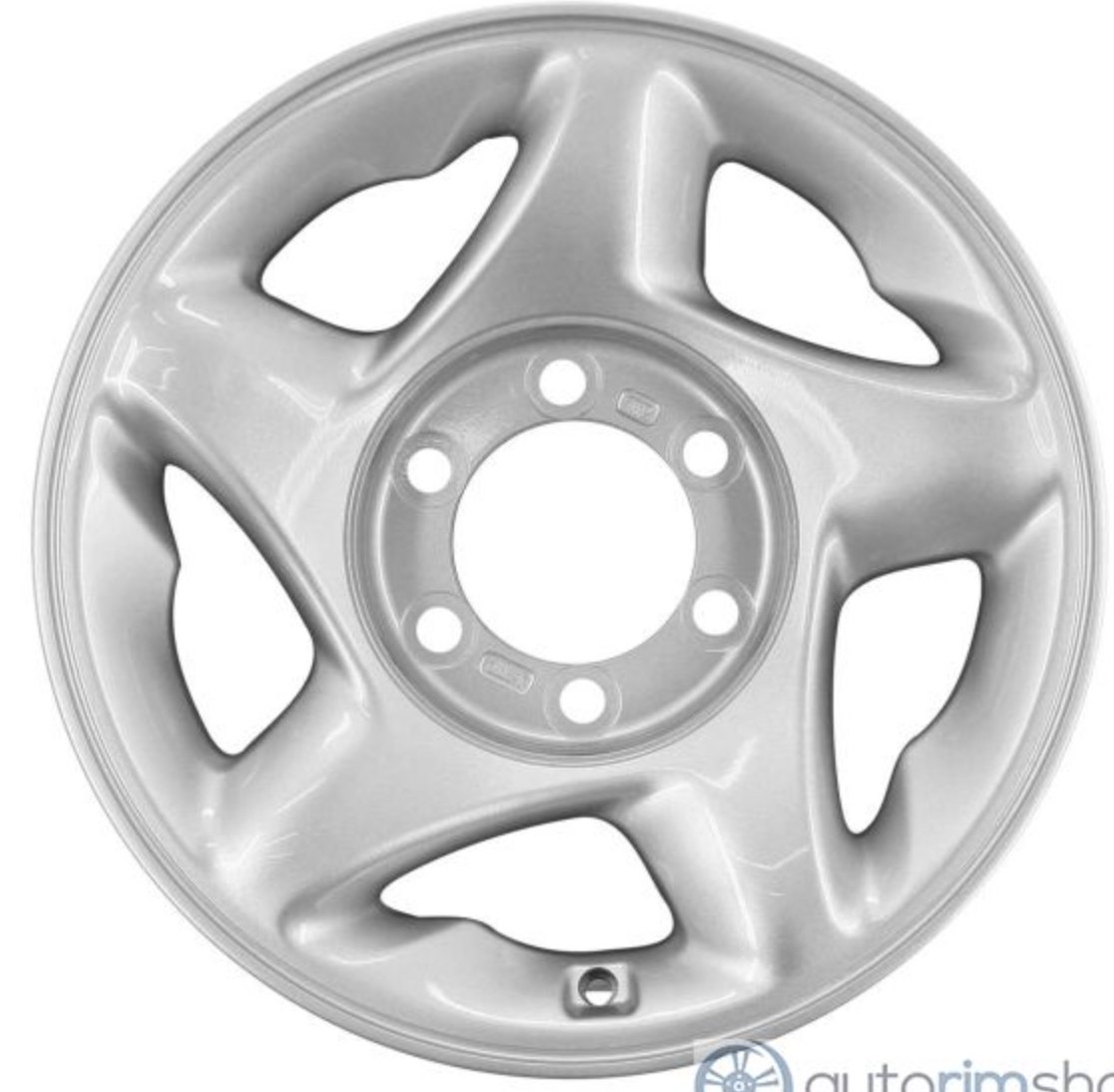

    Just a sanity check- I'm pretty sure that the stock wheels:upload_2022-4-20_20-17-5.jpg
    Were available on both the Tacoma and Tundra- and therefore the similarly spec'd ProComp 7069-6883 wheels would work on a Tacoma with the Tundra brake upgrade..
    I had a set of the 8069 (discontinued... wheels a very long time ago before the brake upgrade) and looking to get back to that look. I know they aren't exactly the same design, but as close as I'll get- which I am ok with. Just want to confirm the 7069 will clear the tundra calipers.

    Summit lists them as 87.1mm center which is too small (that's GM center) so if they are custom making them make sure you get the 106.(1 or 25 can't remember) center.
    but looks like they have 4 inch BS, although ProComp lists them as "universal fit" which is hard to believe unless they are 108mm center
    hopefully someone who has them can confirm
