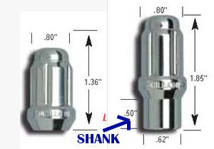

    This is the crap that 4wp sent me... they are NOT the right lug nuts for these wheels. I have gorillas on mine but they are chrome and dont come in black. I have yet to find a black lug that works. You need a lug with a shank on it for two reasons. One for more lug coverage and the other because these wheels are not hub centric you need a shanked lug to center the hole in the wheel with the lug. The acorn/tapered end style don't always center perfectly and can cause balance issues. Let me find a pic of the right kind for you. but they wont be black.

    The left is unshanked and the right is shanked. The shank goes into the hole in the wheel and centers it around the lug as well as providing more thread coverage of the lug. The one on the left just relies on the tapered part to center the hole on the lug and they dont always seat right. I called 4WP and asked for black lugs for the 7089s and they sent me ones like the left. But, I refuse to run that kind of lug on a non-hubcentric wheel and very much like the fact that im getting that much more thread coverage. I will just live with chrome till I find black shanked lugs in the splined type.

    so you are saying that you purchased a set of wheelers' black acorn lug nuts that are shanked to properly seat a lug centric wheel, that will fit inside the tiny pro comp lug nut wells? damn, i need to get on this too. I have the pro comp 7028s and I take forever putting the lug nuts on so the wheel is properly centered around the hub and the lug nuts dont drill another groove into the wheels.

    Nope I did not get black acorns properly shanked. I ordered chrome acorns with a shank. As someone posted before, seemingly, there are no black ones available.
    I may lightly sand the top surface of the nuts and spray them flat black.
