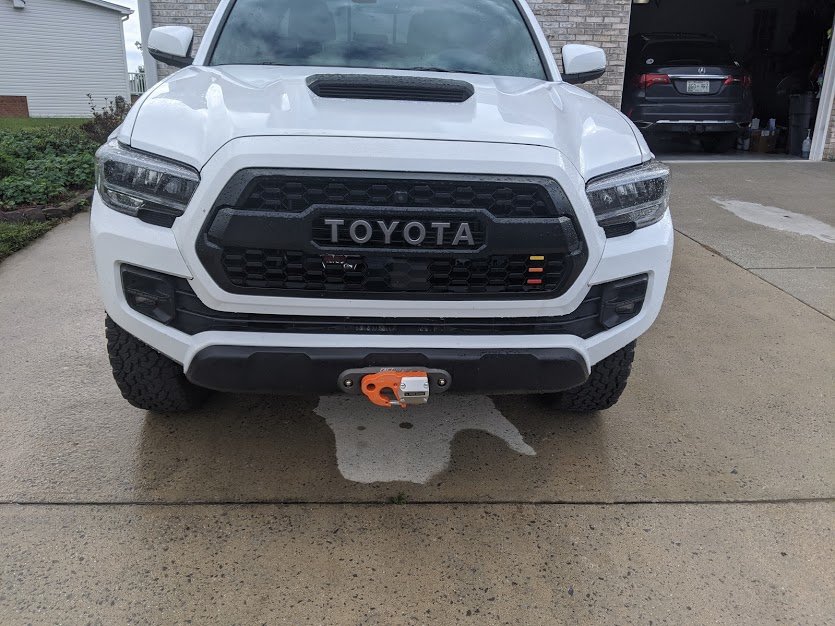

    Which mount is pictured here ?
    TIA Steve
    Ngneer likes this.
  14. Sep 17, 2019 at 11:25 AM
    Admiral_Akbar
    Admiral_Akbar Well-Known Member
    Aug 13, 2016
    #194494
    516
    '17
    SDHQ
    notlefty[QUOTED] likes this.

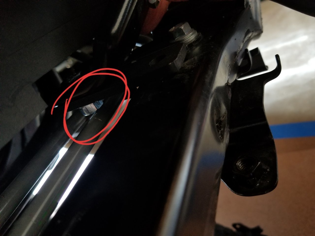

    I know this thread started a couple years ago, but still popped up when I was exploring winch mounts. If you are shopping for one, I recommend not using RRW (Relations Race Wheel). They offer an incomplete product, not stated on their website. Customer support is not the greatest. Look at more reputable manufacturers.

    Here is the link to their site, and I'll also copy and paste the content of their website:
    www.***********************/products/hidden-winch-mount-tacoma
    The power steering cooling lines run in front of the radiator. I had seen other installation videos where other manufacturers provide a bracket to relocate them further back so that the mount can be installed over bolt threads where the crash bumper sits (crash bumper needs to be removed). During my first attempt, after spending several hours removing the bumper (it was my first time so there was a learning curve for me), i couldn't figure out how their winch mount was suppose to mount flush on those threads. I later found out about the relocation brackets. So emailed customer support, and said they would make brackets for me. It's a little suspicious that they have to make brackets. I would think they'd probably forgot to include them, and should have them readily available? Especially because this this is a "high demand product." But whatever, it took another week to receive them.
    I emailed again asking if there's any thing else I should need before attempting a second install, tips, anything else I should know. They assured I was good to go, and that it should be self explanatory. Today, I gave it a go. Got down to the bracket install portion, and of course, I was going to need additional hardware. Not sure if this was on me. I thought I would be reusing factory hardware to mount this thing, but anyways, no mention that I needed to purchase bolts to secure the power steering lines to their bracket. When to local hardware shop, purchased the hardware. Continued with the install. What they didnt take into account is that the mount should've been a different size on the driver's side. It should've been longer, and not the same size as the passenger side. The problem is that the bolt I just installed hits another line (I'm not sure what kind this is, but it has a light grey jacket over it, and there's two). I attached the picture to it. So, I called it quits at that point. I wasted 2 days on this. I'm not one to be dramatic at all, and I really did my best to see if there's another way around the issues, but I was done. Other manufacturers take everything into account, and tell you what specific modifications the buyer is responsible for. I was surprised when I read RRW's description cause it seemed too easy. I figured I support a local shop. Should've followed that gut feeling. Sorry for the long explanation.
    Here is what their website says. The part that states "Utilizes all existing OEM hardware - no special hardware needed to install" is completely false.

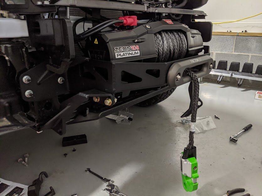

    2020 TRD Pro
    I've got the SDHQ. I've been super happy with it, no complaints at all. I bought me a Warn 8274 for my land cruiser so I picked up another Ultrahook a few weeks ago. Trying to decide if I like the orange or green better on the Taco...lol
    Ngneer, Supr4Lo, CorsoTaco and 6 others like this.

    Man that looks great! I have the Warn Evo 10-S. How was the mount install with the SDHQ? Did they send all the required hardware? All I wanted was exactly what you have, haha
    I guess the plus side is that I can get that fender off a lot quicker than the first time around, haha
