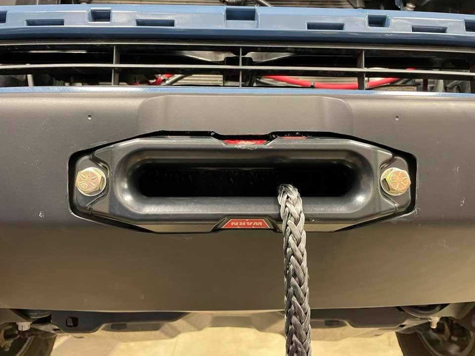

    I just finished the SDHQ hidden mount on my 2019 Tacoma using the Warn Evo 10S. Winch fits fine and the SDHQ kit is pretty nice. Biggest issue is that you have to separate the control box from the winch and figure out a mount for it. I ended up fabricating a couple steel brackets and mounted it to the cross bar in front of my radiator.
    Also, they don't have a template for cutting the bumper cover that matches the fairlead for the Evo 10-S, so it's a little bit of a leap of faith as to where to center it and how to trace it. I mangled it pretty badly the first time and bought a new black piece for my bumper cover. I oversized the cut on my old mangled part, but installed it completely so I could precisely measure where the fairlead mount bolts are relative to known features on the bumper cover. Once I had those holes mapped out carefully, I drilled bolt holes in the new black piece and bolted my fairlead directly to the black plastic piece. Once I had the fairlead bolted onto the plastic piece, I carefully traced the perimeter and dremeled it out. Once I had it roughed out, I sanded it with a sanding block. End result looks pretty good. I would have preferred to see SDHQ put nutplates on the back of the mount plate for attaching the fairlead. Seems like if there were nutplates, then you wouldn't have to be so precise in your cut, and you could sandwich the bumper cover between the fairlead and the mount. There's probably a good reason why they didn't do that, but I think I would have preferred it.
    My $0.02....

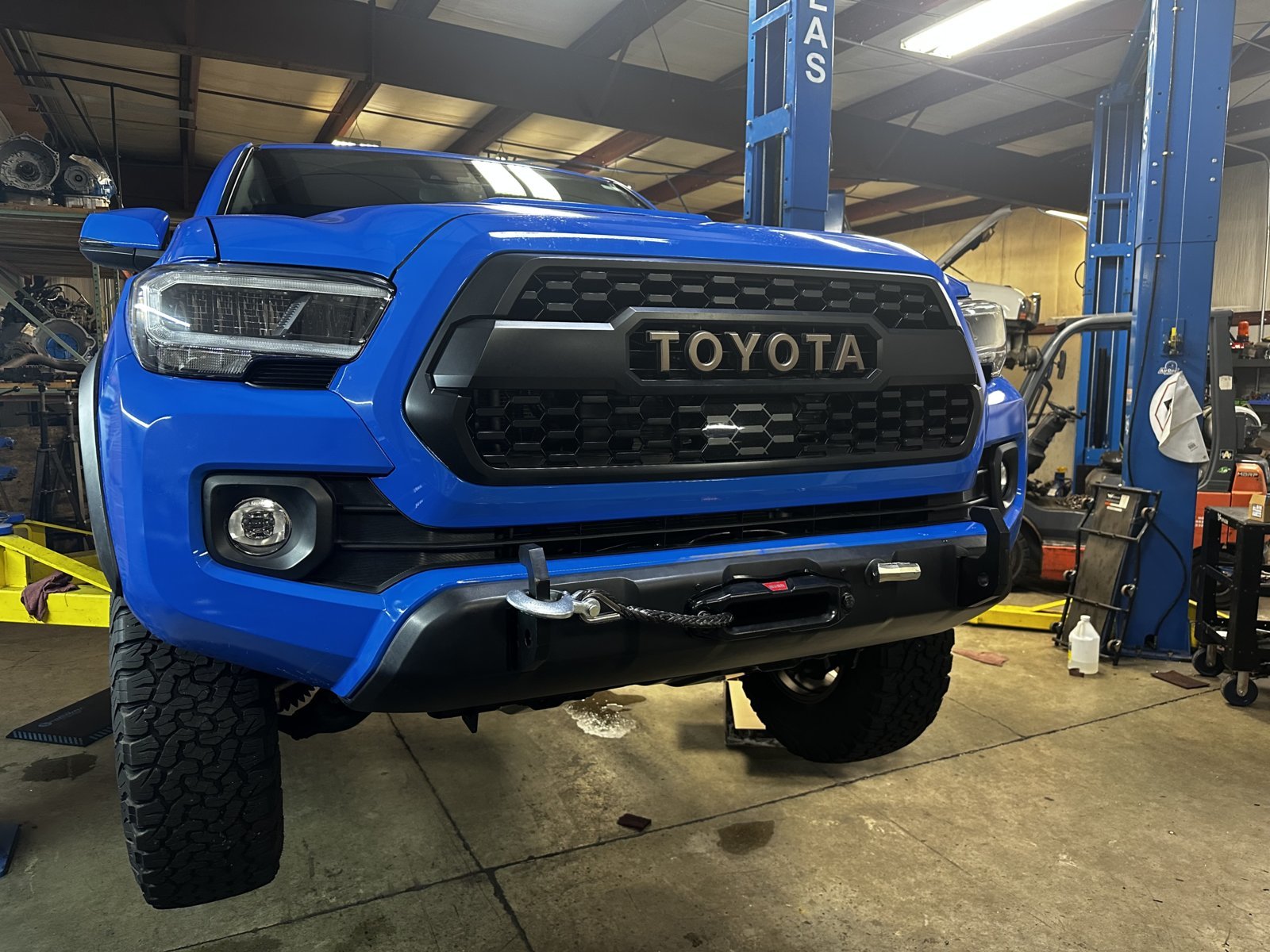

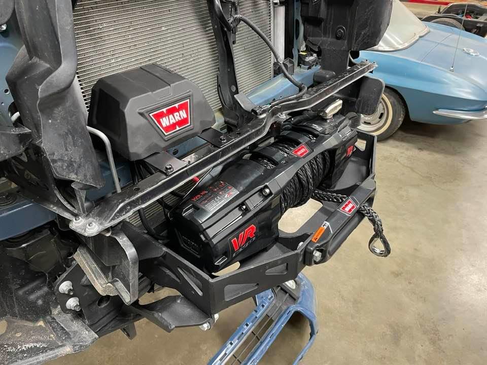

    Went with a VR Evo 10S on mine and had my friend make an extension for the clutch handle. Clocked the housing and ran it out the front of the bumper.
