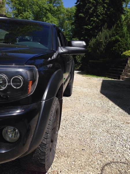

    He is a little sneak peak before my camping trip next weekend. Got the mirrors friday before memorial day had em on the next day. Had one little question i think i relayed the turn signal to my rear brakes bc everytime i hit the brakes they come on. They work with hazards, individual left and right signal but anyways heres the pic and more to come with my tow of my 20ft camper again this weekend!!!

    Mine do the same thing! Have not had the opportunity to troubleshoot. I'm suspecting I got the wrong wires attached! But unsure. Post if you fix yours please!

    Sounds like you guys hooked them up to the wires from the towing harness. Ask me how I know :rolleyes:. Sorry about that. Anyway some trucks do have some different colors wires and we are revising the directions. If you have a test light just go in and check for the blinkers at the conectors then tap into those wires.
