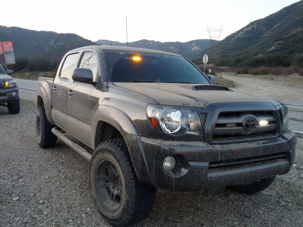

    THE TRUCK:
    2009 Toyota Tacoma
    TRD Sport Double Cab Short Bed
    Magnetic Gray Metallic
    4.0L V6 with Tow package
    2wd with RSCA and LSD
    JBL System with Bluetooth (now removed)

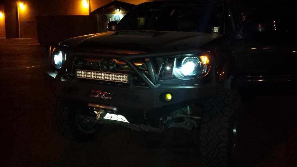

    LIGHTING:
    STL Striker TIR Grille lights- 4 MaxGen 3w LEDs (amber/blue)
    RLB Rear Chase Light (Red Brake/Blue Strobe/Amber Dust)
    LazerStar 18" single row spot
    Two 6" Blitzpro led bars for alley lights
    Lite-Way 2x2 Amber Pods (flood) (removed)
    Lite-Way LED 2x2 Pods (spot/flood combo) 20w Cree on front ditch light brackets
    1x2 slim pods on AllPro swing out bumper for auxiliary reverse lights
    Flush mount bed lights
    PIAA LED driving lights (formerly Lexus OEM yellow projectors)
    TRS D2S 3.0 Retrofit w/ 5000k bulbs
    SpyderAuto LED smoked taillights
    Two 6" COB Led strips for under hood lighting
    Bulldog Lighting CLAWS Red rock lights
    Tough Stuff velco LED strip in camper shell

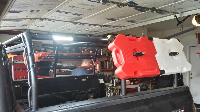

    5lb rechargeable first extinguisher custom mounted on roof of camper shell
    AllPro pack rack custom cut to 18.5" with accessory bars (removed)
    Rotpax two 2gal h2o with LOX mounts mounted to pack rack (removed)

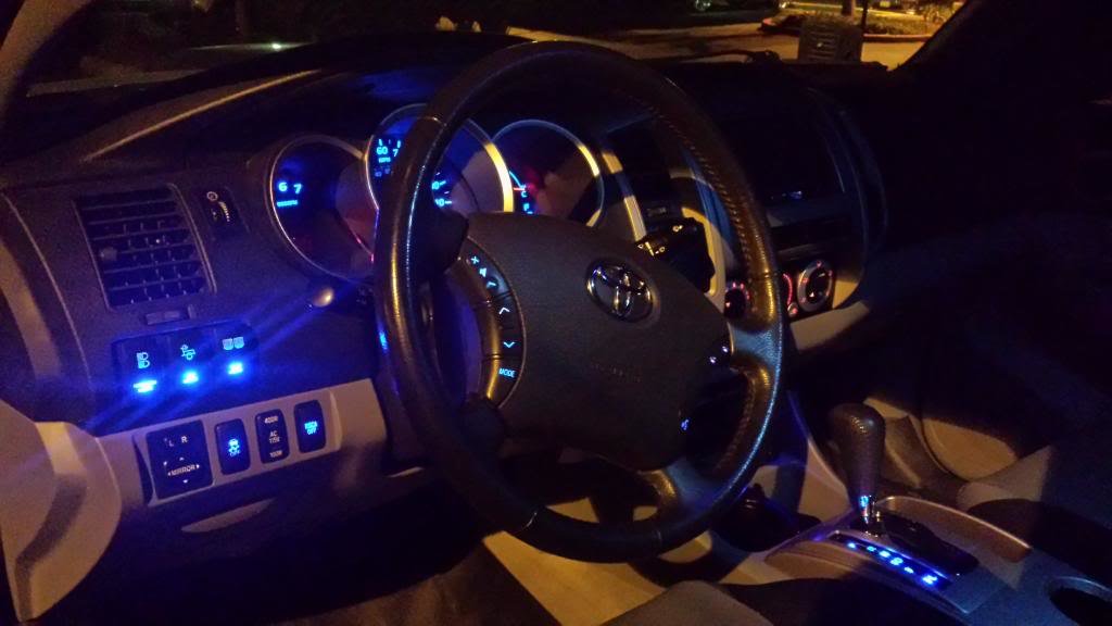

    LED Gauge swap to all blue with oem needles
    Full Blue LED swap throughout (Steering controls, AC, PRNDL, Clock, all OEM switches including window)

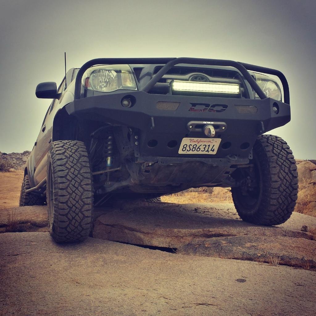

    Demello 3-hoop plate bumper with winch frame support braces
    AllPro dual swing out plate bumper w/ high clearance hitch and camera relocate
    Allpro weld on sliders w/ kick out
    Engo 9k winch w/ wireless remote controls
    Synthetic line, Factor 55 Fairlead, Factor 55 ProLink thimble
    3/4" D-Rings x3

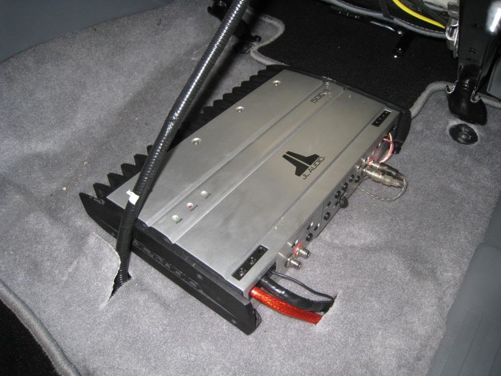

    STEREO SYSTEM:
    Pioneer NEX-4100 Double Din HU with XM, iPod, HD Radio, Pandora, Aha, Google Maps integration and 4v pre-outs
    OEM Aux input linked to Pioneer HU
    OEM Back-up camera linked to OEM mirror and HU with manual trigger

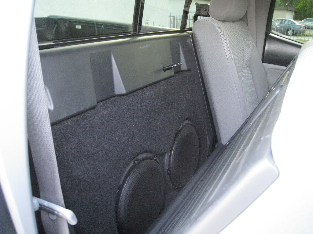

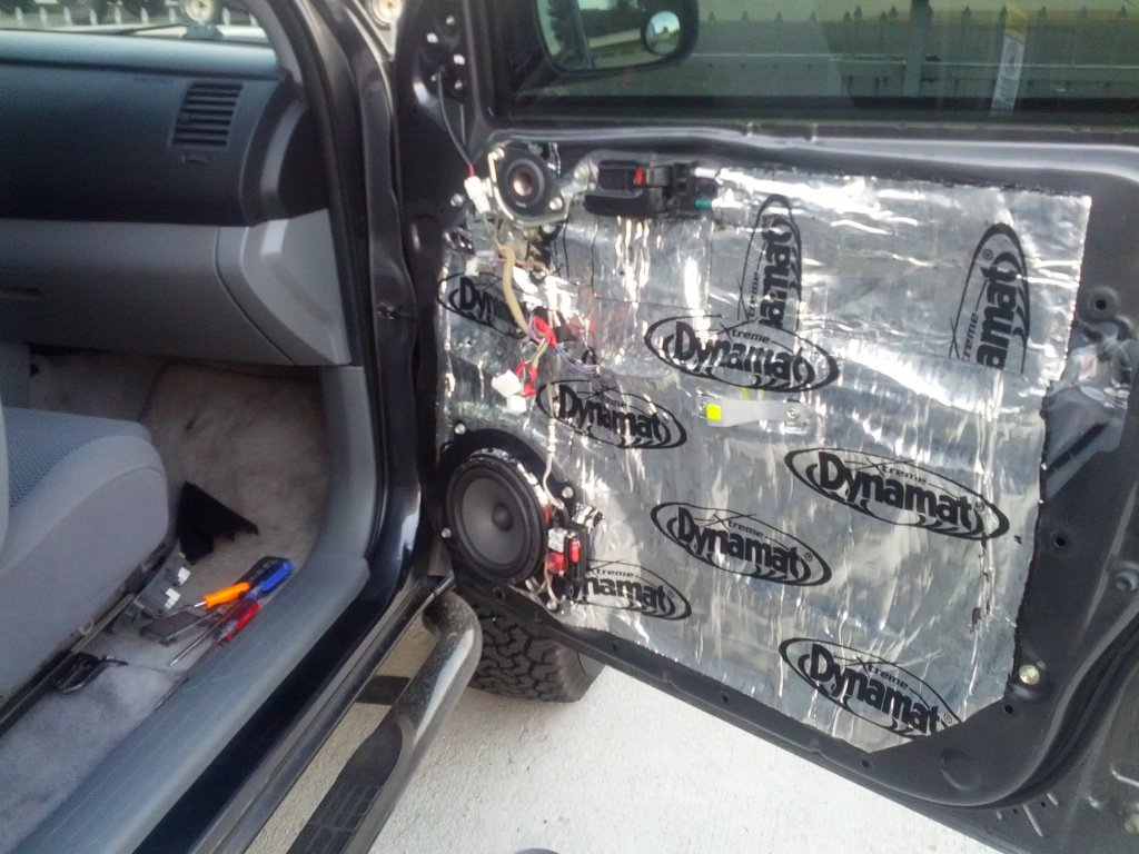

    Dynamat throughout - full enclosure on all doors, rear wall and floor
    JL Audio 500/1 Bass Amp under seat with JL bass knob control in factory blank
    Alpine PDX-F4 Digital Speaker Amp under seat
    Individual 4 Gauge power/ground for each amp with 100amp ANL fuse blocks
    JL Stealthbox loaded with two 10w1’s
    Focal Polyglass series 6.5 components in front doors with custom mounting brackets
    Focal Polyglass series 6x9 coaxial with custom MDF spacer in rear doors
    All Speakers are rewired – no factory wiring used
    Time Corrected Acoustical Tuning for optimal driver seat sound staging

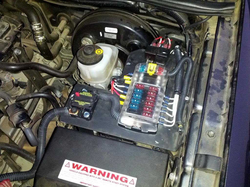

    ELECTRICAL:
    BlueSea 12x12 fuse block on custom panel and 100amp circuit breaker
    Blue Sea ML-ACR Automatic Dual Battery system with interior rocker switch control
    Suaoki 50w flexible solar panel on roof rack
    *coming soon* Renogy 100w Solar panel
    20amp digital solar charge controller with LCD display
    Group 35 Die Hard Platinum AGM
    Group 25 Odyssey AGM
    OffGrid Engineering side-by-side dual battery tray
    OTRATTW custom switch panel
    Electrical Panel in bedside with 2 12v outlets and voltage display
    *Pending Install:

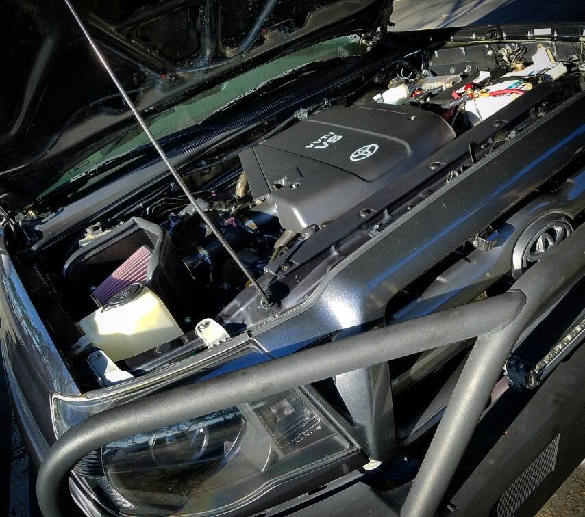

    Airflow Snorkel
    Magnaflow 14” muffler
    Exhaust dump after axle
    Mobile 1 Extended Performance 5w30 oil and filter
    Mobile 1 full synthetic 75w90 rear differential gear oil
    EBC 3gd slotted/dimpeled rotors
    EBC 7000 series green stuff pads (Recently changed to 'Stop Tech' pads)
    Ultra-Gauge EM 1.2 upgraded to MX 1.3 for trans temp
    Fumoto F103S series M12-1.25 Oil Drain Valve
