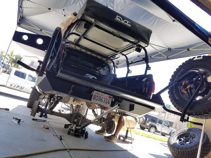

    Swapped out leaf springs, ujoints, and both inner & outter tie rods today

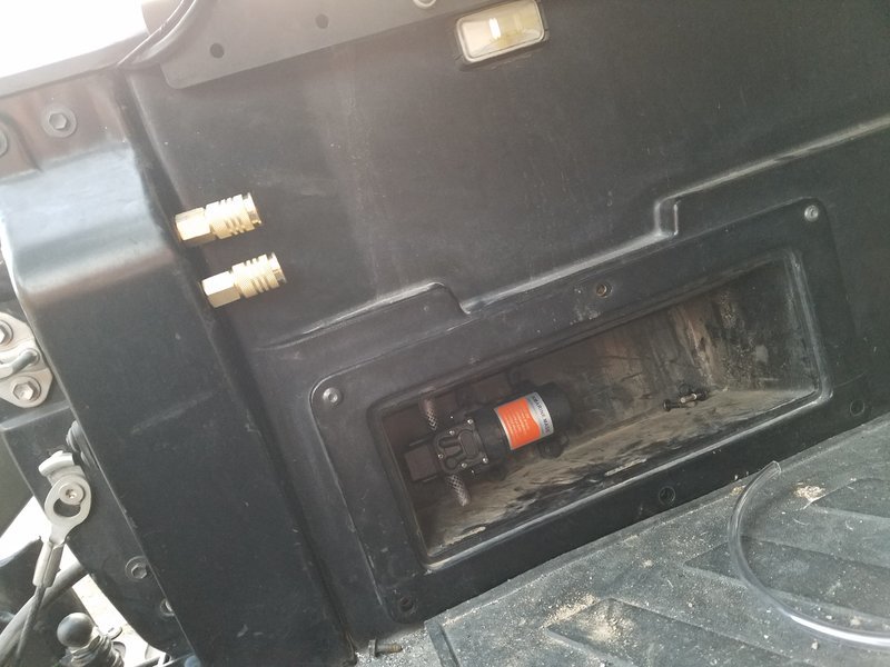

    On board water setup in the works!

    Ill have to make a video and post it. Basically i have two 2 gallon Rotpax mounted just near those disconnects. I retrofitted the rotopax caps to also have a quick disconnect valve on them with a pickup line on the inside. When its time to use the water, i have 1 line that plugs into either of the rotopax caps and into the input line from the pucture. Then the output has a 20 foot coil hose that pkugs in with a spray nozel at the end. It takes about 10 seconds to set up or take down. No need for a switch since the water pump has a pressure sensor on it and shuts down when 35 psi is reached, or essentially when there is any back pressure. Total cost was $20 for the pump, $10 for new rotopax caps and vents, and about $40 in misc hoses and fittings. Install took less than 1 hour. Video to come

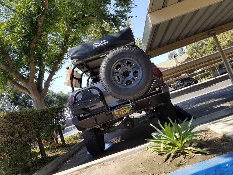

    In the mean time, new plates cames in :)
    Built 2 Camp
