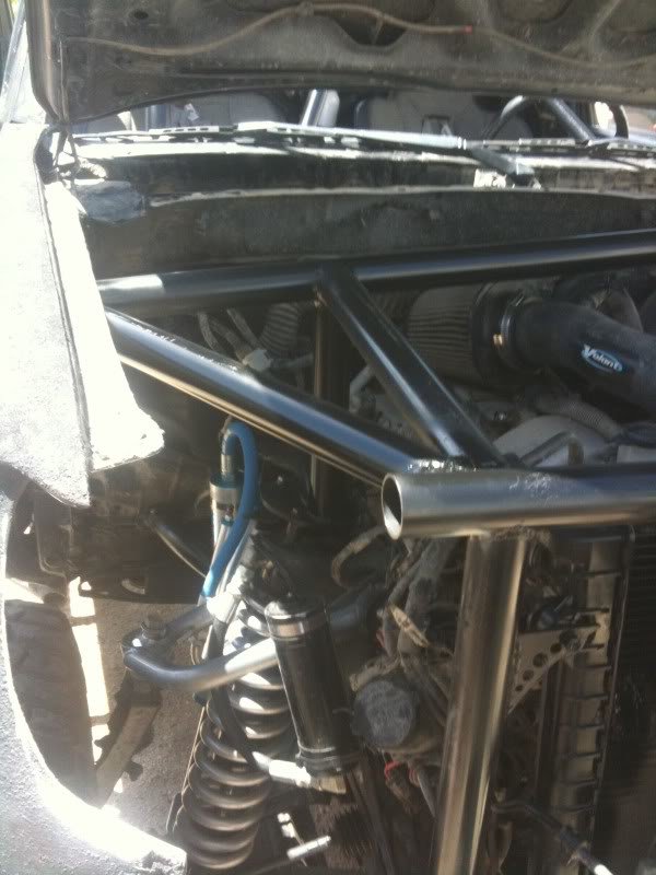

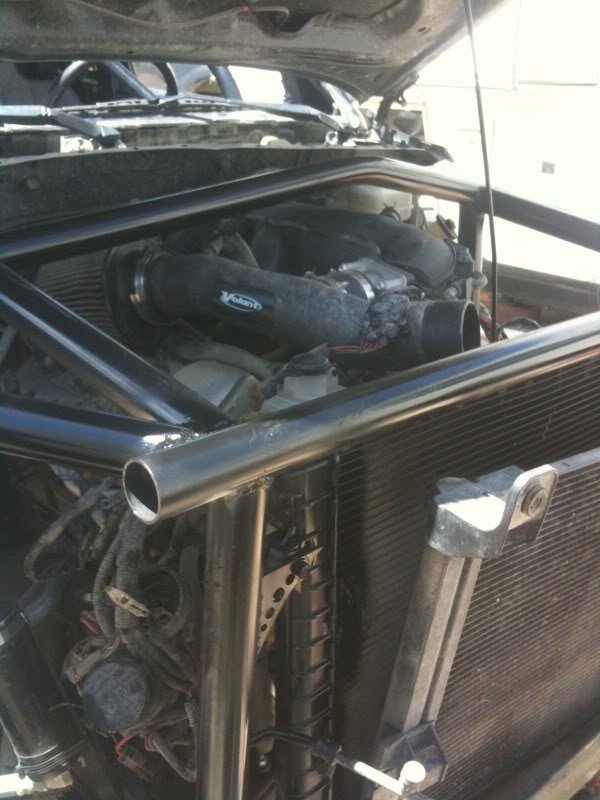

    Awesome build, pics of how the fenders/radiator etc are mounted with core support removed? And i read somewhere you were using the affordable bender for this whole build?
  7. Dec 30, 2014 at 6:50 AM
    #207
    username
    username [OP] Fluffer
    Oct 15, 2010
    #44704
    6,064
    Pendleton, Or
    05 Taco with some crap welded to it
    mostly stock
    I don't know that I have pics of how everything is mounted. Pretty simple, I just built a frame around the radiator and welded some gussets on to hang everything off of. The fenders are just hung off of tabs, nothing fancy. I did use the affordable bender for the whole thing, and it shows. It is very difficult to match bend angles with. After I was done building this I gave the bender to a buddy, who built another truck with it. If you can afford a better one, get it, but if you only do small jobs, it works.

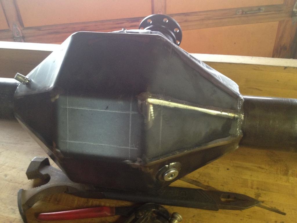

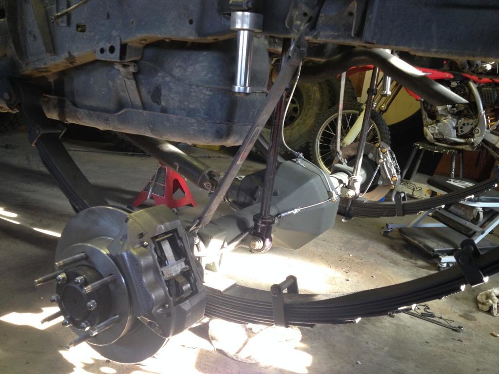

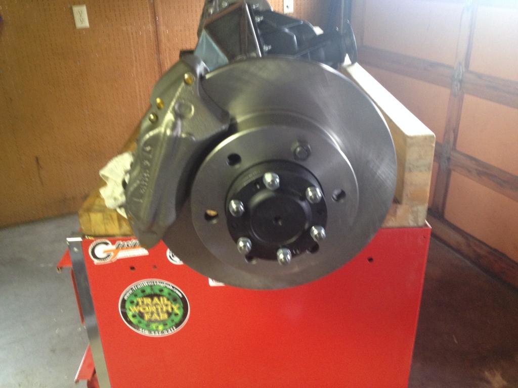

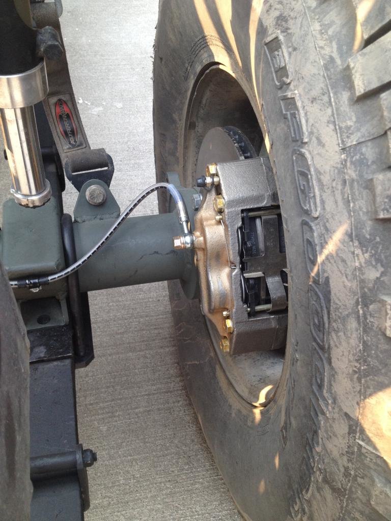

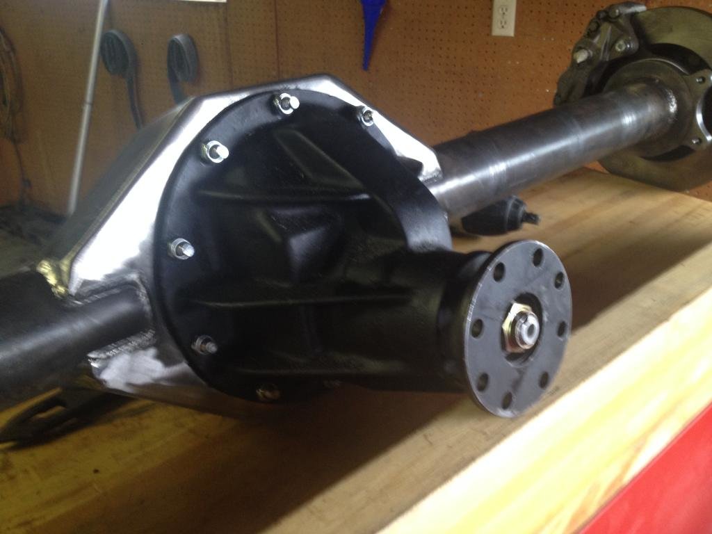

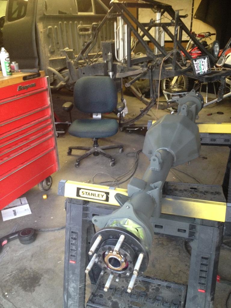

    Have any more pics of the rear axle?
  16. Aug 18, 2015 at 2:40 PM
    #216
    username
    Oct 15, 2010
    #44704
    6,064
    Pendleton, Or
    mostly stock
    6EDCDB5F-CF09-4CE3-88A1-4F319985EEF5_zps_9ac8f619cd42c8ccf26e103af93f0c4cd4ba819b.jpg
    0552DA2A-D9FE-44A5-885F-19F75871F2AB_zps_34eaa9f418a726efa8410db2e3640c1ea7bf278c.jpg
    AEA44682-B6AB-409C-86EC-5F692F84B784_zps_7439822c64812d44b3147ef8c3b7f123a3437c3b.jpg
    E4318610-13FC-4A55-8D26-163A0C185F36_zps_4c3f911782742550bfc00f8c33570398378a6814.jpg
    13CF0433-1AEC-452D-A274-960E3C470684_zps_6a7aac69247608da9a46c216345ae836014b1073.jpg
    F9913006-50A4-4A7F-9B75-9D84F48D64E6_zps_3a9639474517334125b887ce90c7d848a5c15a56.jpg
    XPOTRON, Large[QUOTED] and Crom like this.
  17. Aug 19, 2015 at 3:48 AM
    #217
    Large
    Large Red
    Sep 10, 2011
    #63268
    22,457
    Thank you, I remember reading somewhere you said you were in about $5k .. is that pretty accurate? With the R&P, disc brakes and locker?
  18. Aug 19, 2015 at 6:37 AM
    #218
    username
    Oct 15, 2010
    #44704
    6,064
    Pendleton, Or
    mostly stock
    That is accurate. The complete Diamond Axle was $4700 with a detroit and 4.88's, 30 spline axles, and the brakes installed. It also came with spring perches, but shock mounts were on me as well as brake plumbing and the prop valve. If I did a lot of highway trips I would have went with an ARB locker instead of an automatic, but for what I do the detroit is the best thing since sliced bread.
