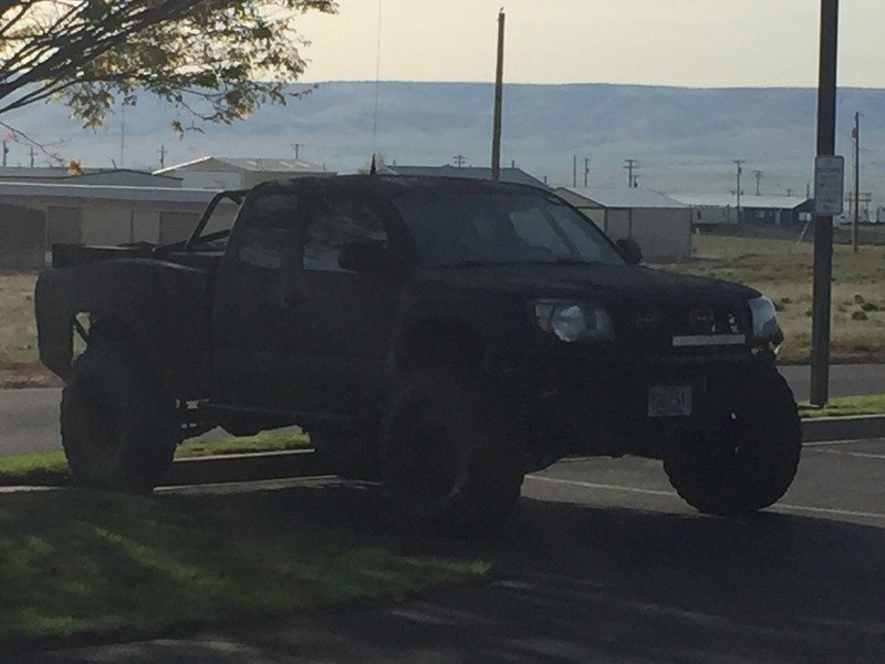

    4/6/2016 ;)
    B7569BFD-4A04-4D47-B981-FB0B8C4DC68E_zps_64870565226aa34bd696b67b36d7b612ba30a193.jpg
