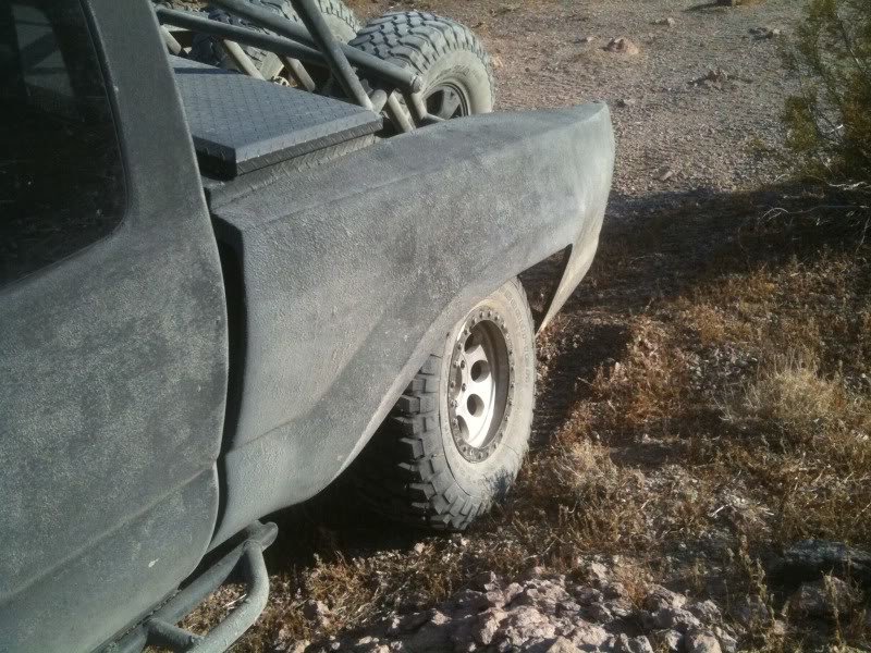

    Glassworks up front, fiberwerx in the rear. They were easy to install and I do like them. I slid into a tree and busted up one of the bedsides pretty bad, and it was easy to repair myself. They are surprisingly tough for as light as they are though...

    4". I had to trim them a little to stuff 37's though...so if you plan on big tires and a wide LT kit get the 6.5's. http://www.glassworksunlimited.com/20to20ta4fl.html

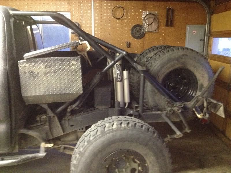

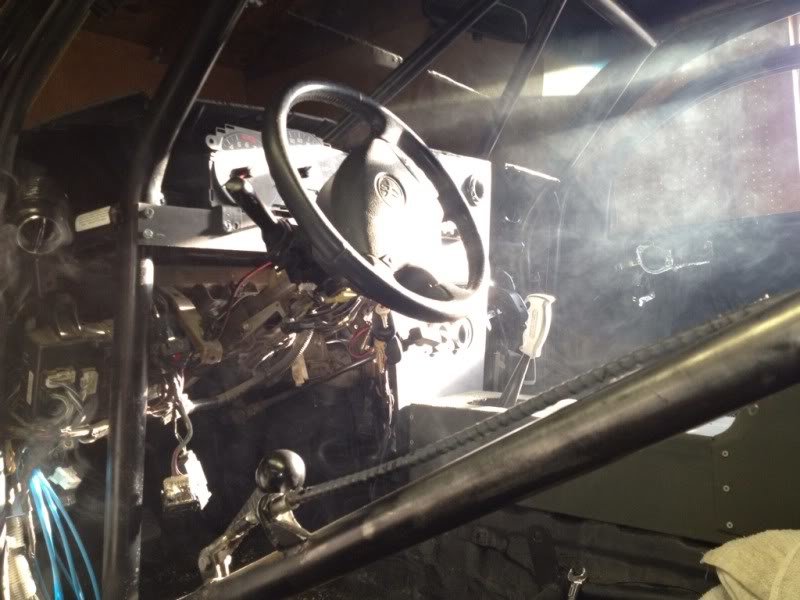

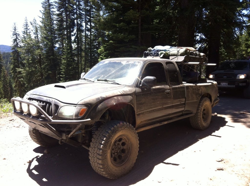

    Ya...it's not a very good one. I left out more than I put in. Like the transmission debacle, the clutch upgrade, the carrier bearing mod, the locker mod, 2Lo mod, governor mod, ARB locker ran on nitrogen (won't freeze), abs/trac/4wd/airbag/cat/evap deletes, fuel pump upgrade, and a bunch of stuff I forgot to remember. Ah well, what can you do. I'm still scratching my head on the next mod...I want a bed back. I want to move the shocks outside the frame and hillbilly engineer some sort of expo/storage system. We'll see where it ends up. Time to grab some crayons and start drawing...
    Time to cut the jungle gym out...
    I also have no idea how to finish my dash. I'm no good at Martha Stewart shit.

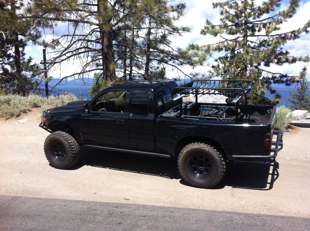

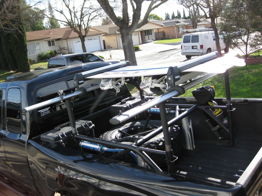

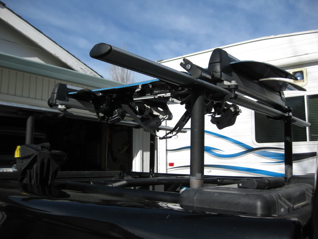

    Not entirely sure what your overall goal is (permanent or semi-permanent)...but if you're looking for ideas, here's my truck and how I did expo storage. Vertical tubes that sleeve into the bed cage held in place with some clips with several holes drilled for height adjustment and some cross bars. Can clamp whatever you need to on the cross poles, be it snowboard rack or roof basket.

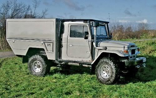

    That's an awesome idea! I like the idea of being modular. I also dig the pelican cases. I'm tired of having everything covered in mud and dust. I also had some crazy ideas...to build something like this out of some high R factor foam and wrap it in carbon/kevlar for strength. I think an arctic camper good to -40 or so would be cool, pardon the pun. The logistics of where to put the shocks and the fact that it would have to have huge cut outs to clear the tires (SUA=mucho uptravel) means it might not work....but it was an idea.

    My idea would be super light...so I could still huck it. They make boats with foam core and 'glass...why not make a camper? I dunno...with so much uptravel it would take away a lot of interior space. Stuffed my tires are about even with the bedrails...
    This was with 33's. (bedsides bulged 4")
    I like this a lot too, but tents don't work when it's ass cold out.

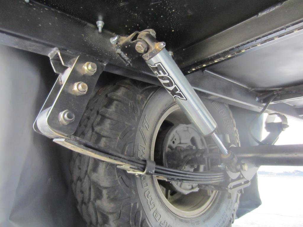

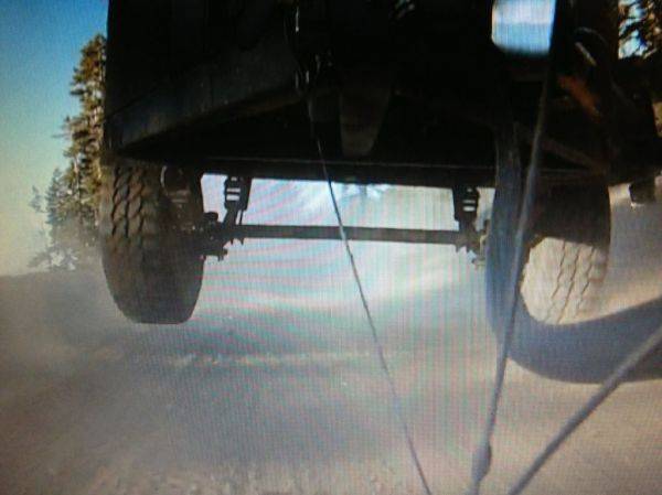

    Just build a trailer that can almost keep up...that's what I did :D

    That's fucking cool! Great idea! Hmm...and if I used an 05 axle I'd have spare parts too...and spare tires...Looks like you need slightly faster rebound...:D

    Yeah I actually used a custom 6 lug 3500 lb axle with the same bolt pattern, rims, and tires for the exact same reason.
    Still working on the valving. That was the first trip out.
    I've got a full stack of .008's on rebound, but they are just smoothbodies. I'm going to pull the last 1 or two rebound shims out completely and see if that helps. Running a flutter stack on comp with .008's also. Plan on swapping the last two high speed shims to .010s
