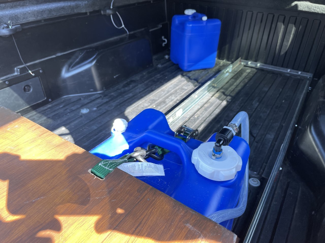

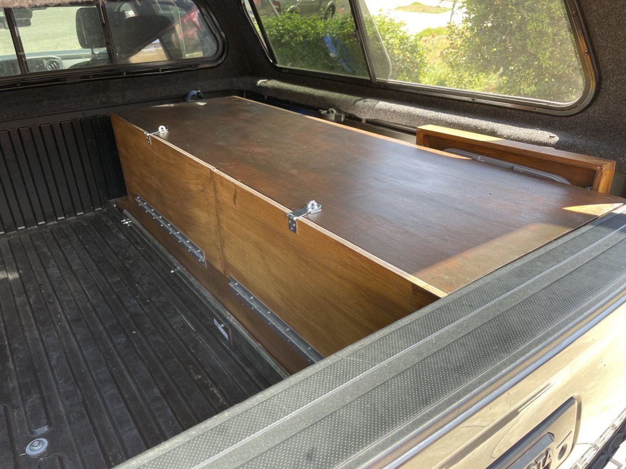

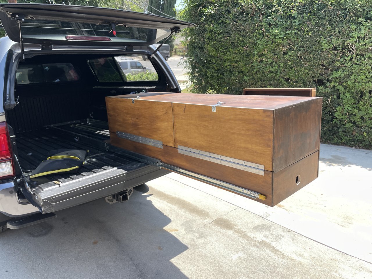

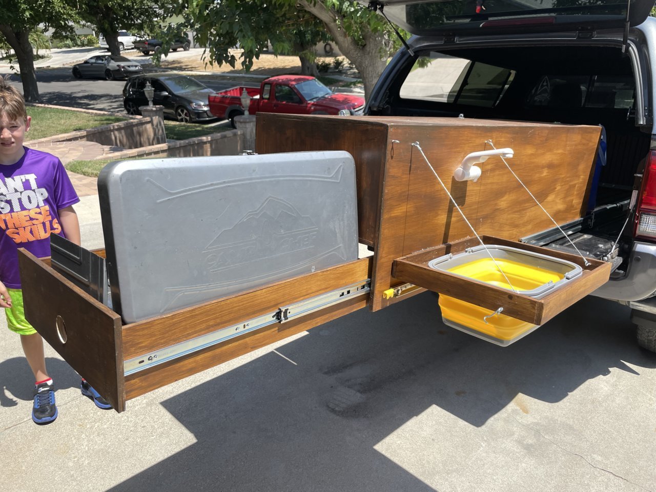

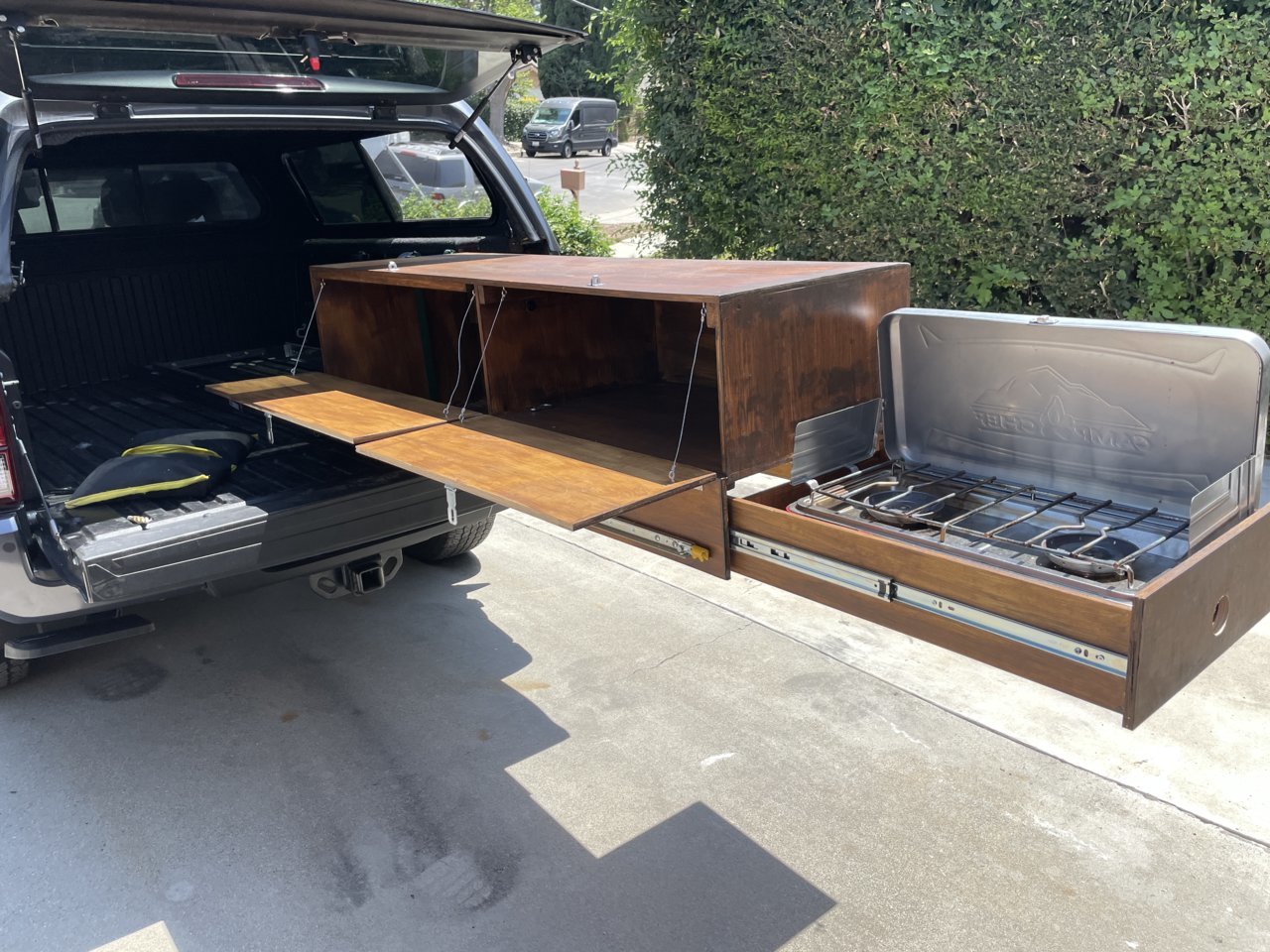

    Thanks to everyone in this thread for the ideas. I thought I'd post my build to give ideas to future builders as well:
    IMG_5079.jpg IMG_5080.jpg IMG_5081.jpg IMG_5082.jpg IMG_5083.jpg IMG_5086.jpg

    I like it, especially the folding sink that utilizes the space behind the wheel well. How difficult is it to refill the water canister? Can it be done via the sink faucet(pump in reverse) or do you have to pull the empty/fill/replace it?

    The tank is just held in with a tie-down strap, it's pretty easy to pull out and swap with a full tank. They are those 7 gallon aquatainer tanks you can get at dick's sporting goods.

    It just looks like an awkward reach with 55lb you can’t use your legs on but if it works for you, :thumbsup:

    Yeah it's really not too bad, with a camper shell I'm always having to climb into the back for everything else anyway.
    Though I do have one question regarding this faucet/water pump combo; is the pump always supposed to be loud? Whenever the faucet is on the pump is pretty loud, I wasn't sure if that was normal for this pump or if I've got something wrong with my setup-

    How did you install the slides in the Building the Base image? They look like they are resting on a metal plate of some kind which is drilled into the wood. Currently have mine screwed into 2x4s which end up eating space

    I am designing something similar. Your sink idea is genius.
