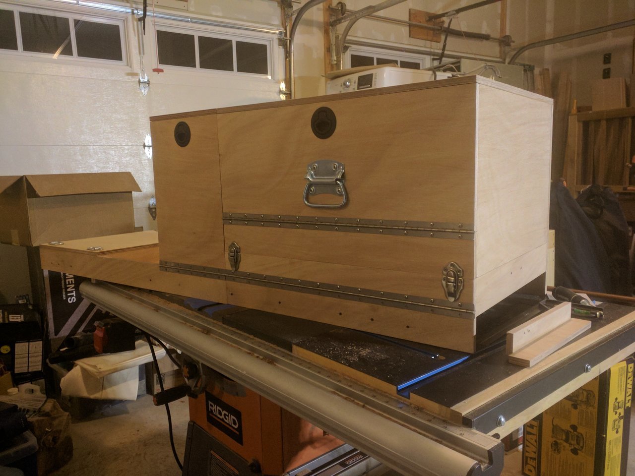

    Meant to post this last night. The lift handles make a huge difference! Finish line is in sight.

    Looking great man. Would love to see this made out of poly

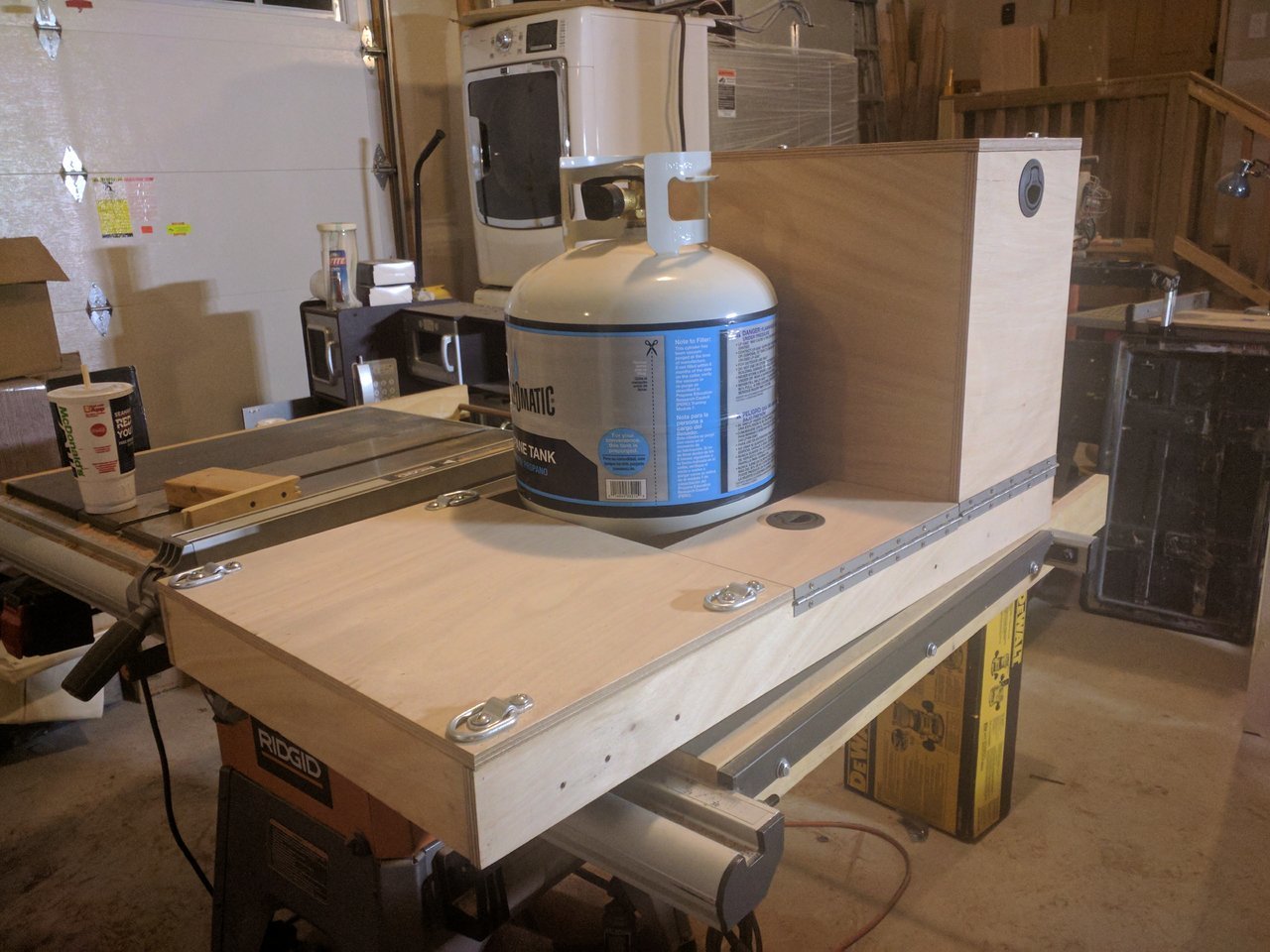

    So I finished construction last night. I added a little cubby to the propane tank tray. Since there's a hole in the side of the cabinet here to allow the hose to pass through, I wanted to cover it up somehow. I figured, why not make a little enclosure? In any case, here is the last progress photo. I've already dismantled it and (since she offered) my wife is applying the varnish.

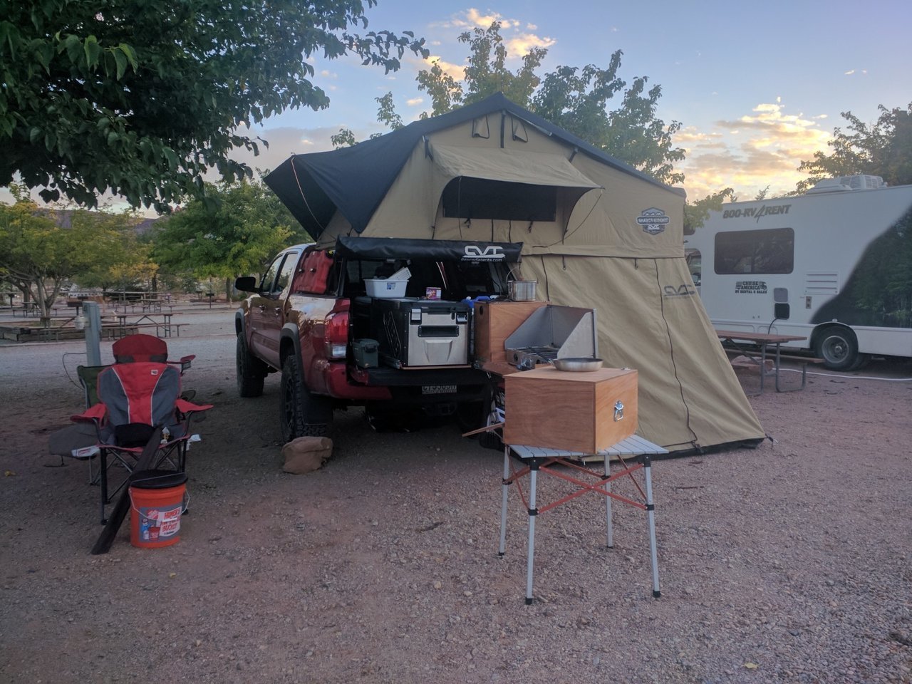

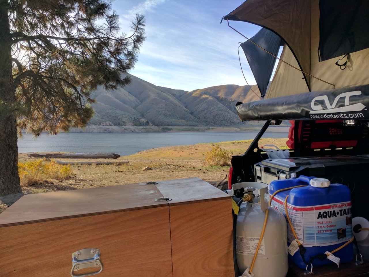

    Just got back from my trip. We had to cut a few corners to get the kitchen ready in time. But here are a few pictures to share. The water tank had not arrived by the time we were leaving (but I do have it now) so we had to make do with what we had: 7-gallon Aqua-tainer and 5 or 6 one-gallon jugs from the supermarket. We didn't use anywhere near that amount of water, so I may just install the 12-gallon tank and remove the water Roto-pax canisters to have a spot to hang my shovel again.
    Overview:
    The Front-runner utensil kit hangs nicely under the front of the stove box - very convenient.
    Close-up:
    I've learned a lot from my first trip, but overall I would say it was a HUGE success. The ease of setting it up is amazing. In less than 60 seconds, you could have a pot boiling and burgers frying. As a side note, the ARB Elements Fridge is awesome. It was pretty cold most of the trip (never got above 60-degrees on the "hottest" day and got below freezing one night) so I couldn't get a good sense of how much draw the fridge would need in "hot conditions" but it barely registered on the voltmeter in these conditions.
    Things I would like to consider in the future: Storage on the wheel-wells and sides of the drawer slides. Anything we put there became a nuissance we had to deal with when opening/closing the slides. I have some ideas about how to solve this problem, but the sense of urgency is gone now as the trip is over. Another issue was rain-water. The tray that holds the propane tank needed some drain holes that I opted not to do now. This would be fine if the truck wasn't moving, but water sloshing around back there made it's way into the fixed cabinet and some boxes got a little bath. Drain holes in the right spots should solve that. But I also want to add some weather stripping to the doors that I didn't have time to do this time around.
    Here are a few more shots of it in action (above photos, plus this one were taken in Boise National Forest):
    Our last night (in Utah, near Arches) we opted to camp at an RV park (to use the showers and save some campsite-hunting in the dark). We had some kitchen admirers come and take photos while we were there. :D
