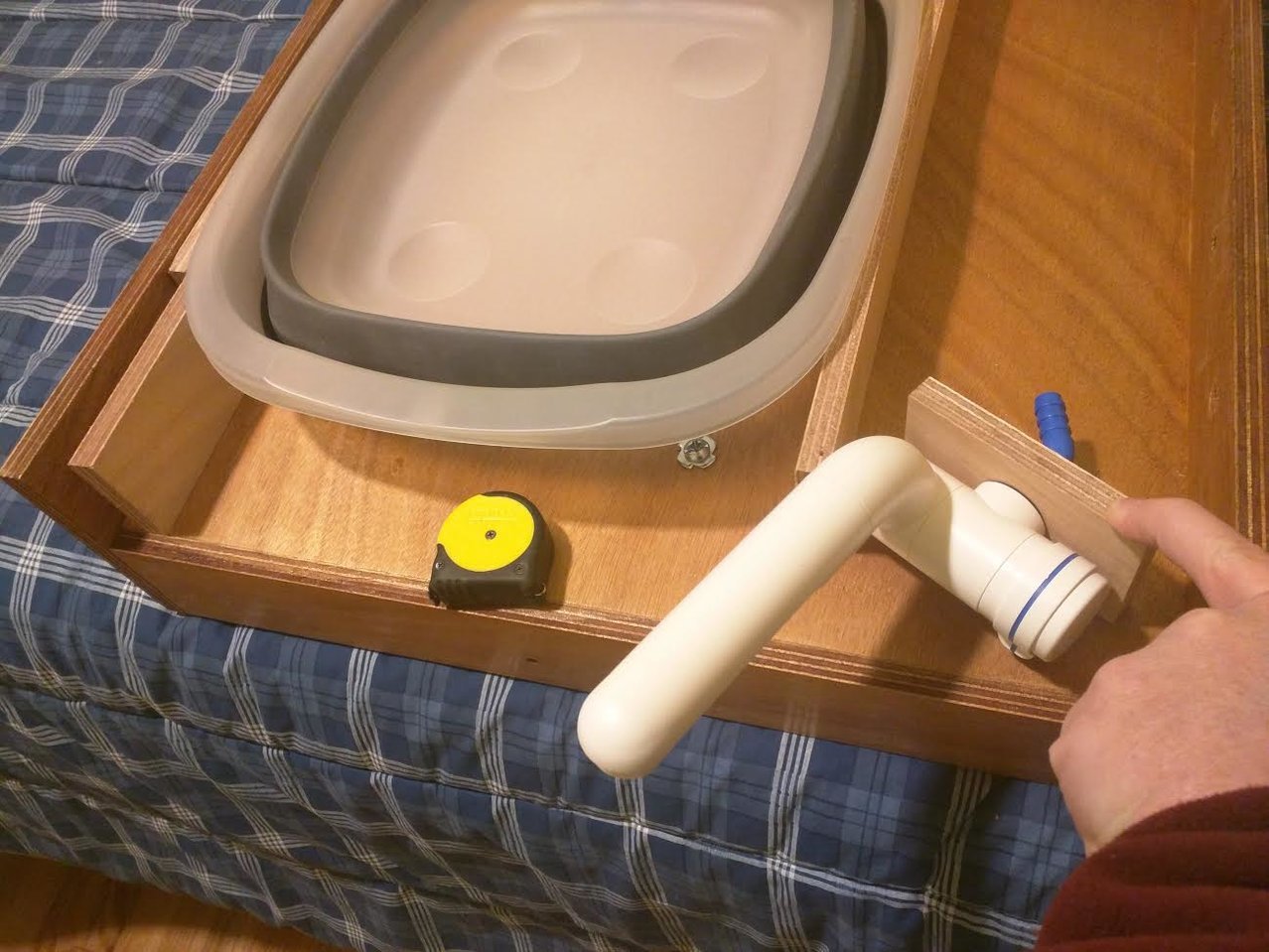

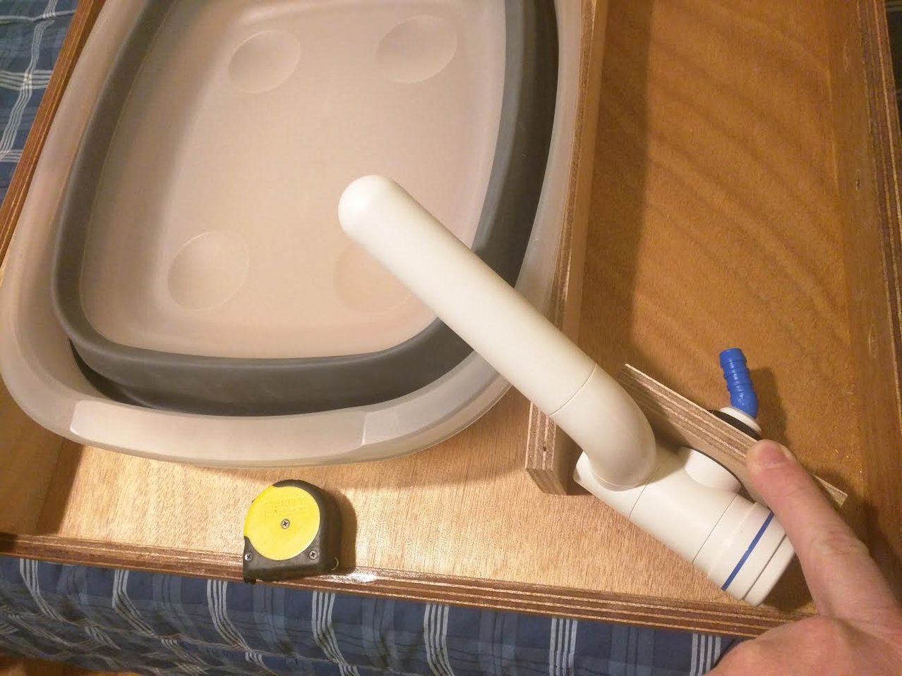

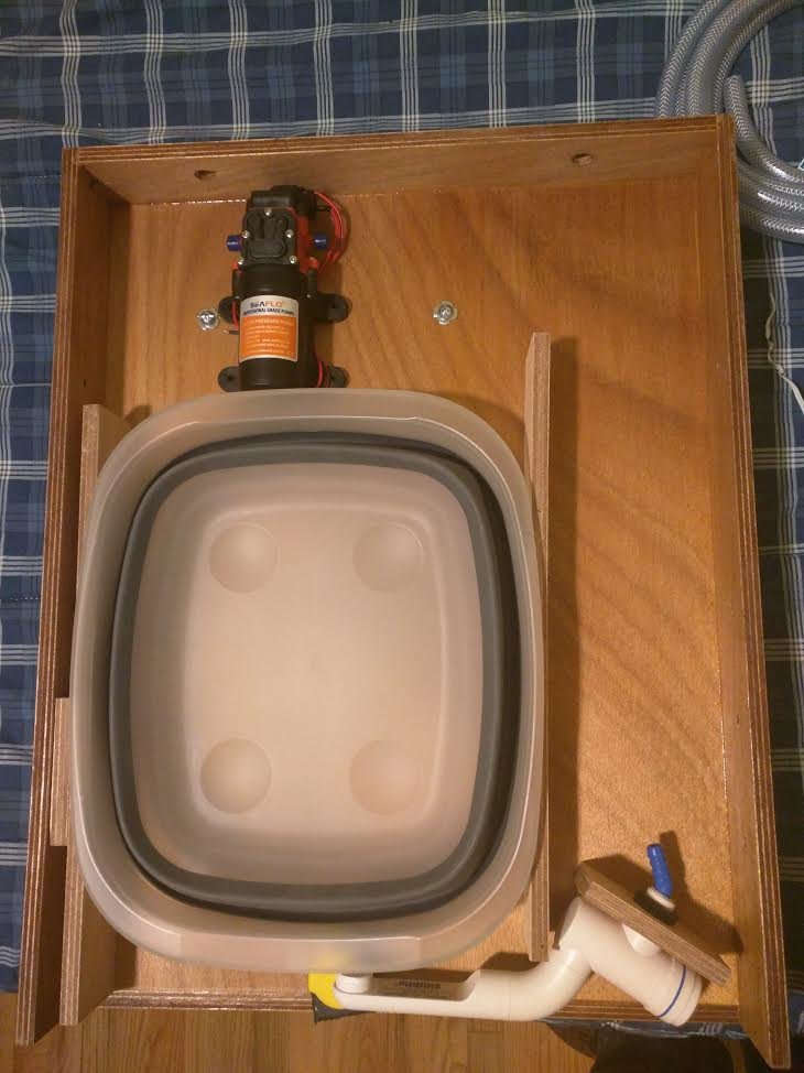

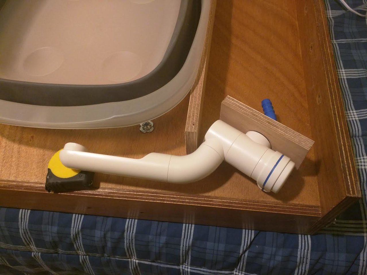

  16. Dec 23, 2017 at 7:11 PM
    #136
    Arlaghan
    Arlaghan [OP] Well-Known Member
    Dec 5, 2016
    #204138
    495
    Alex
    Redmond, WA
    2017 Red TRD Off-Road
    Alright, now begins the fun part. Designing how I want my sink pullout to work. I'm trying to incorporate a couple of "wants":
    1. Removable/Collapsible Sink - Bought two of these, but I think I'll only use one.
    2. Faucet to be convenient to filling the sink
    3. Faucet to be convenient to washing hands off the side
    4. Bonus if I can store everything in the pullout
    Underneath the cook-top, I have about 2-3/8" of clearance. (There's a smidgen more because of the clearance to the kitchen base, but not a whole lot.) So, everything needs to tuck away into that space. The collapsible tub is approximately 15x12 so I only have about 4 to 4.5" of width left to fit the plumbing. Another challenge to deal with: It will pullout about 16" so I need to make sure the braided tubing can accommodate that. Here's what I've come up with mocking things up:
    The idea here is to build a "base" that the sink will recess into. Then, in the space to the right, the faucet will mount so that it can be tucked away as shown above.
    The photos below show the faucet oriented in the various positions.

  17. Dec 24, 2017 at 10:29 AM
    #137
    bagleboy
    bagleboy Well-Known Member
    Aug 5, 2017
    #226018
    7,264
    Scott
    Norcal, Santa Rosa
    2014 5-lug AC 2.7L VVTI
    Snug top Rebel, Thule tracks, ditch tracks, Bagged rear suspension, F/R anytime camera, intermittent wiper switch...
    Cool, it looks like you could hinge that piece Along the upper edge to give it a bit more clearance on the outside. It's nice and simple as it is but you might find yourself wanting a bit more space under the output when it's over the sink. A hinge could do both.

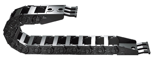

  18. Dec 24, 2017 at 4:02 PM
    #138
    Arlaghan
    Dec 5, 2016
    #204138
    495
    Alex
    Redmond, WA
    Okay, this is proving more challenging than I anticipated. The challenges I'm facing are having a place for the wiring and the tubing to be able to pull out along with the sink/faucet. I have some plastic drag chain for the wiring, and 16" of movement isn't a lot to worry about, so I think that part is solved. But the tubing... :notsure:
    I'm trying a few ideas in Sketchup to see what works and what doesn't. I'm thinking having the pullout full-width of the cooktop cabinet isn't going to work. I need a "fixed" channel where I can run the drag chain(s) (I'm considering one for the tubing as well) or just a place the tubing can sit loose with enough room to be pulled out.
    For those wondering, this is drag chain. One end is fixed (upper cabinet). The other end is attached to the moving part and it rolls, protecting the cable or tubing contained within. I'm also planning to do something like this for the power cord of the fridge.

  19. Dec 24, 2017 at 6:00 PM
    #139
    bagleboy
    Aug 5, 2017
    #226018
    7,264
    Scott
    Norcal, Santa Rosa
    Won't some coil hose fit?
