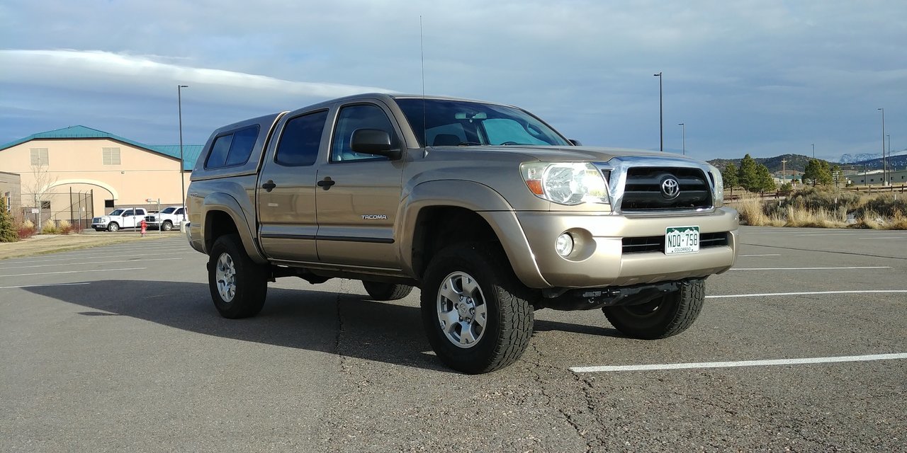

    Not sure if this will be too much if a "build" thread. Maybe more like documenting mods to get rid of the stockness.
    My phone killed itself, so I don't have any pictures of when I bought it a couple of months ago. Just a stock 2006 double cab TRD 4x4 V6 with 102,000 miles and not a scratch on it and the ugly old man gold color, but it's growing on me. First thing I did was remove the running boards and mudflaps. Next I took off the tonneau cover because I think they are the dumbest thing you can ever put on a truck. I replaced that with a topper, because the 2 kids take up the back seat space, and the dog and all our junk needs to be out of the elements. Plus I'll sleep back there when I camp without the family.

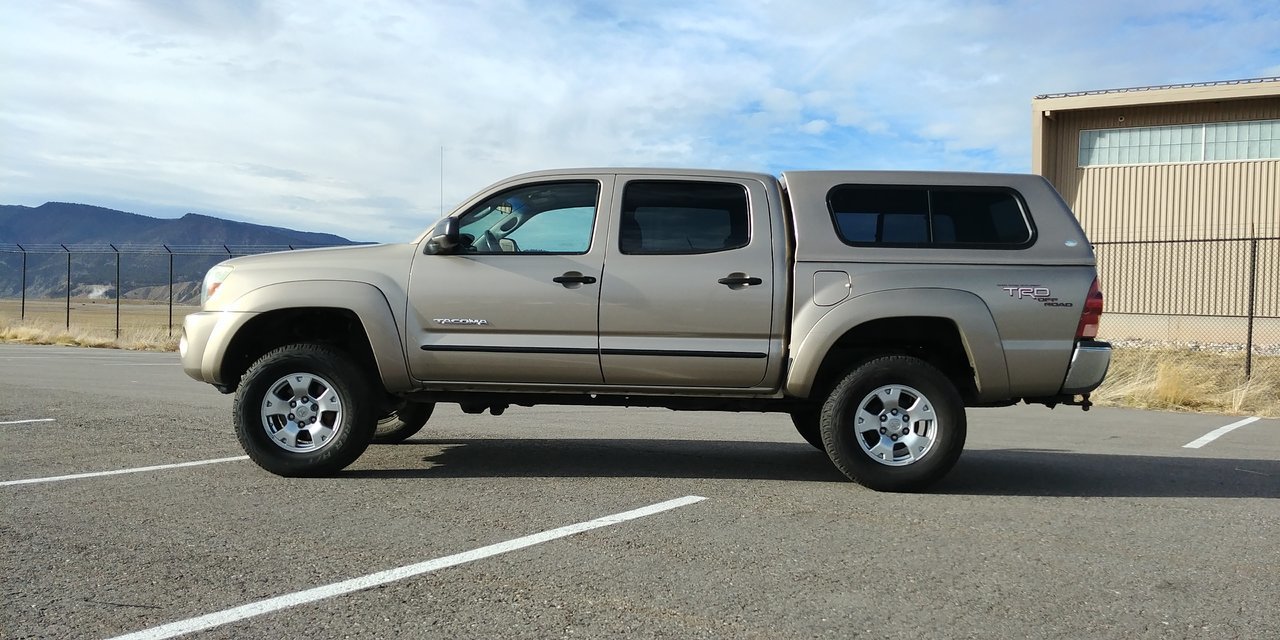

    Which brings me to where it is now. Last Saturday I put my bilstein lift on. I have used the same set up on vehicles in the past, so I know it works. I got it from Headstrong off road and the price was good and shipping was fast. I chose to go with the 5100's all around and OME 887's as I plan on putting an ARB bumper up front. I put an AAL in the rear, and the dealer I bought it from did the rear spring recall for me before I picked it up. Needless to say, it looks and rides way better. I have to wait until Monday to get it aligned because we live in a small mountain town and not a lot of options. Now I jave to decide on 265 75 16's or 285 75 16's. Tough decision, but I have to do it today to take advantage of the black Friday deals.20171120_144223.jpg 20171120_144236.jpg 20171120_144223.jpg 20171120_144236.jpg 20171120_144320_HDR.jpg 20171120_144343.jpg

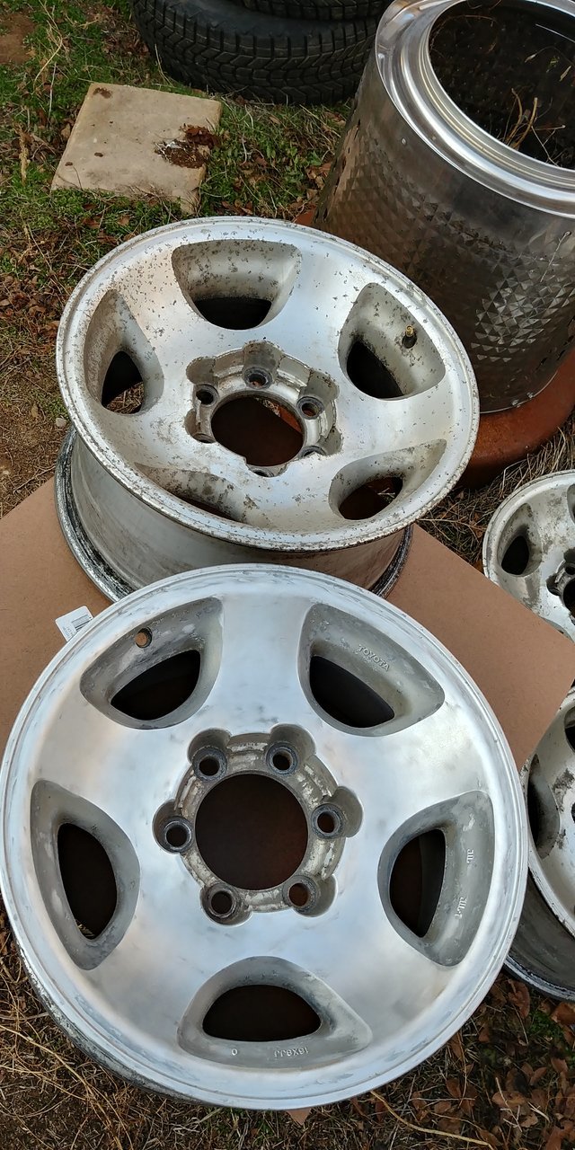

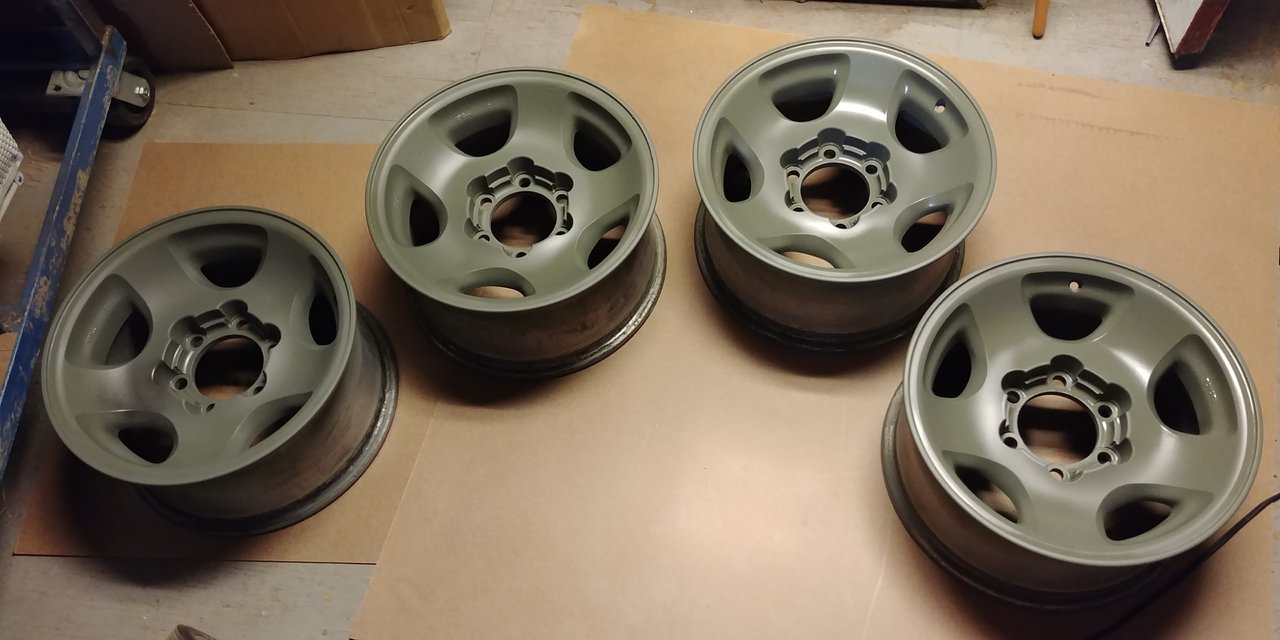

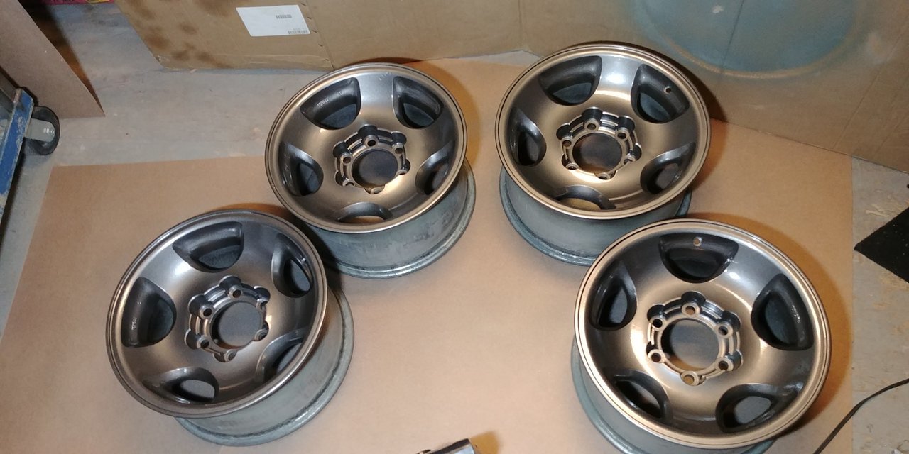

    So, I've run the FJ80 wheels on a couple of rigs before. I had them on my 99 4runner and my 01 Tundra. I like the look and they can usually be found for pretty cheap. I got this set with for $125 with snow tires on them which I ended up selling for $150. They wheels were in pretty rough shape, and they looked like they had barnacles on them. I wire wheeled that and most of the factory clear coat. Primed and painted them, and they ended up looking pretty good. 20171125_161116_HDR.jpg 20171126_173158.jpg 20171126_194936.jpg

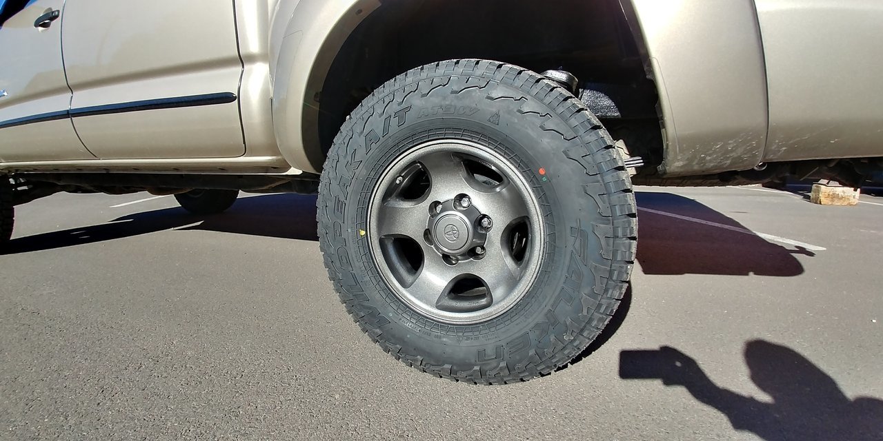

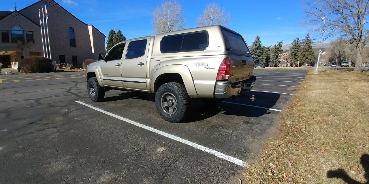

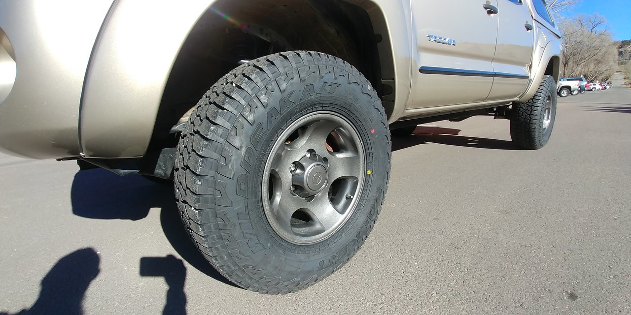

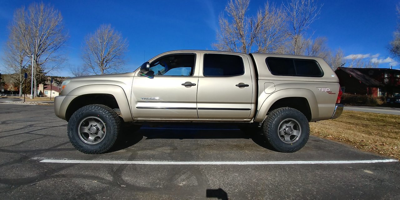

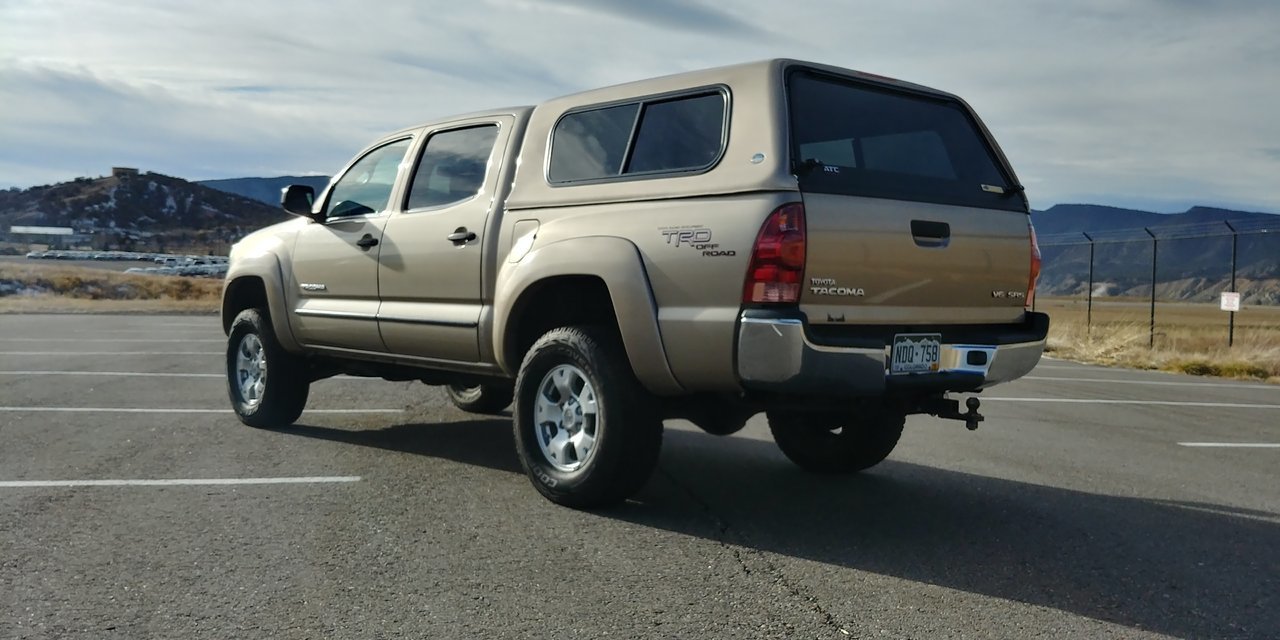

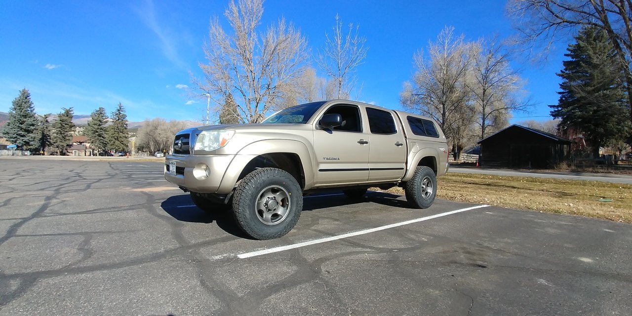

    I the tires mounted and balanced Friday afternoon and put them on Saturday morning. I'm pretty happy with how it looks and drives. Although I'm still not totally impressed with the Falkens. The wheels are 16" x 8" and they almost look too wide for the tires and the tread isn't really that wide. Not really loving these tires. I guess I just should have gotten the 285 BFG all terrains as I was originally planning. But they're on and I'll run them for the winter. All in all, I like the stance and look the truck has now. I did have to use a 1/4" spacer I had laying around because the front wheels were touching the calipers. I ordered my ARB bumper and can't wait to get that on.20171202_122456_HDR.jpg 20171202_122441.jpg 20171202_122358.jpg 20171202_122042.jpg 20171202_122013_HDR.jpg

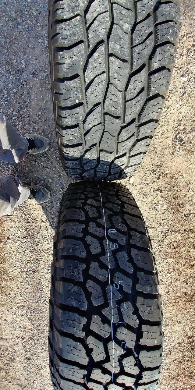

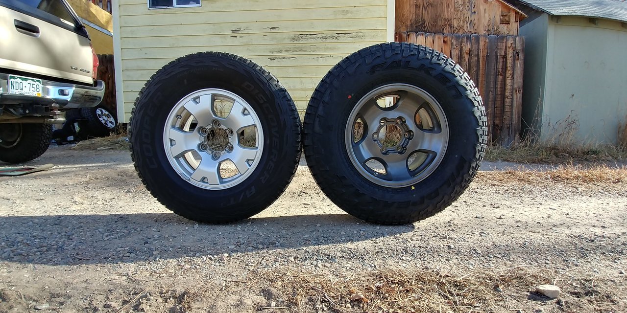

    20171202_105228_HDR.jpg 265 70 Cooper Discoverer AT3 on left, 265 75 Falken Wildpeak on right.
    MarX and Yukon like this.

    20171202_105249_HDR.jpg Comparison of the Cooper vs Falken tread width. The Falkens aren't even as wide even though they are on an 8" wheel.

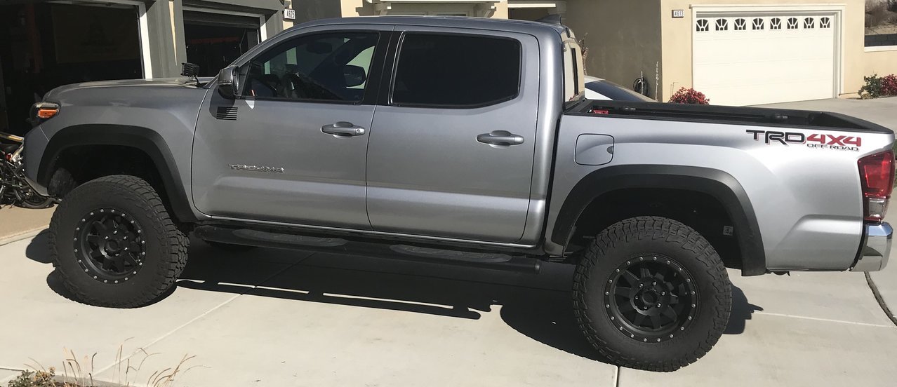

    Looking good. Like the FJ80 wheels! Good to see another old man tan Taco on here. The ARB Bumper is going to look good! I love mine!.
    Greeny and chilitoy[OP] like this.

    Looks great man dont stress the falkens they are great tires and will perform good. They look killer on your truck. I know your partial to the coopers but the pics look awesome

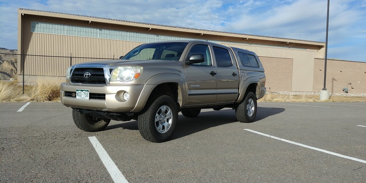

    Looks good! I ended up going with the older version of the bumper because i like the classic look of it, although having an option for lights made it hard to decide which to get. I will most likely replace the blinker with an LED fog/ off rad light. I am waiting anxiously to get it. It Definitely makes the old man gold seem a little less..... Uh mature, on your truck. Thanks for posting.

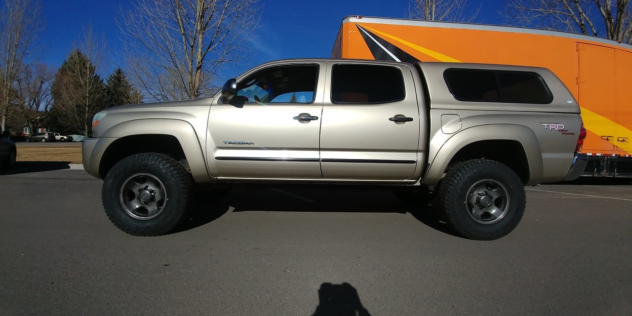

    Good looking truck, I did pretty much same lift went with 265's and glad I did. Must admit wanted 285's lol. Did you do UCA's?
