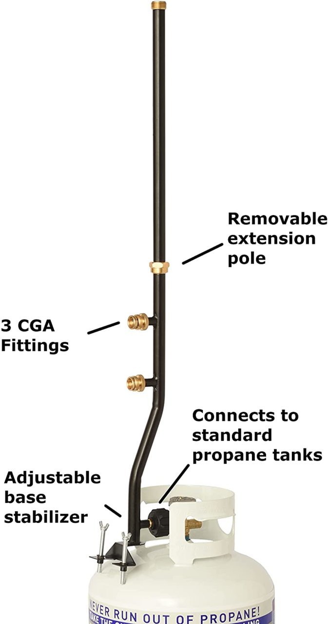

    When I camp I run a distribution pole attached to the top of the 20lb tank. It has 3 outlets including one on the top that is perfect for screwing a lantern into. I run a latern on top and a 10' hose for my Big Buddy heater (to reach inside my tent) along with a 5" hose for my stove. The lantern on top is like having a street light in camp.

    Wow! Brilliant. How are you strapping/are you strapping it to the bed rail?
