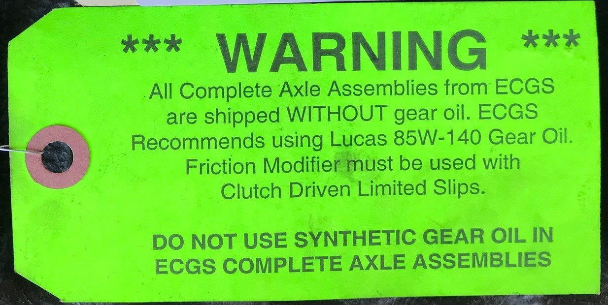

    From that ECGS link: "ECGS RECOMMENDS LUCAS DINO 85W140"
    Interesting that they don't discuss different weights for different trucks and applications. Correct me if I'm wrong but 85W140 is not for daily driving in a 1st gen Tacoma (like you pointed out)

    The fact of the matter is LUCAS 85W-140 dino gear oil is what ECGS/Chase Perry recommends. Chase is very well educated on the subject of gear oil and his professional opinions have been earned. Further, using multi-weight 140 gear lube is not a new concept. We started using multi weight 90W-140 gear oil (all dino IIRC) back in the '60s/'70s to increase the durability of some marginally designed rear diffs. such as the Ford 8" axle in most early V8 Mustangs and the GM 10 bolt axle in some early V8 Camaros. The marginal ring and pinions started blowing once the HP number climbed up. We all eventually had to install larger, more durable rear axles such as the Ford 9" and the GM 12 bolt. But using the 90W-140 gear oil available at that time worked surprisingly well as a stop-gap measure. We got the idea from a Pro-Stock racer who endorsed using 90W-140 gear oil in most all diffs. Most of the Dodge muscle cars & 4WDs came with ultra-strong Dana 60 rear axles so they did not have to deal with this headache. But I also used 90W-140 in the Dana 60s as did that Pro-Stock racer. Even when I was running Amsoil in this '97 V6 Taco 4x4, I was using Amsoil 75W-140 in both diffs. and the Tcase. But the rebuilt R150F tranny does get the lighter weight Lucas dino gear oil. And it has been the same for every single 4WD I worked on/owned since the '70s: M38/M38A1 military Jeeps/one straight 6 and several hopped-up V8 CJ5s/V8 Box Broncos/super-high HP small & big block K5 Blazer 4x4s/Chevy 4x4s/Dodge 4x4s/and finally the 1st Gen Tacos which I rate at the top of the heap for durability in a 4WD. Bottom line for me: I trusted ECGS to build my front diff. so I will definitely follow their written instructions on which type gear oil to use. IMO, it would be very foolish to do otherwise. ECGS wants to be sure you get their word on gear oil, so they attach a tag to the diff. spelling it out (below). ECGS/Chase also has a very poor opinion on most synthetic gear oils as evidenced on the same tag. My experience with several synthetic gear oils mirrors his. If you want to argue gear oils, call Chase up. But you had better be packing a PhD in something technical because Chase lives and breathes diffs., and Lucas 85W-140 dino gear oil. .02

    This! Every time I go into autozone I grab every quart of Lucas 85w140 they have to stock up. Wife thinks I have an addiction :D
