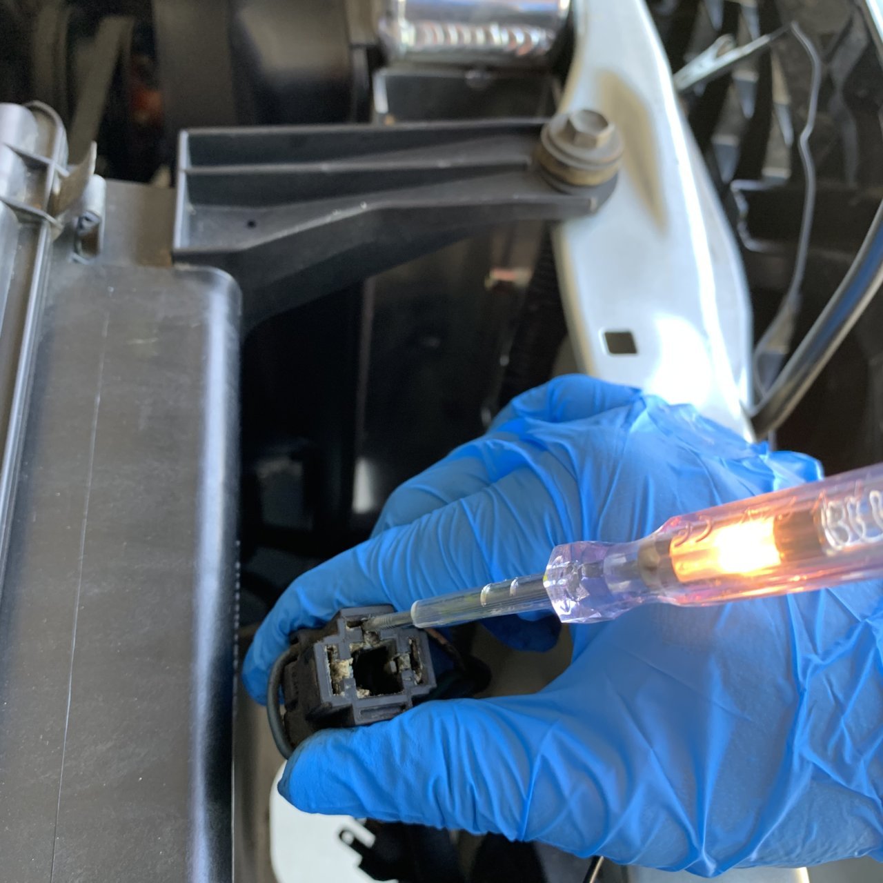

    So I follow the instructions on how to check for ground switch. Not sure if the 2nd gen Tacomas sockets are different but it mentioned checking the left side connector (vertical) for power. However the connector I got power from was the top connector (horizontal). So if my left side connector (verticals) has no power but my top connector (horizontal) does have power does that mean I have ground or conventional.
    I also read that if I have factory DRL, which I do since I pulled the DRL (white/green) pin from the relay to disable them, then I must have a conventional plug?

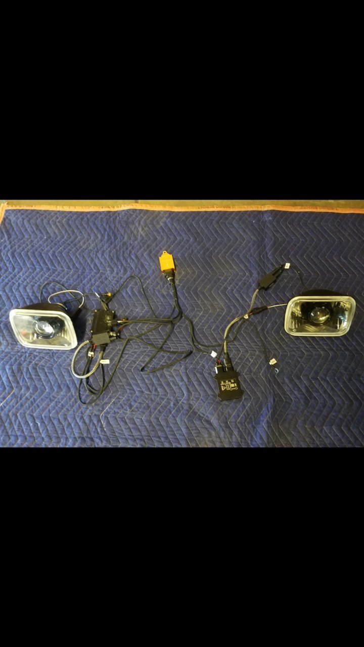

    Just finished this swap with the 7x6 headlights into a glass and metal bucket.
    A world of difference, used the mini h1 7.0,
    Only issue is matching up the horizontal beams is extremely hard to get perfect because it has to be done by loosening the set nut on the bucket and tighten it, trial and error.
    Otherwise probably the best upgrade
    D2 are probably better if you can get them into your light housing.
    They would not fit in the 7x6 bucket for me.
