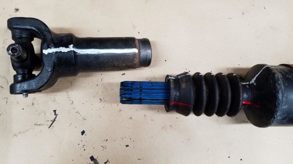

    That's what I use. It has 65% moly- the typical moly fortified greases only have a few percent. It's enough to last a lifetime and more if you only use it for the splines. I primarily use it on puller screw threads.
    Edit- here's mine with 110K miles- pretty dry. I took both clamps off, but you only need to remove the larger one. You can reuse them if you're careful- I did. I couldn't find any replacements locally but Napa said they can order them

    Splines and screw threads are extreme pressure interfaces- this is where moly excels because the moly particles are left behind to lubricate as the carrier agent is squeezed out. IIRC, Dana says NGLI 2 grease is ok, and anything is better than nothing. If you google it, you'll see that spline drive lubrication is a big issue on motorcycles and high percentage moly, >60%, is what the manufacturer's recommend.
