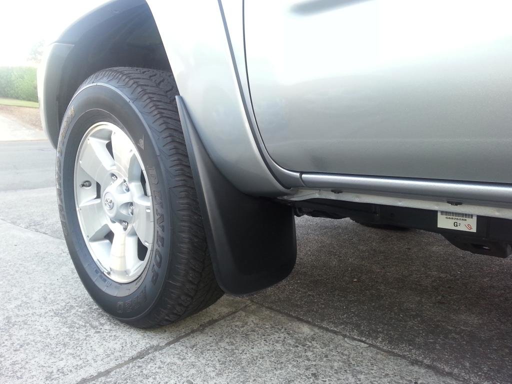

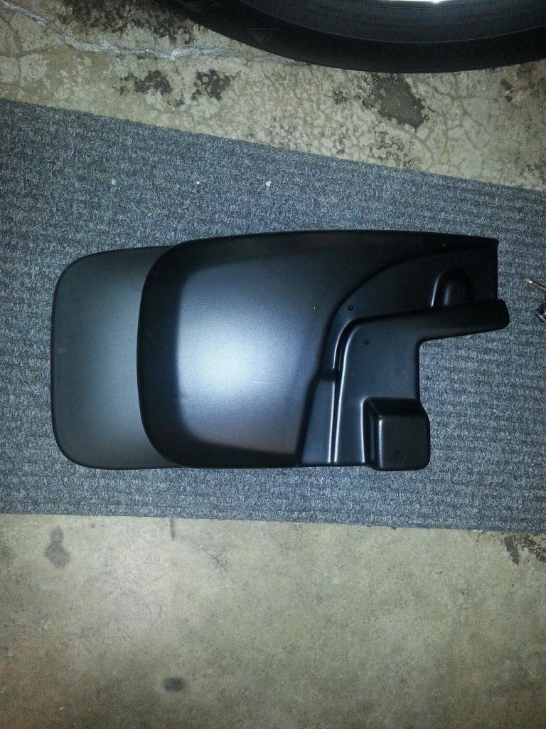

    Got my Husky front flaps yesterday...I had them for 4 years on my old Tacoma so I knew what I was getting...shorter, better (darker) black, and stronger.
    Some pics of the product

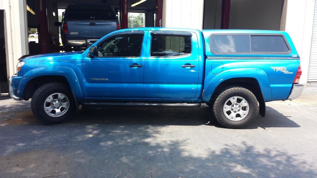

    cut mine tonight. i used tin snips and 120 grit sandpaper on a sanding block.
    if you measure from the middle of the bottom of the flap up to the truck the front mud flaps are 12" long and the rears are 10" long in stock form. at least on my 2009 that's how they are.
    i cut 7" off the fronts and 5" off the rears. this makes the fronts and rears 5" long. i have lifting springs on the front so my truck sits level.
    now they are both equal and much better looking and will not catch on curbs, speed bumps, or other off road obstacles. they were already scratched up a bit on the bottoms of the flaps front and rear from stuff i had scraped them on over the years.
    took about 10-15min per flap but i'm ocd about things. cut them off and sanded them smooth.
    the rears were a little harder to cut than the fronts.
    bottoms of the flaps are about 13"-14" off the ground after cutting them.
    the rears stick just below the level of the exhaust tip now.
    the bottoms of the flaps are about even with the bottom of the center caps of the wheels.
    i cut them basically in half.
    i'm very happy with the results.
