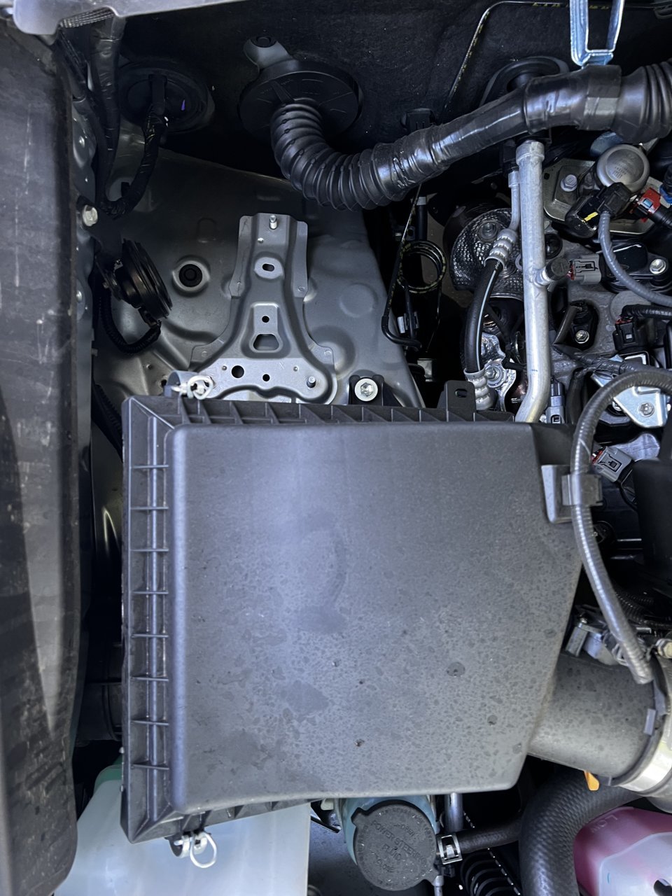

    FWIW, I don't think it's about CA emissions (M.O.R.E. has it wrong), but more about the brake setup. You should be good as long as that area doesn't have the standard ABS brake module. TRD Pro and Off-Road have the booster with the ABS module located on the Driver's side (the combination abs pump/master cylinder/brake booster is used for the crawl control feature).
    That area should look like this:

    Exactly what mine looks like (TRD OR). Awesome, thanks for the clarification.

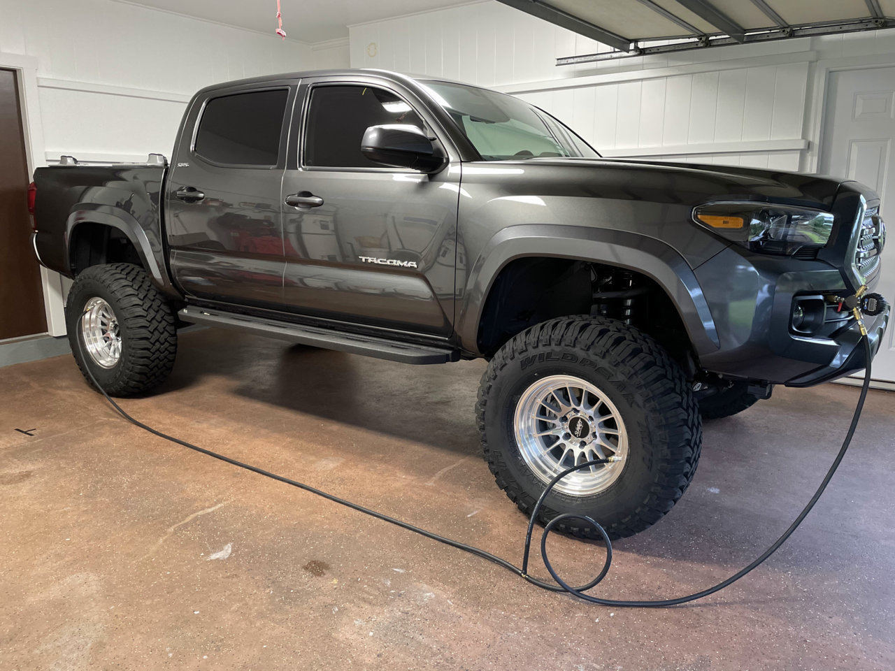

    I threw mine under the hood utilizing the second Gen SLEE mount by the power steering reservoir.
    Heat was a concern, but realized by the time the compressor has done its job on my 35s, I’ll be on the highway within minutes and that the airflow will help cool it down.
    I didn’t run it to the bed for same reasons OP mentioned.
    thought about the grille mount but didn’t want airflow interference to the radiator.
    i also ran my hardline to my front bumper. Easy access and I don’t have to pop my hood just to use the chuck to fill air on the trail
    photo attached when on its 1st dry run in the garage
