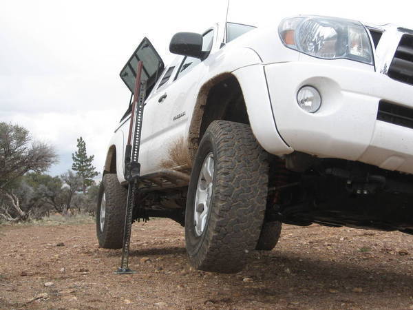

    Demello Bolt on sliders....
    yes the front tire is off the ground even though you can't actually see it in the pic.
