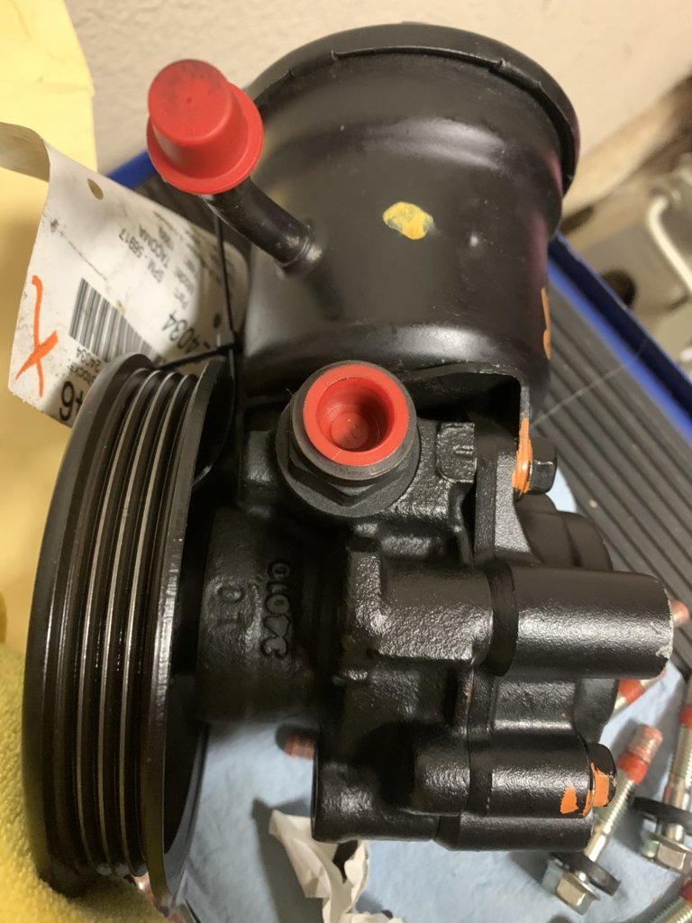

    Hello community,
    I recently purchased a used ps pump from a place that sells parts off wrecked vehicles. With oem ps pump discontinued, I couldn’t pull the trigger in aftermarket. I figured I’d roll the dice on junkyard option. The pulley attached is def oem since it has the part number etched but I am not sure about the rest. Can others, esp. those with more experience, chime
    in and see if this looks oem or remanufactured, or typical low-tier aftermarket? Thnks in advance.

    Oem unit but reman with Chinese parts through company like A1 Cardone etc

    Looks like they sold you a typical reman for some reason instead of a true used pump
    Strange but not that surprising. I'll bet oem pumps just arent lying around anymore. They've all been gobbled up by resellers and reman companies

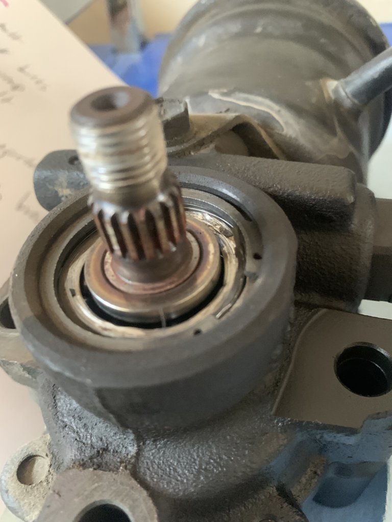

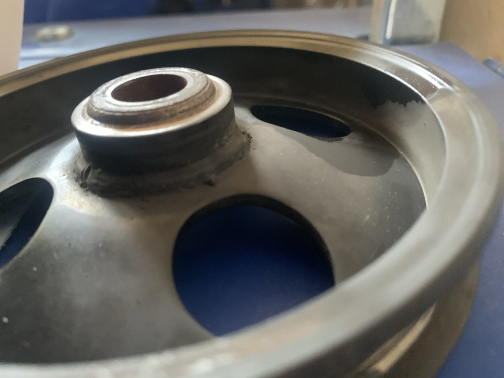

    Update:
    PS pump replaced. Now, what could possibly have caused this carnage on the pump that was removed? Looks like someone overtighten the pulley bolt? Input welcome.
    Background: This is a rebuilt engine that I did not touch until recently when I took it to a mechanic to have harmonic balancer replaced — on that one, the install was def done incorrectly (more on that in the future). The PS pump placed on my rebuilt engine was def not the same one I had on the original engine.
