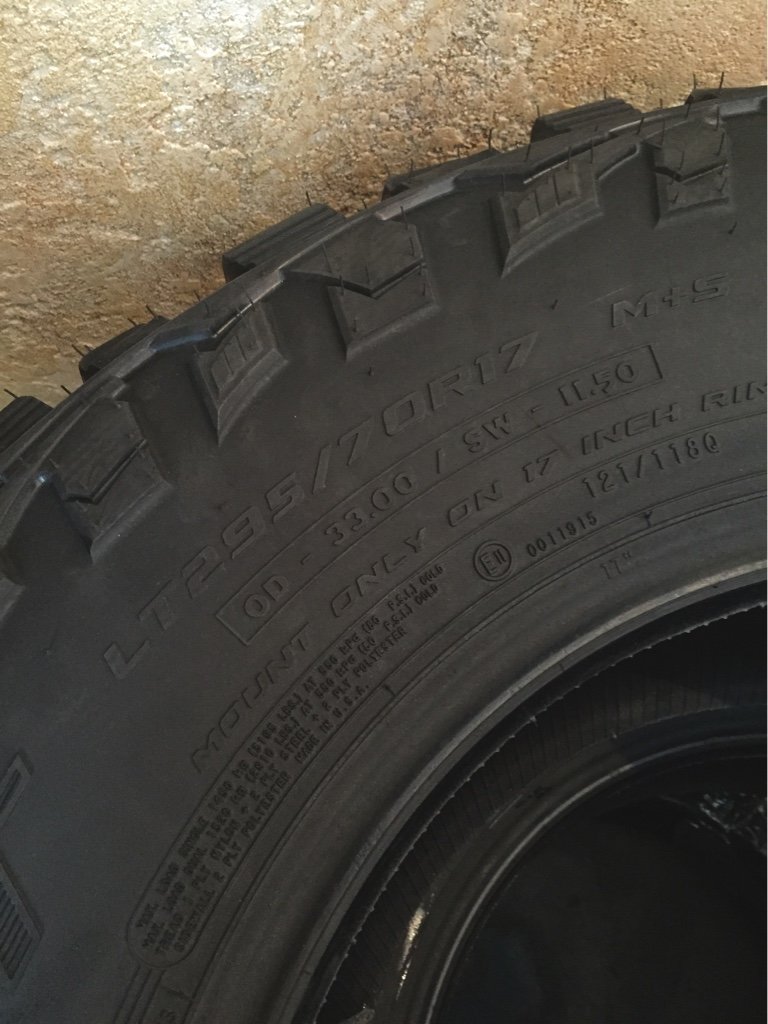

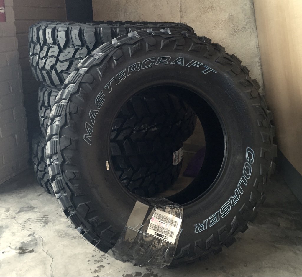

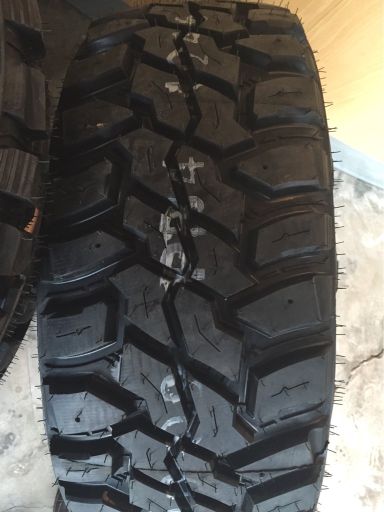

    New 33.5's!!! 295/70/17 mastercraft Courser MXT

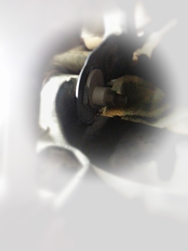

    Ok, i am in need of some help. Im having some funky sounds coming from my front end suspension items.
    Sound really started accuring after the gulches trip with some of you, i noticed it while on first parts of the trail where my suspension was cycling pretty heavily from side to side.
    Since then ive been hearing the sound while hitting a water runoff dip in my neighborhood while turning, this morning i put a GoPro just above the cab mount and drove straight over the water runoff dip and then turned around and repeated 3 times.
    Sounds are at
    :10 seconds
    1:22 seconds
    1:49 seconds
    2:16 seconds
    Anyone with insight its greatly appreciated!!

    Are those BAMF LCA skids?
    Look at the bottom of the mount for the front pivot of the LCA (where you adjust the cam bolts for alingment) and see if the LCA skid has been contacting there.
    It may have made a notch and bent the metal there if it's anything like mine.
    Kind of hard to take a picture of... but maybe you can see what I'm talking about

    Thanks for checking out the video eric, Gramps and i looked all over and he actually brought up your BAMF LCA skids contacting your IFS skid but it seems mine were already notched and no metal to metal rub points on mine. BUMMER wish it was that easy :D
    You can cleanly see that my LCA BAMF skids have plenty of clearance room between them and the IFS on the video, i reallly wish this was the noise though.

    It's not contacting the IFS skid.
    It's contacting the truck.
    Specifically, where the front cam bolt is.
