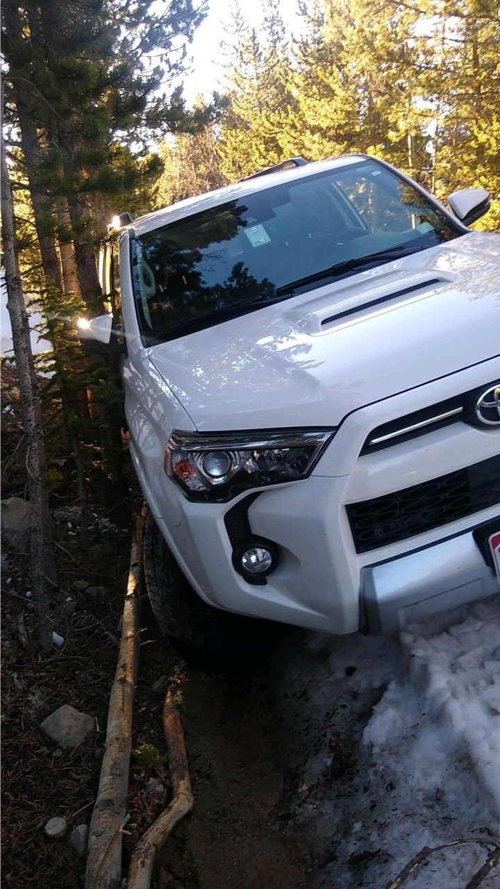

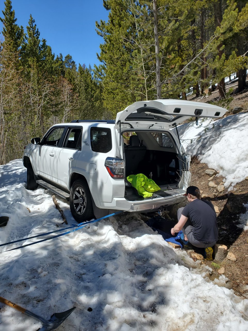

    Then, a friend asked if I could help pull him out of the road to Loch Lamond in a rental 4runner. At the time, the road had +1ft of snow on one side that sloped down to dirt against the uphill trees. He'd tried to back up in the dark and got too close to the edge and nearly slid into a tree. Pics below. Fully spec'd TRD Pro runner too, just had summer road tires. It took most of the day to cut down a few trees to get him out, and winch him back into the ruts, and deal with the way slippery-er snow than when he'd gotten stuck... but in the process I got too close to a tree I thought I would clear and instead it just took my whole passenger mirror off. Snapped the metal hinge that controls the folding mechanism.

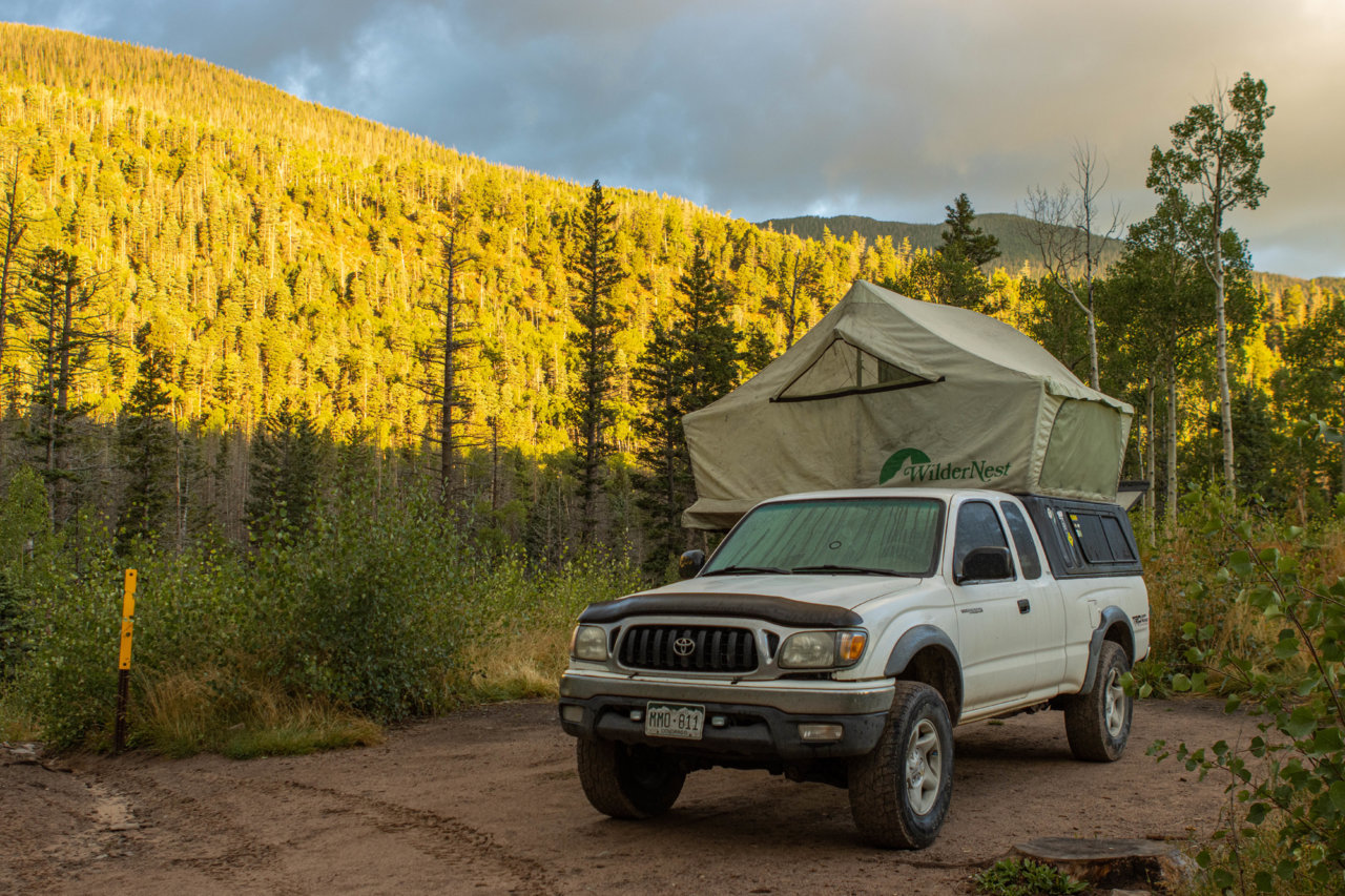

    The only other big change was picking up a Wildernest in pretty shit shape from a guy on Craigslist, $650. One of the main metal supports is very rusted through, and the back frame is bowed out so the side locking tabs don't work. There's a few tears in the fabric, and there a number of patches where the waterproof coating has failed. If you guys know what fabric the Wildernest's are made of, or what kind of treatment this fabric needs, that would be greatly appreciated.

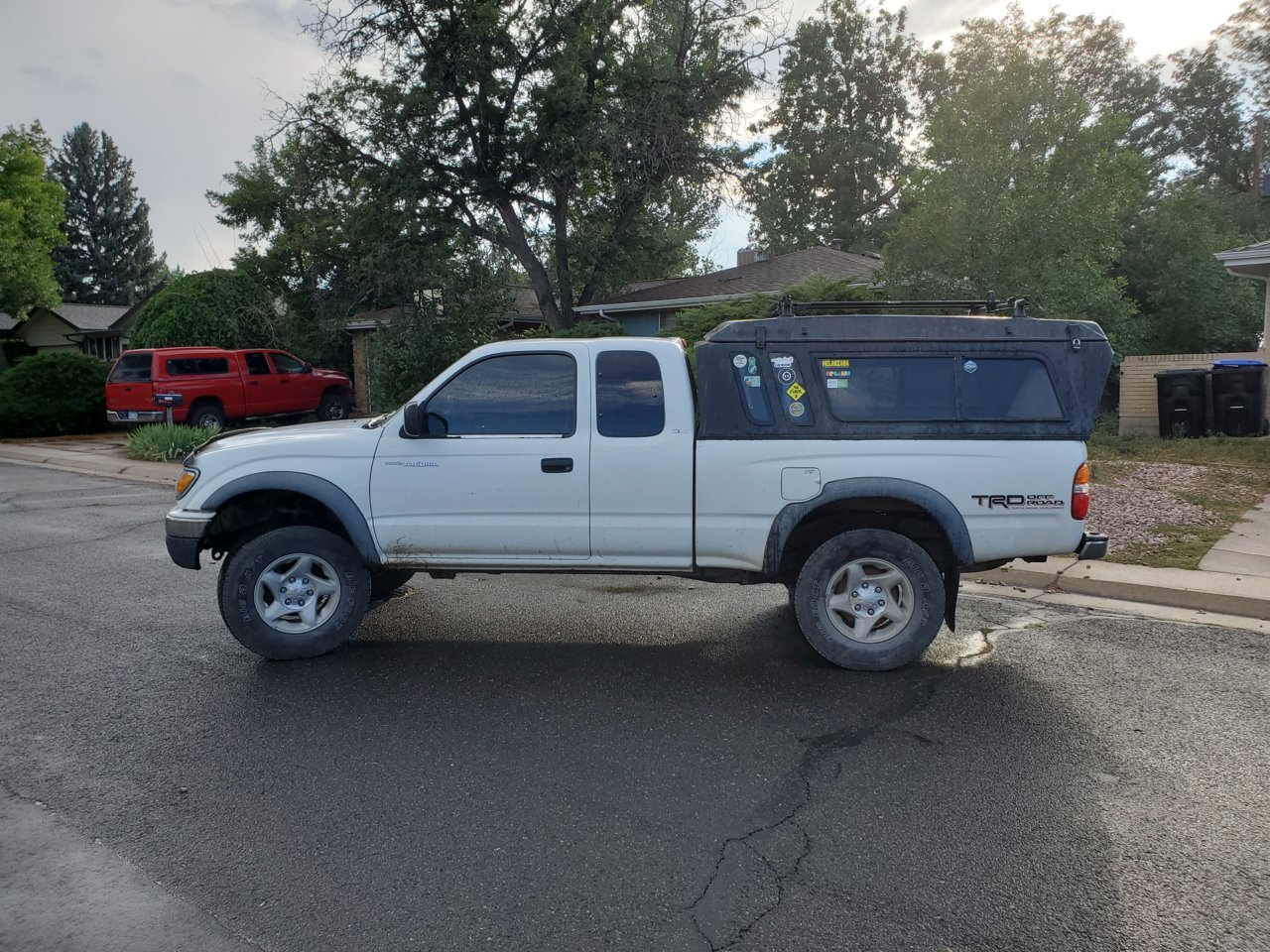

    So it's been a couple months with the topper, and I love it. The ability to camp anywhere I park the truckand not have to set up a ground tent is so worth having to take it down to go anywhere. Love the look of it too.
    However, these 20 year old leaf springs just weren't up to hauling 300lbs of camper and another 200lbs of stuff around, and the rear bumper was sitting 2" lower than stock unloaded height. It was kinda annoying to not be able to see over the hood, and it handled like a boat, especially cornering. I ended up getting the Icon add-a-leaf 1.5-2" lift from Slee Offroad in Golden, CO and installed it myself. Took about 6 hours and honestly wasn't that hard. I didn't have to remove the factory spring clips, which would've added a lot of angle grinding. The worst part was removing the centering pins, they're under the bump stops which seem to just trap water and corrode tf out of the pins. I think they started life as 14mm nuts, but I had to pound sockets onto both sides, one took a 13mm socket and the other 12mm after I scraped all the rust flake away. Hit all the springs with a silicon lubricant before reassembling the stack, and now she rides really nice. Much firmer in the back, but better over large bumps as there's enough travel to not hit the stop.
