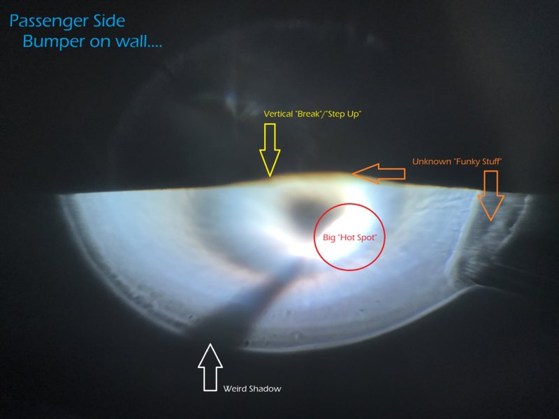

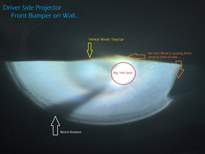

    I received them as a gift....please don't pummel me....I will run them long enough to show appreciation for this thoughtfulness no reason to go wrecking anyone's feelings...they do look kinda cool....
    Now that we have that out of the way, I took some pictures after installing and while attempting to adjust for optimum output. (See Attached)
    With my nose on the wall there is a hot spot down and to the right, from a driving position it feels like I should be driving on the left side of the road.
    I think something is not right here, but I followed the directions for achieving the the correct height etc. offered in these forums, they just feel "off" appreciate any thoughts on the matter.
    I kinda feel like throwing away the book and just tweaking them till I feel they are right, but that's a great way to go chasing bunny rabbits in the dark too.....

    Attempting to adjust for optimum output? Beam output is not adjustable. Headlights should have zero adjustability other than tilt/angle of the entire lens assembly which does not affect beam pattern as the headlight is moved with the light source.
    To me this looks like one of those complete hack "freely rotate the directional LED in the precision engineered omidirectional halogen housing to make the beam less bad" lights. If that is true, the hot spot is because the beam is rotated when it should not be. The 'weird shadow' is because LED light is directional, it is only pointing 2 directions which means above and below those directions will be shadows, halogen points in all directions.
    I've seen it too, in person. Usually it the practice goes by the user not being happy with the light output so they shim the bulb base upward, to tilt the bulb tip downward in the projector to uncover more of the bulb from behind the projector cut off shield to attempt a brighter beam. This is a complete hack and not a practice I would recommended. Not to mention, shims tend to fall out, melt or otherwise go wrong. Also this practice is more often around getting more out of omidirectional halogen/HID sources than trying to fix hot spots by LED.
