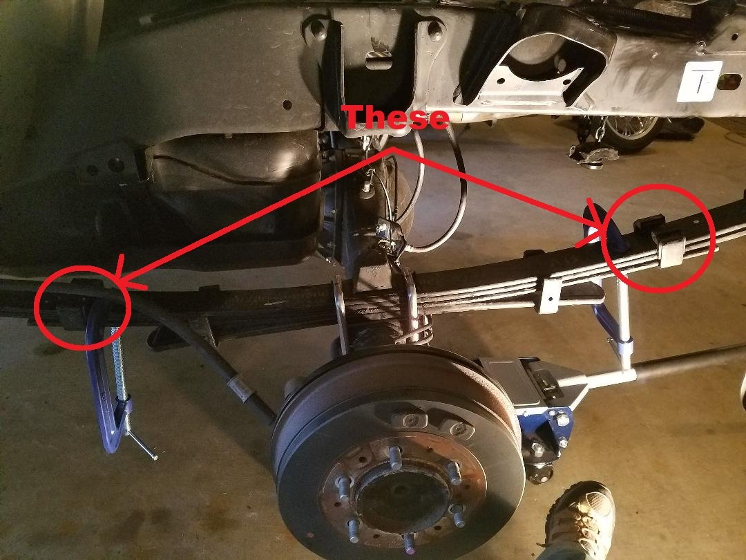

    Well ladies and gents, ai will be installing my suspension today...Will take measurements and pics!
    I still need to figure out my AAL situation...
    To those that purchased an AAL, which leaf are the spring retainers mounted on to?

    Yes

    On the HS kit the retainers are on the 3rd leaf.

    Thank you! It appears the icons are on the longest, and second longest...the second longest will be riding on the OL...guess I’ll have to order a headstrong leaf.

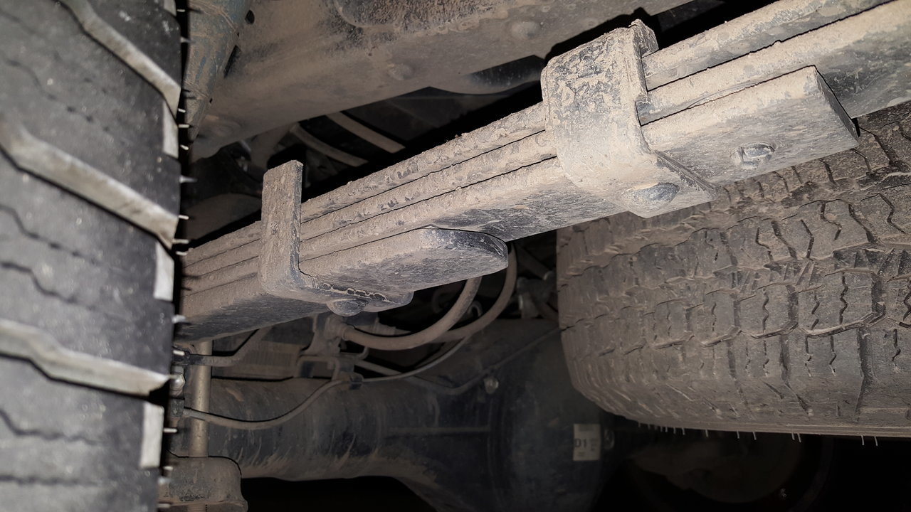

    That' what they look like with nothing in the bed at 55k never towed anything with it and the heaiest load I ever put there is my kayak to go fish maybe like 10 times max!
    Dealer seem to thing is normal and the constant squeaking they said is due for using my truck like a truck and the leafs a little dirty! They charged me 60$ to diagnose and come up with this conclusion

    Sounds like it is time to find a new place to take your truck

    Yeih looks like it! Ima give the manager a chance to fix this on Monday cuz I already drive an hour to a diffeent town! the ones near by are terrible

    Yup I looked at all the new ones on the lot and as they were not touching there was not much of an arc there!

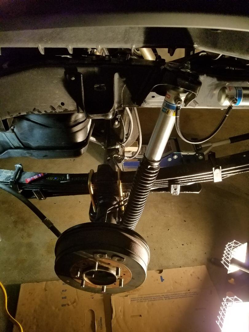

    Final Install Pictures
    Headstrong 3 Leaf progressive with NO overload
    Post-lift measurements after settling:
    Front Driver: 37.0 in
    Front Passenger: 37.0 in
    Rear Driver: 37.5 in
    Rear Passenger: 37.5 in
    0.5 inches of rake.
