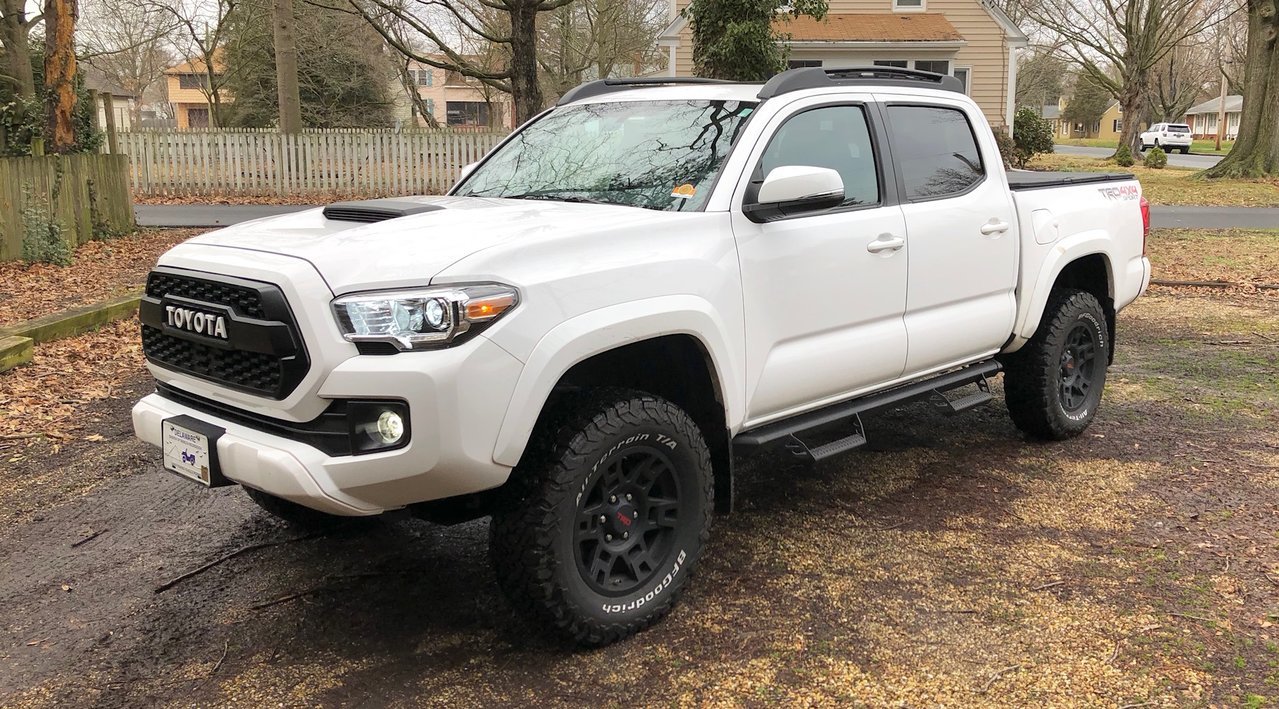

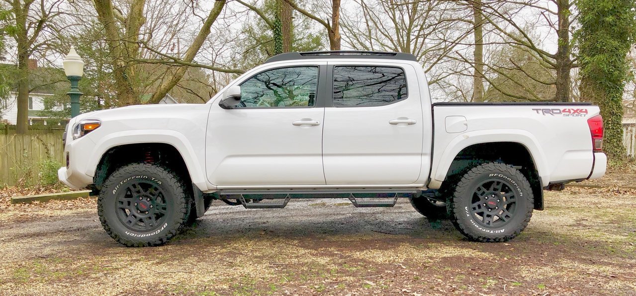

    Did you take pre lift numbers down?

    Which AAL you guys installing? Ive heard the Icon's start sagging. Also, I dont like the idea of removing the overload just incase I want to tow or haul something heavy later on. Any recommendations on what AAL to go with? Do I remove or leave the overload? My biggest concern is resale. Its easier to sell or trade in the truck that has all OEM Toyota parts and not any aftermarket parts.

    Headstrong 3-leaf progressive AAL. You can leave the OL in if you don't mind a little more rake.

    I have the same AAL on the way...keep going back and forth on whether to install with the OL. 1 1/2 rake wouldn't be to much...wonder if both front and back will settle. Post some numbers after you put some miles on it. With your current number think maybe the OL would have made your rake about 1.5 maybe?

    Toyota designed the rear springs to be in negative arch.

    Tire size?

    TIM

    Wow, those look A LOT bigger than I thought they were. I have been thinking of some 255/85s for a while now, but those do look pretty great.
