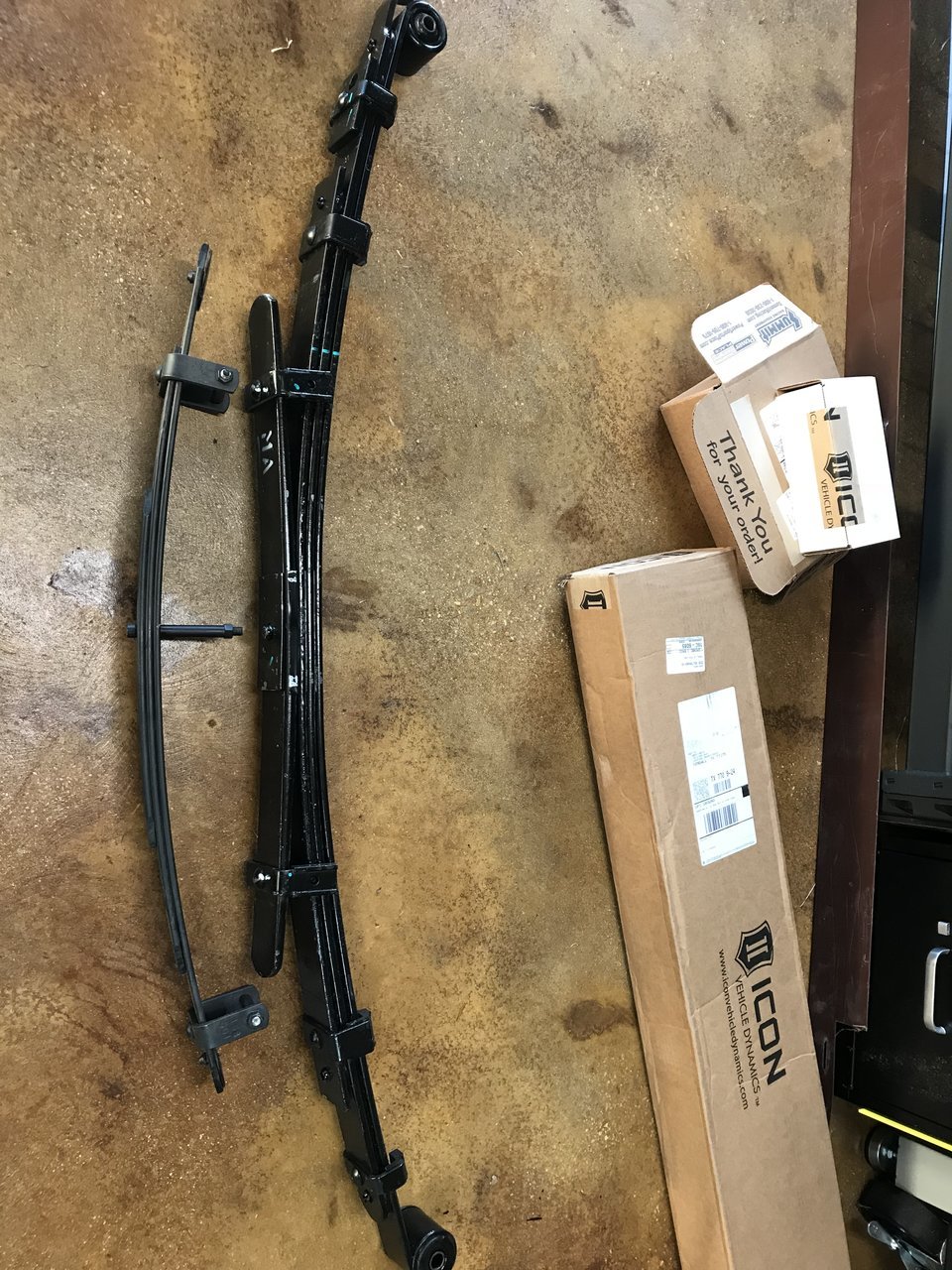

    There are different packs...there is a pack with both retainers on the longest leaf...and other packs with a retainer on the longest in rear and second longest on front. If you keep the OL in...the front retainer/rivet on the second longest spring will be riding on the OL.
    First stock picture is the clamps on both long sides...I got an Icon AAL Mfg 1/2018 that has the clip on the second longest as well.
    I installed tonight and just cut the front most AAL retainer and rivet off. The OL retainer should keep leaves aligned.

    You can drill out the rivet and just bend it off...the rivers are daily soft steel.
