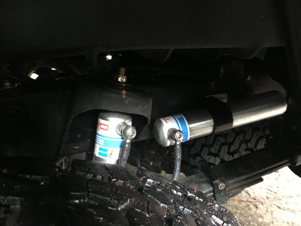

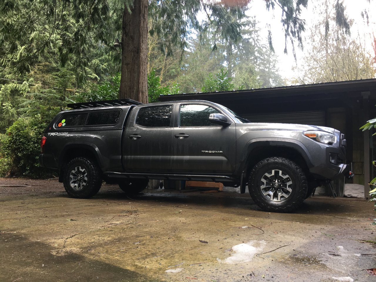

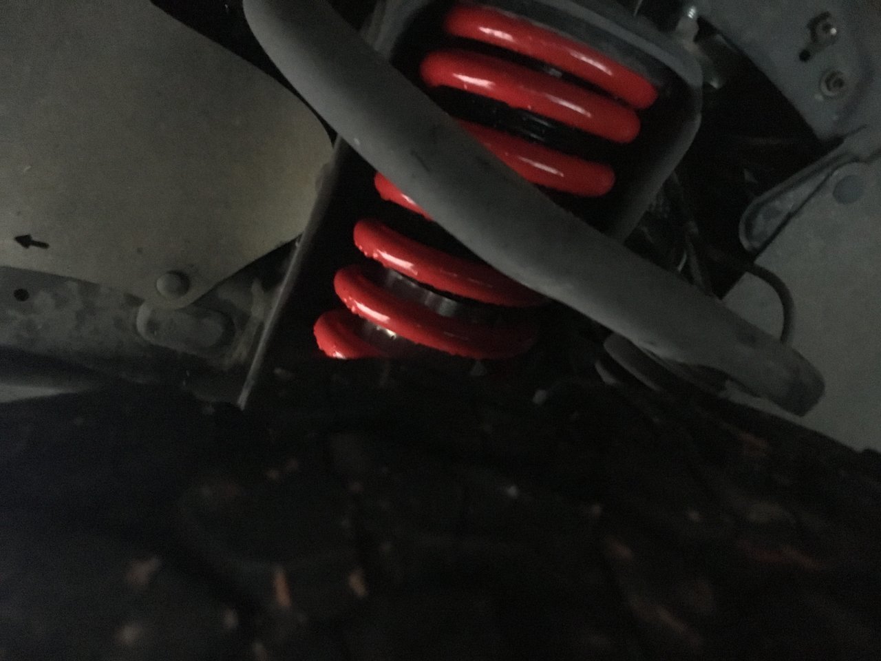

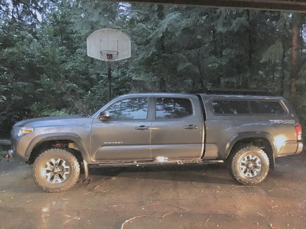

    Had mine installed Tuesday along with an ICON AAL.
    What an improvement in ride quality and dampening!
    With my SSo Bumper, Winch, Sliders, and Cap, my stock OR suspension was really suffering.
    Prior to installation up front I was sitting at 34.3/4” and 34.7/8” .
    Now I’m at 36” and 36.1/8”
    Out back I was previously running Hellwig Helper springs and was sitting at approxamently 36”
    We removed the Hellwig springs, the stock overload springs and installed the AAL and now I am sitting at 37”
    The Hellwig springs were giving me about a half inch lift over stock.
    (Edit: After three days of driving and some settling.
    Hub to Fender Measurments
    Drivers LF 21-1/4 Passenger LF 21-1/2
    Driver LR 22-1/2 Passenger RR 22-1/2)
