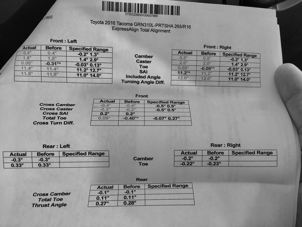

    I’m running 265/75/R16s
    Here is a pic of my alignment specs:

    Thanks Ben!

    So is the actual the after #? All they had to adjust is the toe? How were your #'s the same camber and caster after lift?

    Both numbers are after the lift...
    The "after" is after alignment the "before" is before alignment not before lift.
    I don't have the pre-lift alignment numbers, kinda wish i went in and got them though just for reference :)
