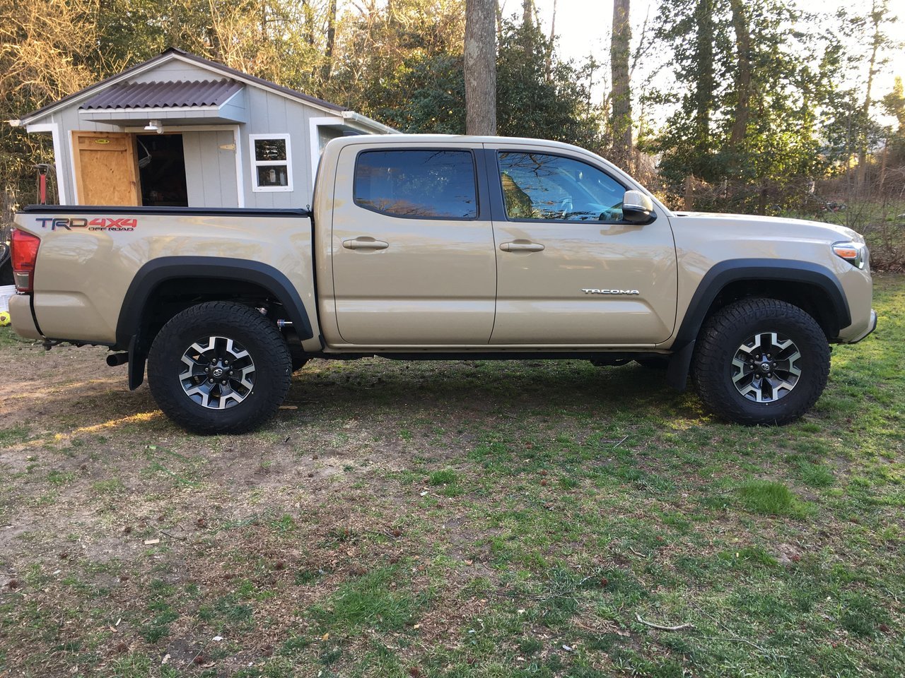

    Got a few hours a free time today and did only the rears. AAL’s still haven’t showed up so I’ll do those later along with the fronts and ECGS bushing.
    I also wanted to test out how the ride feels with only the rear shocks in, got some rake back...haha
    I will take a drive tomorrow to see how much they settle and how the ride feels.

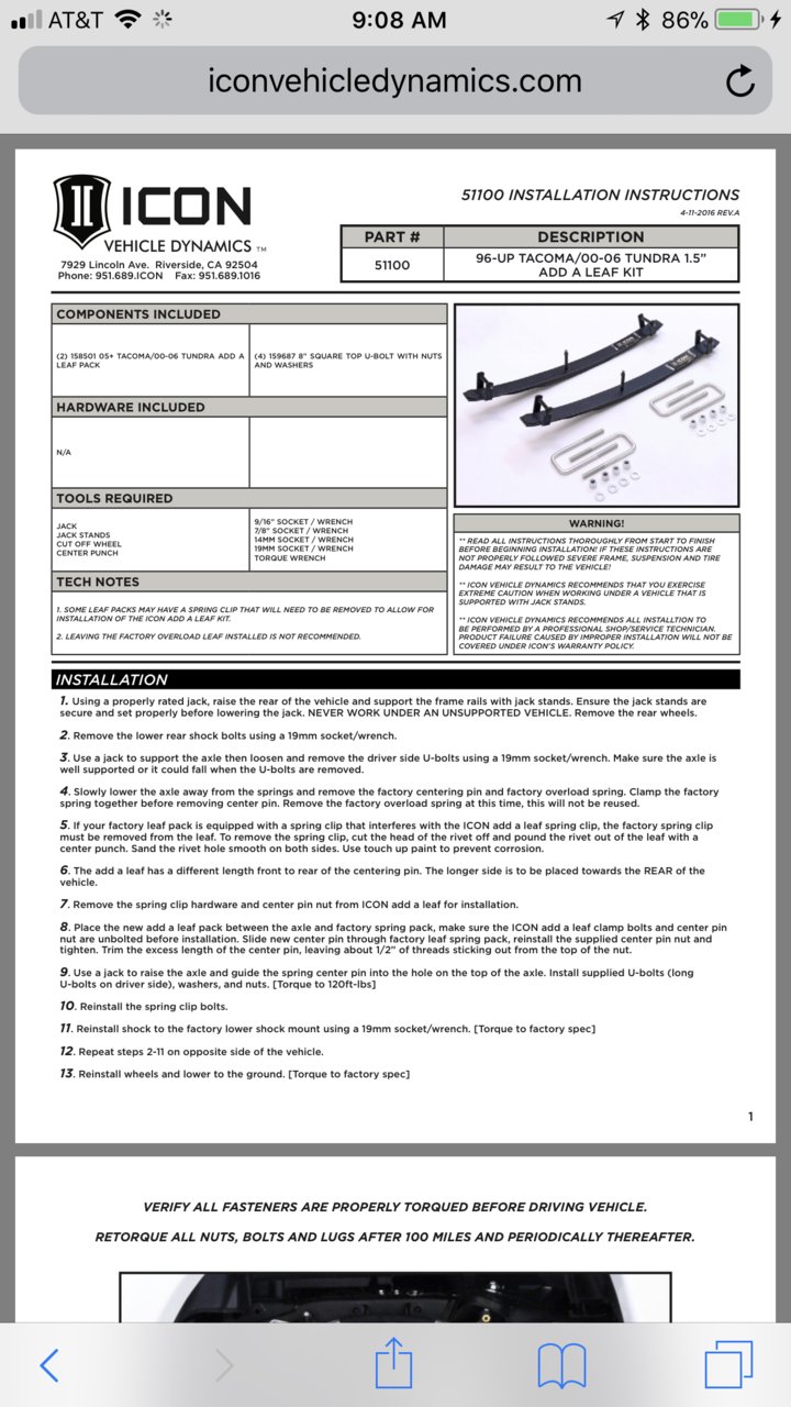

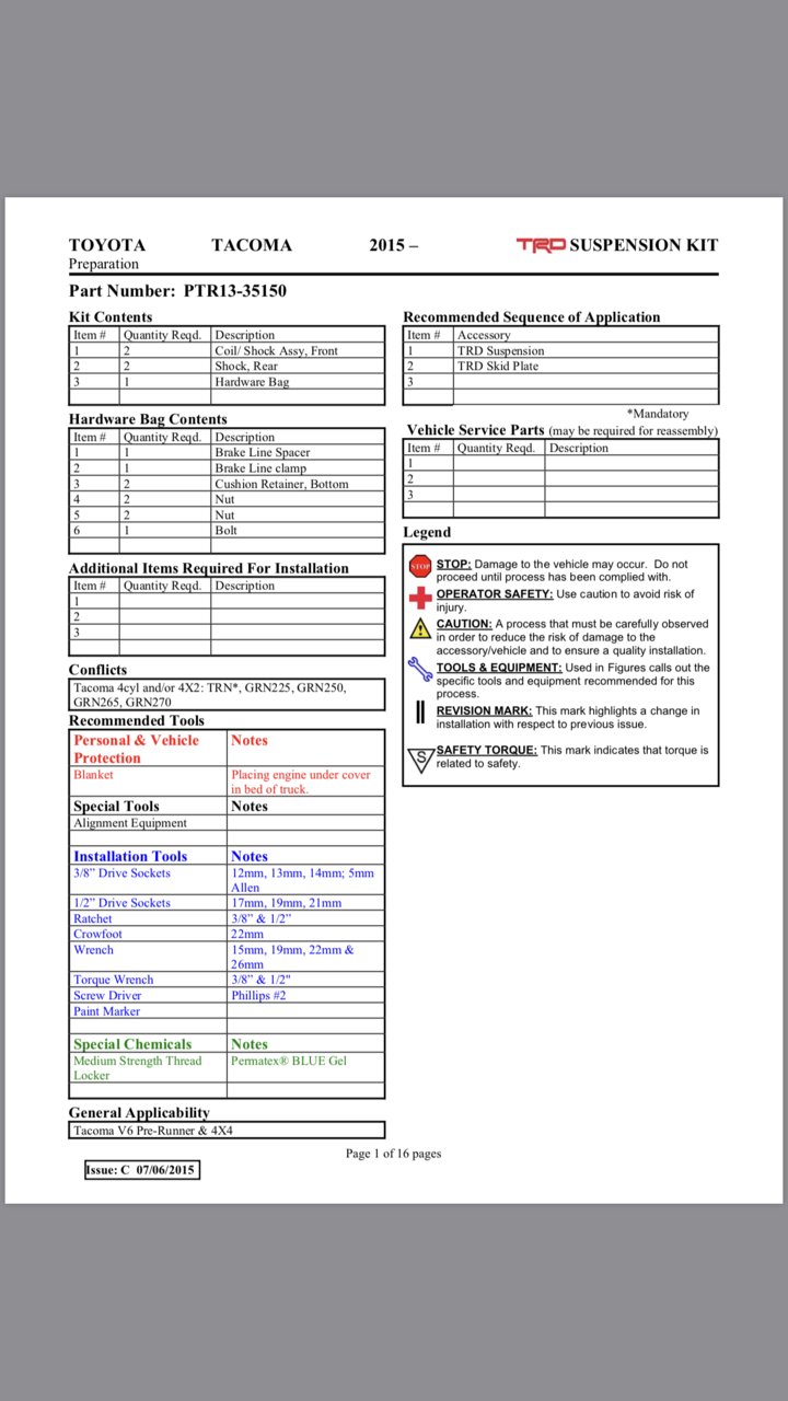

    Do you have all 16 pages of this?

    Here you go

    Why is the re-use of the overload spring not recommended?

    I've wondered the same thing. Many do use the OL. But apparently they're designed to be used without it. Makes me wonder if there is a compromise (other than harsher ride).

    I used mine with the HS AAL and have no problems. I think it may have something to do with the Icon spring retainers and OEM OL retainers.

    My take is because instructions call it a 1.5 inch lift. The OL will add another 0.5 inches to be at 2 inches total.
