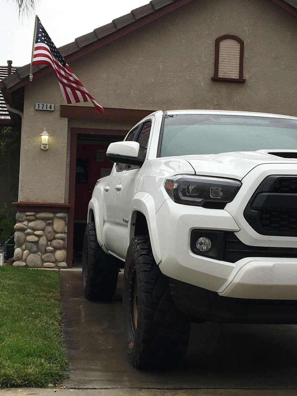

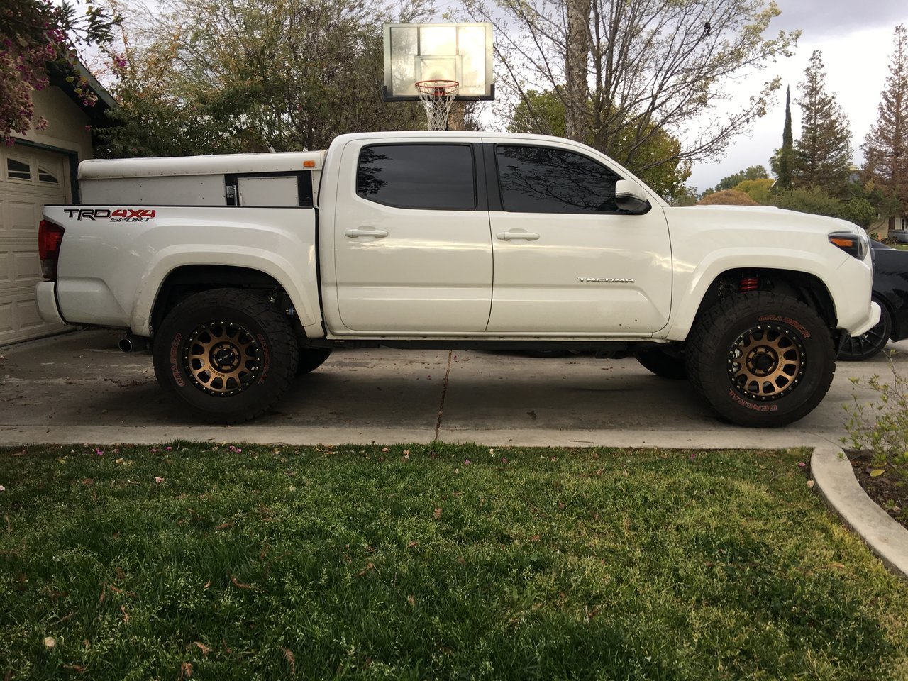

    Installed yesterday on 33x12.5 17x8 method nvs. Still need to get alignment. Had the cab mount chop done Friday and the only rub is on the front sport lip, which I trimmed. No aal installed, I’m ok way bro lean for now being I’m a Brotaco lol

    Can you put a side or angle pic , looks good . General tire red ???

    Oh there will be some mods all right
    I love those tires so much!
